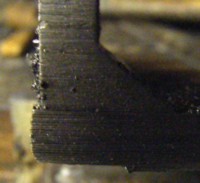

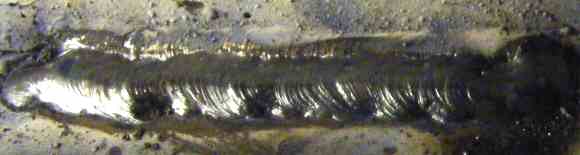

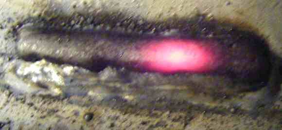

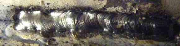

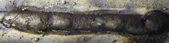

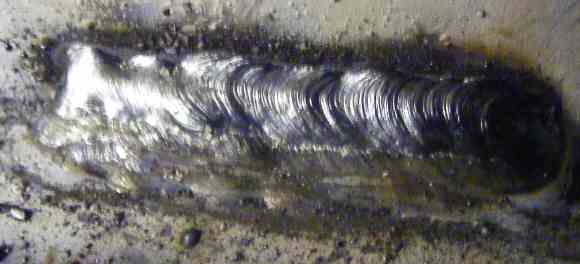

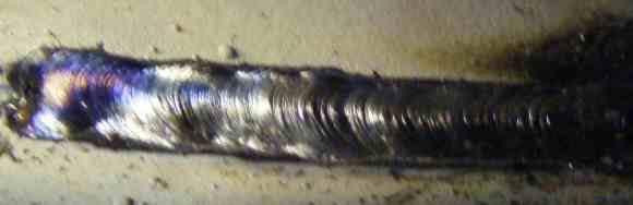

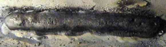

Got a small one have you, need a larger one to get that extra penetration. Well it isnt true. All these welds were done using 80amps on a 2.5mm 6013 BOC everyday rod, on 8mm plate. normally the pro's would run a nice 4mm rod and get 6mm fillet. So what happends if you have got a cheap and cheerful welder that only runs at 80amps.

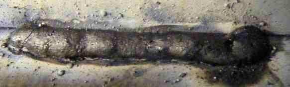

its relatively simple, you start by doing a root run (tight into the corner), then you do a second run, half on the root weld and half on the flat of the bar, then another run against the root but this time on the vertical side of the bar. you keep repeating until you get the desired size fillet.

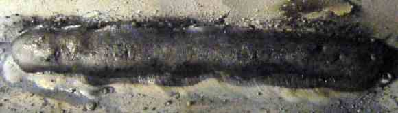

The last pic shows the end result with around an 8mm fillet built up in layers. Although the photo isnt that clear, it is one solid weld. it was cut through the middle of the weld there are no visable layers or joins (xray might tell a different story
Its a slow method of doing it, but if your stuck with a smaller machine it works, perfectly well.
). Its a slow method of doing it, but if your stuck with a smaller machine it works, perfectly well.
For a small weave it's easy to keep nice straight edges to the weld but if I get ambitious and go for a larger one I end up with a regular wavy edge. TBH, I was playing around really but it got me thinking. I was using a 3mm rod but I was probably attempting a weave of 15mm so sounds like I was over-stretching myself!
