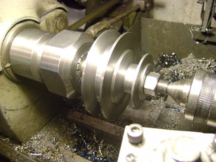

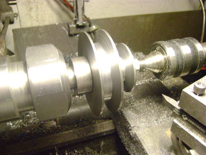

Here is a little vid of a 1/4" wide groove being cut 1/2" deep into a steel pulley blank. Just a plain jane HSS tool bit running on center and the lathe is in back gear. The cross slide gibs are just snugged a little too...Bob
