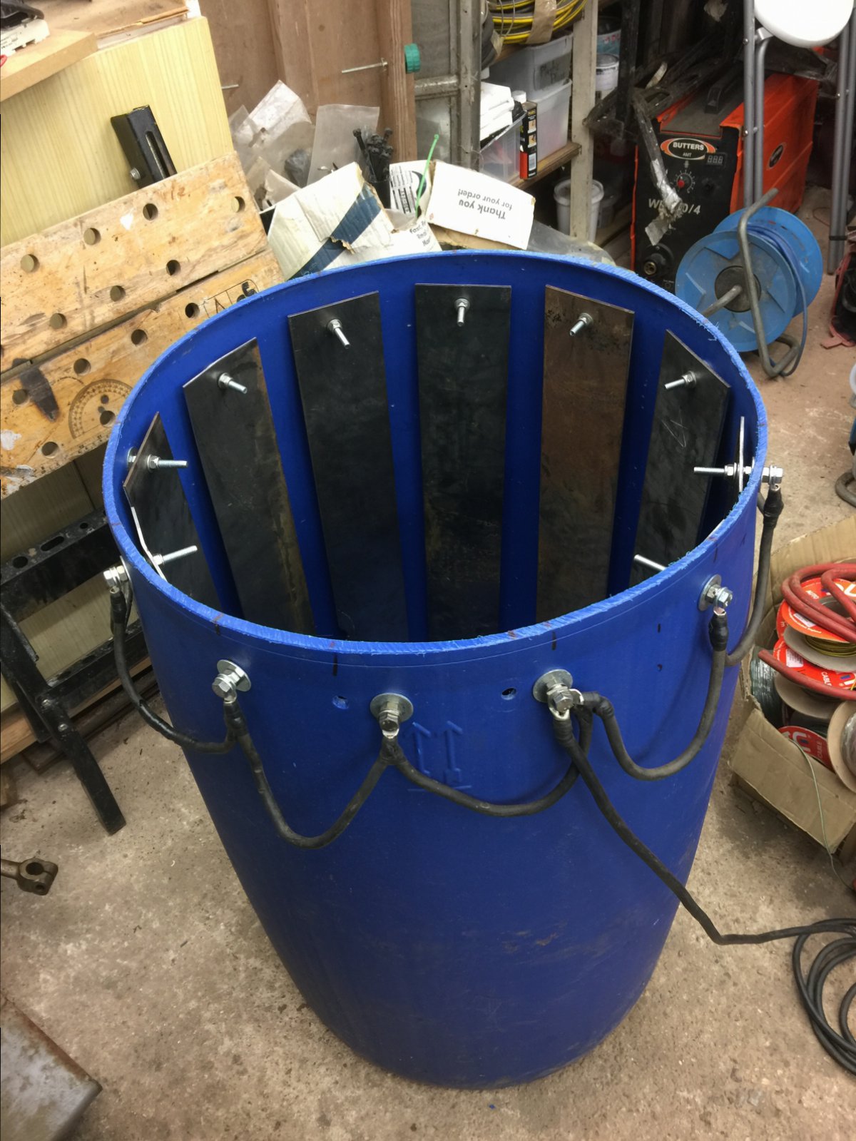

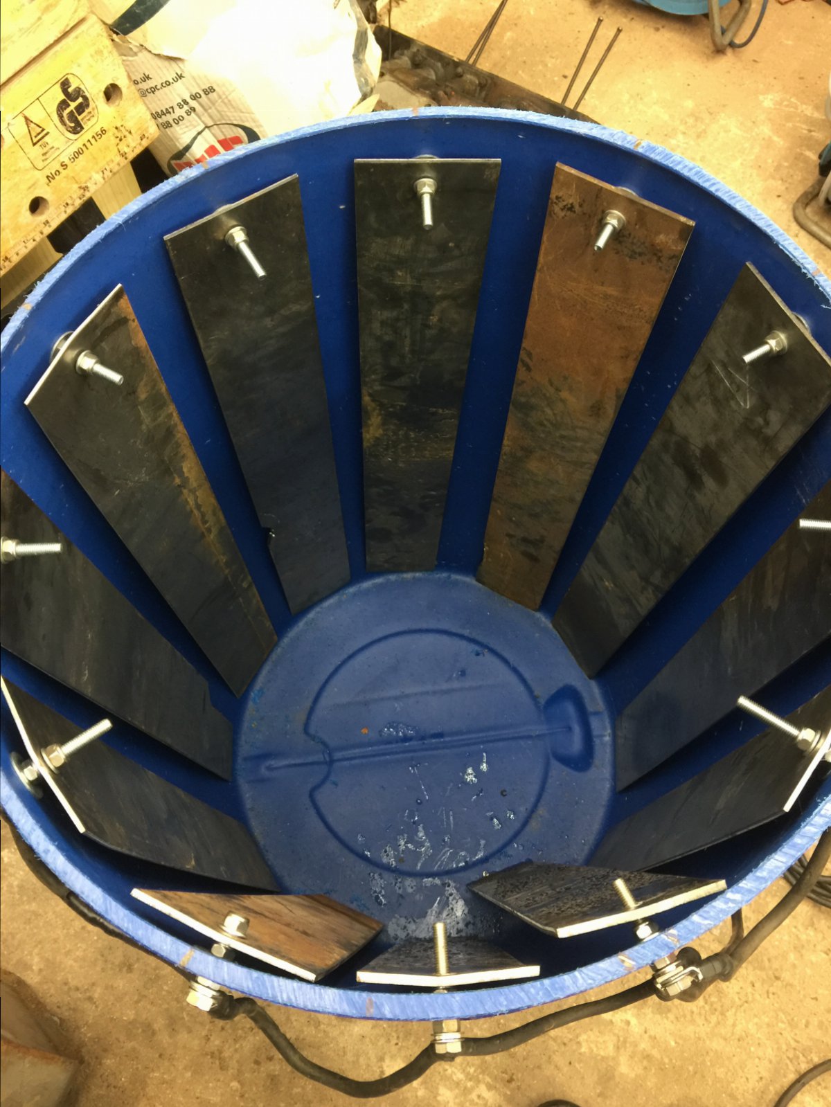

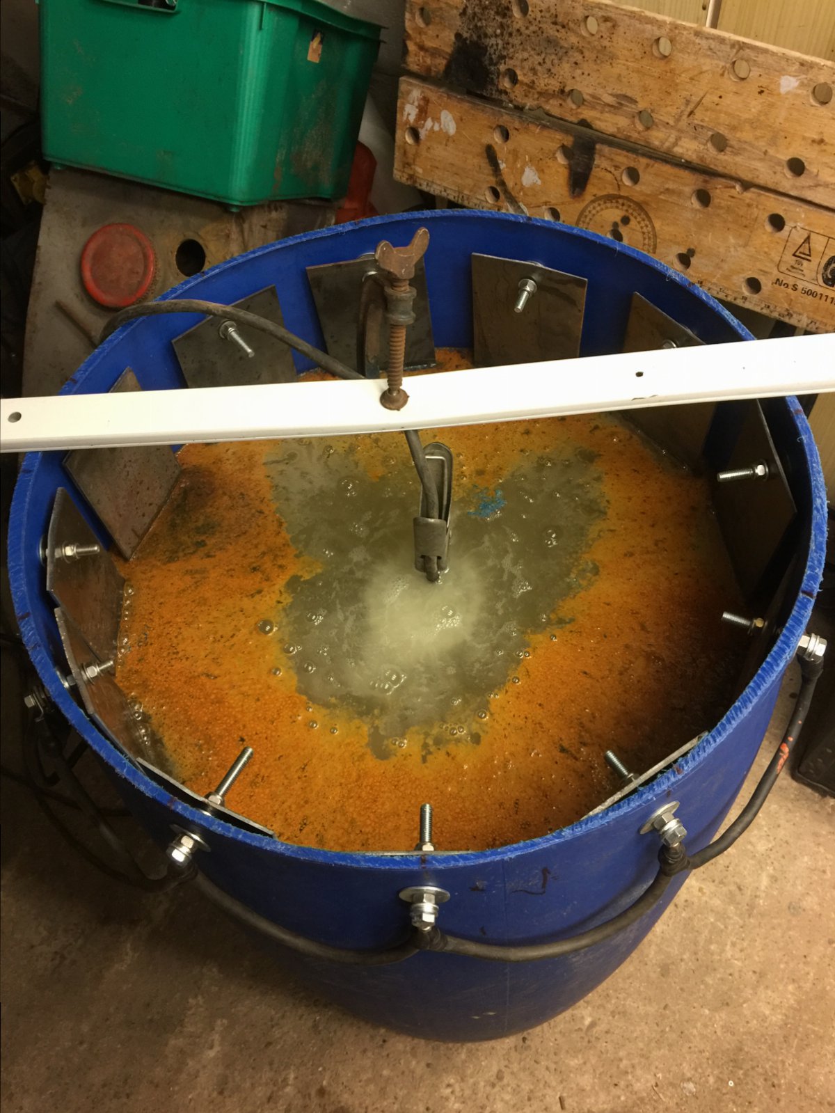

So a bath was made 205ltr drum that was for adblue in its previous life volunteered itself for the job, then ventured into the badlands behind the hill items at work and liberated some scrap sheet and cut it into 100x800 mm ish strips with an 11mm hole punched roughly on the centreline and 25-30mm down from the top, plates secured to barrel by m8 bolt that also provides electrical connection.

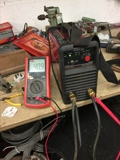

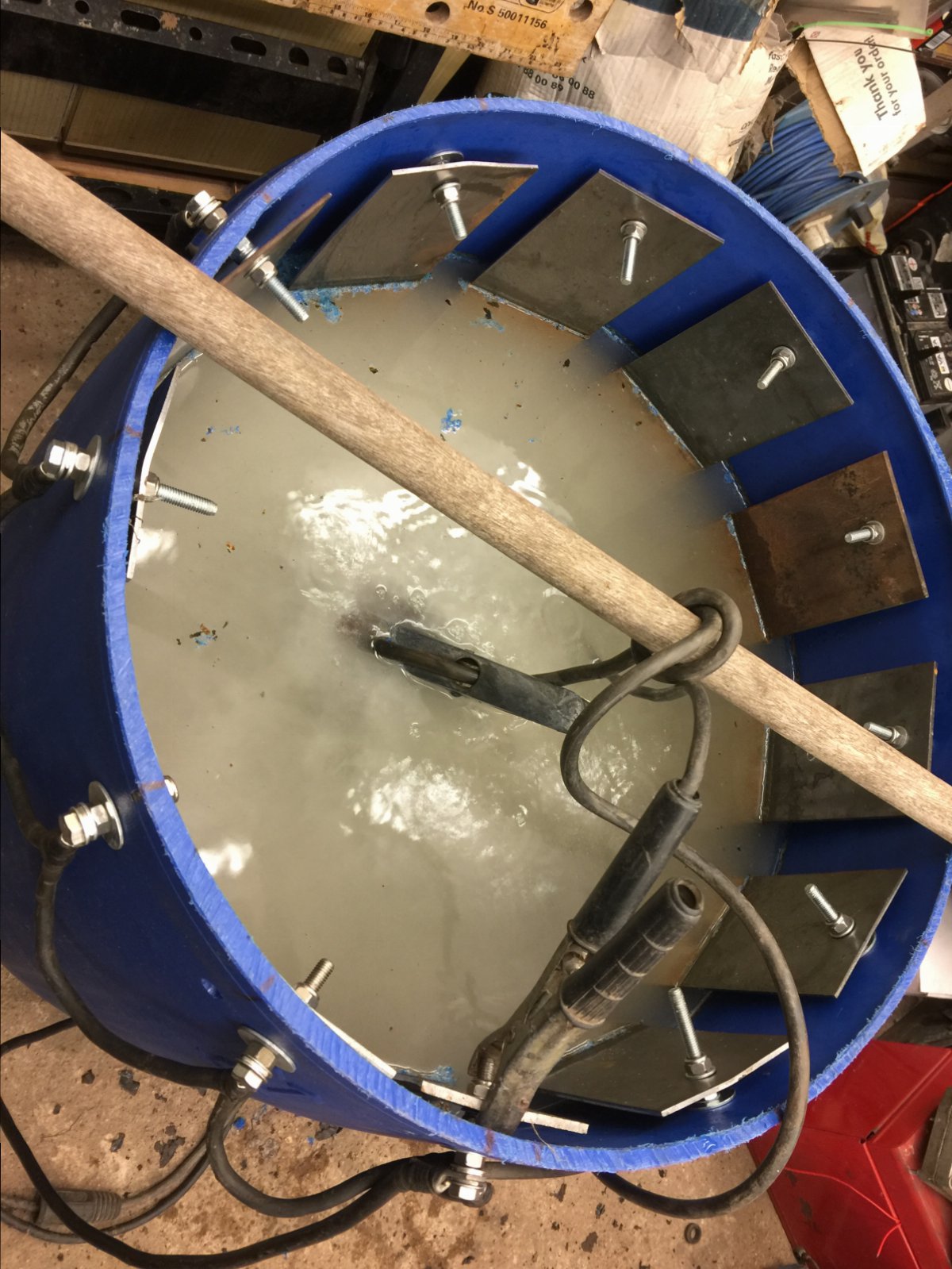

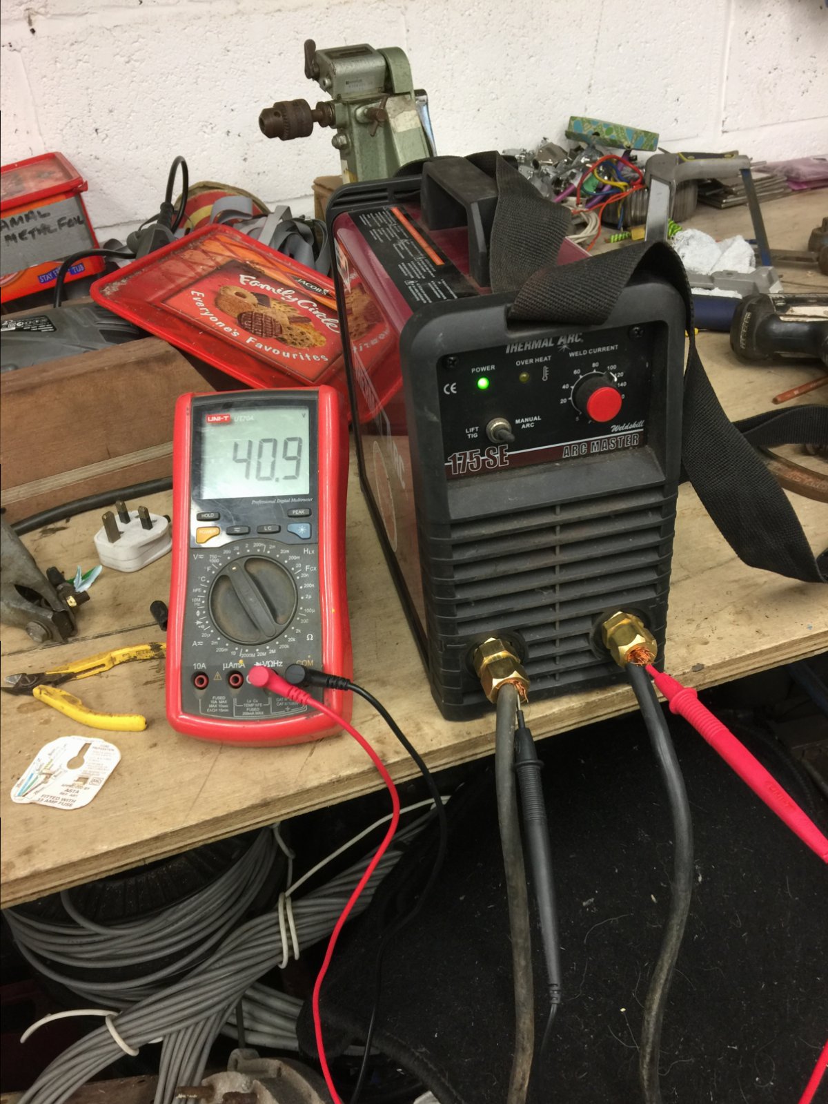

So filled it up and added 2kg of washing soda, hooked it up to some power and turned it on
