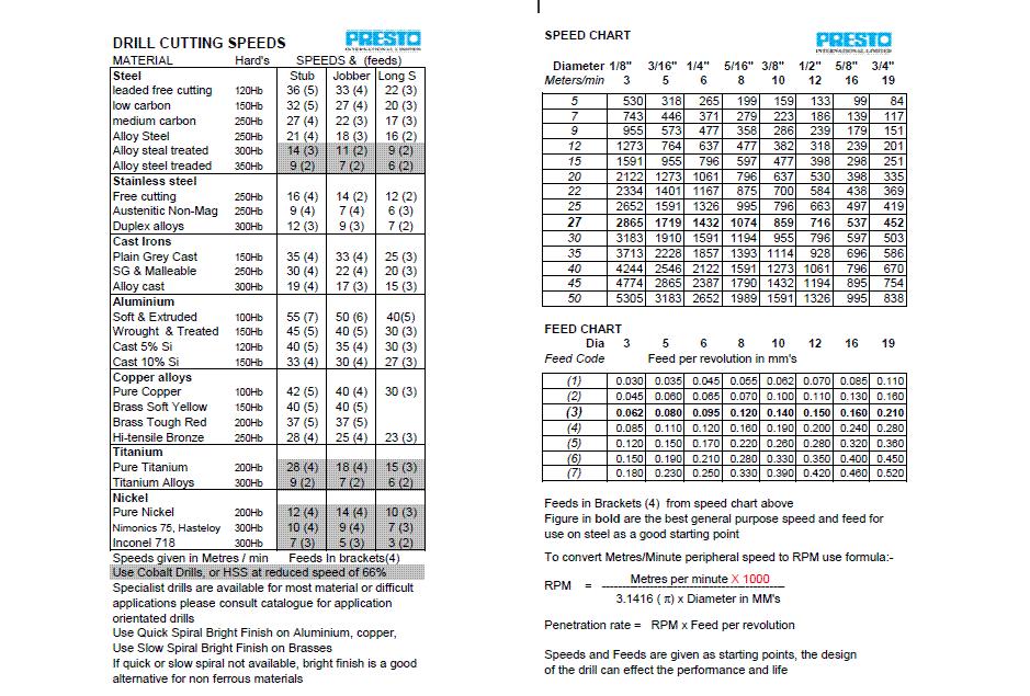

Hi everyone.
Just a post to see what techniques you guys use to drill large holes in thick metal.sometimes we get jobs to do that require the use of a hand drill because we can't get the object the the pillar drill or have limited room.I do a lot of hand drilling in metals of different thickness. I centre punch .and make a pilot hole .then work my way up in 0.5 increasments up to 13mm using cutting fluid. But there are common problems. Like the drill bits snatching and drill chatter as the sizes increase. What's tools and methods do you guys use.finding a drill with hight end torque at low rpm is difficult. What size hole is practical with hand drilling.is there different drill bits to prevent the sudden snatch.
