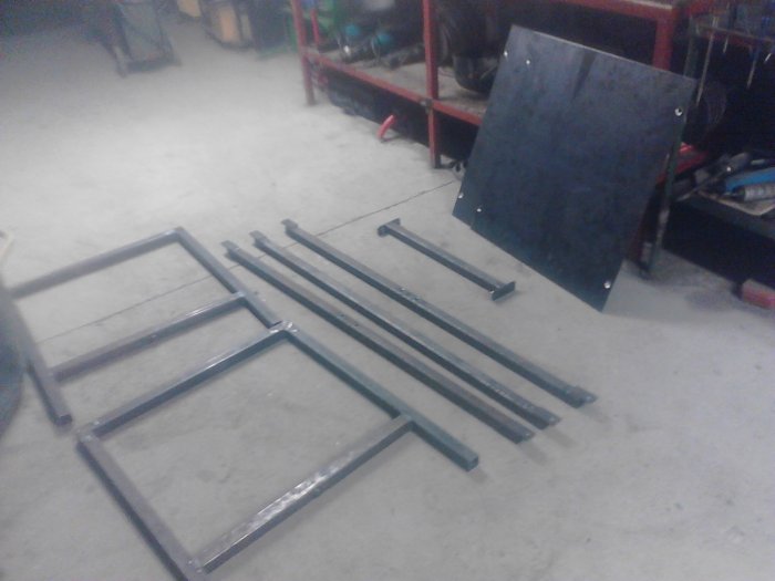

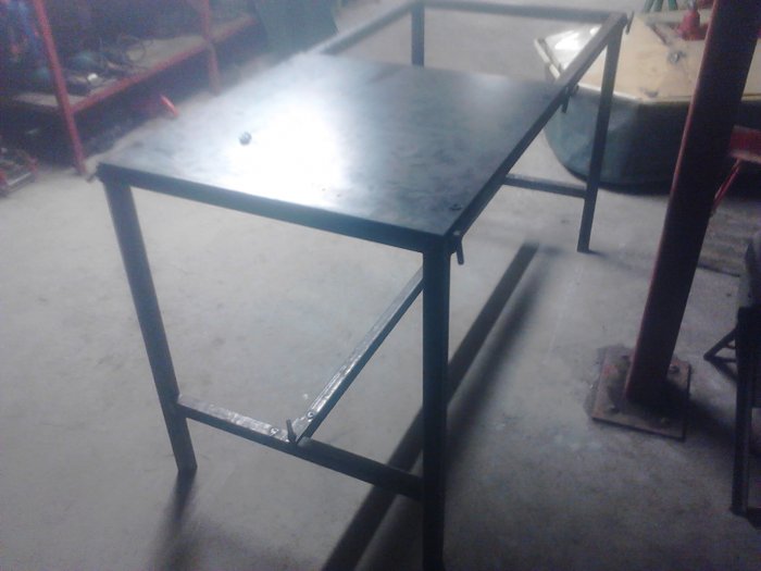

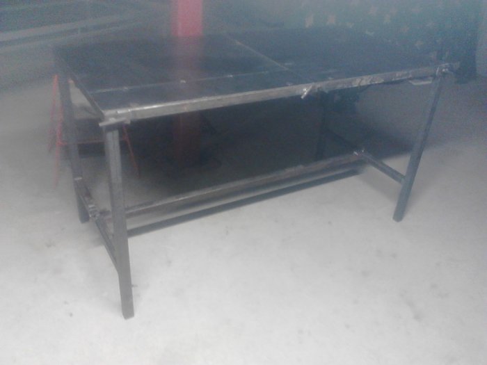

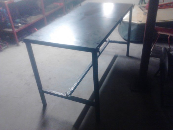

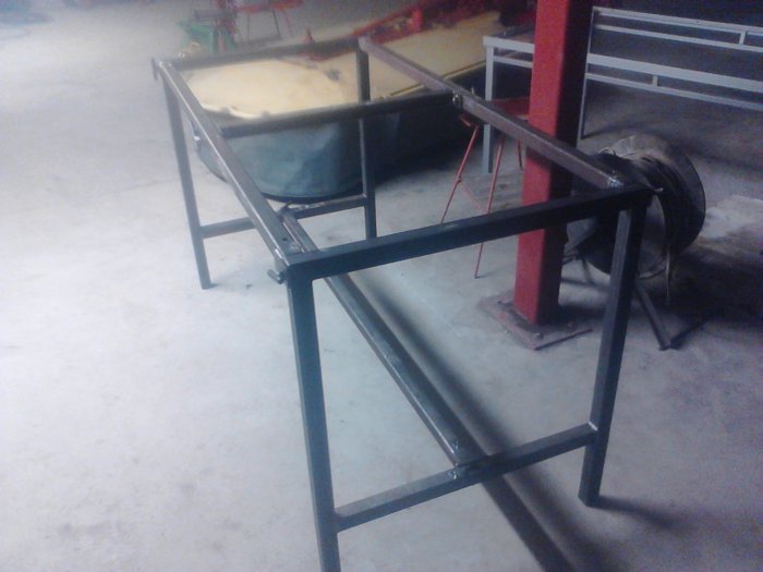

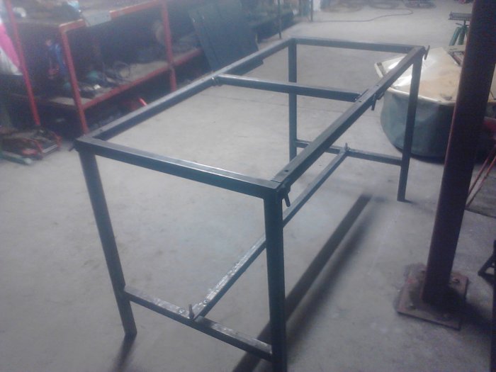

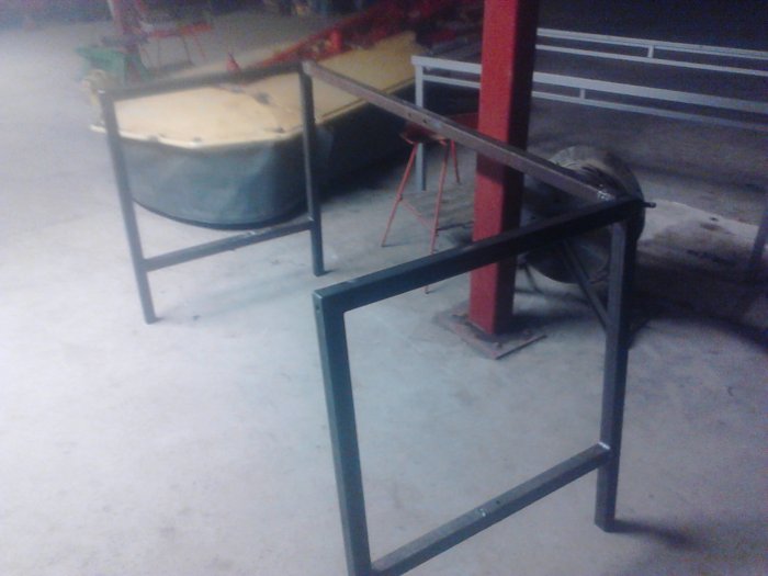

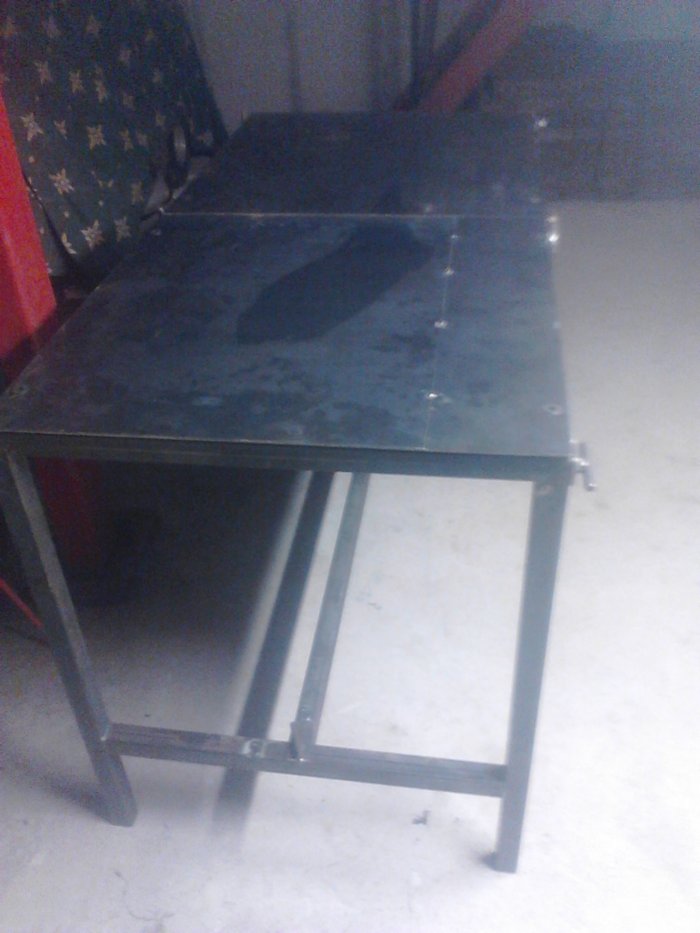

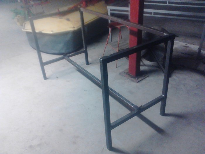

i designed this bench for bringing on site,the idea behind it was to get a man up off his knees when fabricating and welding on site and a levelish surface to work off, it would also prove handy for mechanics as its cleaner than some places where mechanics do have the misforture of working. 1610mm long 760mm wide, 910mm high. it can be assembled in about 4 minutes and taken apart in less. it will also fit in any decent car. what ye reckon
