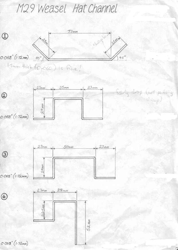

Im looking for someone preferably in the south of England that can bend or press the attached hat channel sections, the 1st and last I can have done locally the 2 center piece are causing me problems. any ideas?
I would have thought that anyone with the tooling to make no. 4 would also be able to do 2 and 3, what sort of quantity, & what lengths are the sections, where abouts are you.

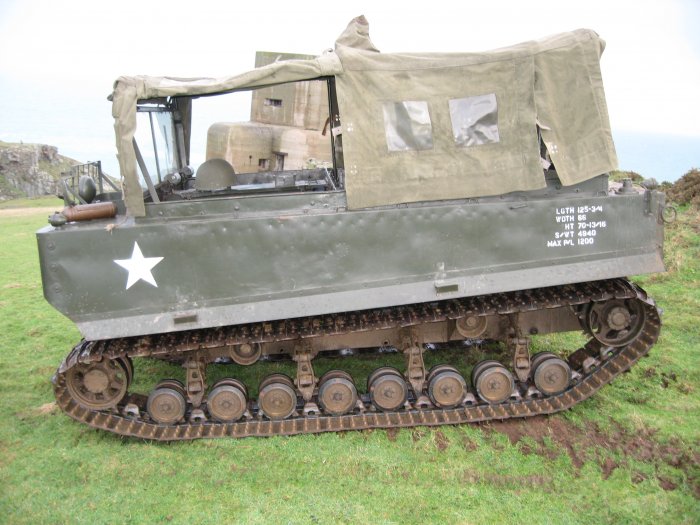

Its for a Studebaker weasel Restoration see pic below, I had a long chat with the sheet metal fabricators and he tells me its a no can do for 1 and 4. Any suggest? Im in Guernsey, Channel Islands. Thanks
They need pressing MK, easy enough to do here, but maybe not too much swan neck tooling about in the channel islands, I could make them easily, but the transport would cost a fortune compared to the cost of the job.
Standard sheet lengths 2.5m but I can do up to 3m if req
