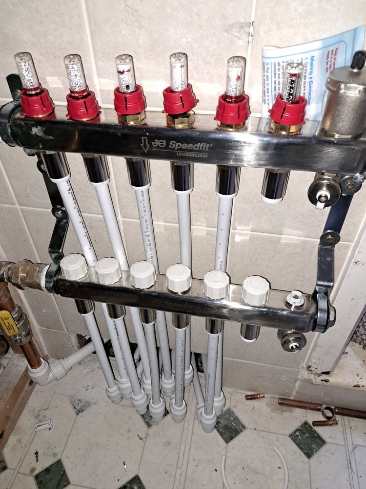

To solve a radiator issue on out system (lots of 8mm and 10mm micobore) we have fitted a pumped underfloor heating manifold to five rads upstairs that werent working properly.
Flow and returns are all plum ed in correctly but one circuit has no flow. We have bled it, check as best we can for air locks, got the system hot and tried just that one circuit but all to no avail. There was some flow on the old system it just wasnt very good. Now there is none on this circuit. The other four rads are working really well amd a lot better than before so it should work perfectly.
Pic of the manifold below. Its a JG speedfit from screwfix. What are the chances either the flow or return pins are faulty and are they simple to check? This is brand new so i dont want to invalidate any warranty.
Interestingly there is no flow to what I think is the flow to the rad. If the return is turned off at the rad I get nothing from the bleed screw, which makes me wonder if the flow at the manifold is faulty?
Any thoughts?
Pic
