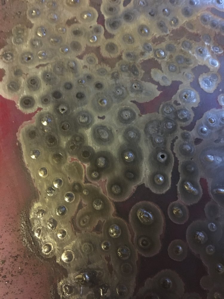

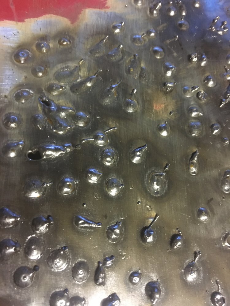

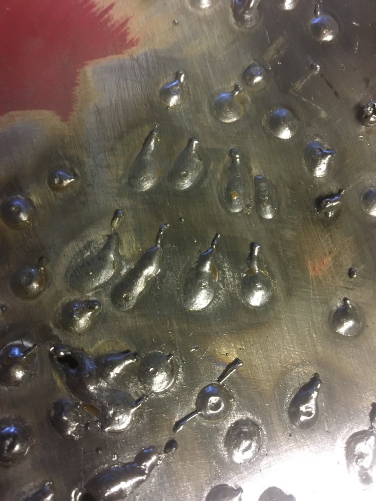

Hello everyone. I’ve been using the forum over the years for information as I have had nothing but grief from my dads old cebora. It’s has only been used for automotive related repairs, mainly patches and even since new had me and my old man pulling our hair out and throwing tools across the garage. Now ultimately a lot was down to not being a welder and having to learn over the years hence me normally having a read on here, and for years I have blamed myself constantly, and the only reason I haven’t binned the machine has been the information available on this site and pictures of the welds the machine is capable of. Now I made a set of coilovers for my last bmw, an e34 and the machine was brilliant and was no issue with the welds I was happy, but now I have arrived at having to put a patch repair on a visible panel and I have got to the point of either wanting to wallop the cebora with a sledgehammer, or stick the angle grinder into a main artery I’ve had enough. I have followed many posts and suggestions on here and have cleaned the contacts in the swan neck, cleaned and regreased the motor gearbox (unnecessary as it was clean grease in there) , replaced the earth wire with something meaty with a strong clamp, I am yet to replace the liner may be heading to wecs tomorrow for a new liner and swan neck liner. I am getting some good welds on a practice piece of steel that is also from another vw and getting some brilliant tack welds, then sometimes not, then outside onto the car with no adjustments other than increasing the gas and it struggles to strike up and I’ve put one good tack on against about 25 **** ones. I don’t no whether to blame myself, the machine or both, please can someone advise me, if needed I will take pictures. Thanks I’m advance jon
