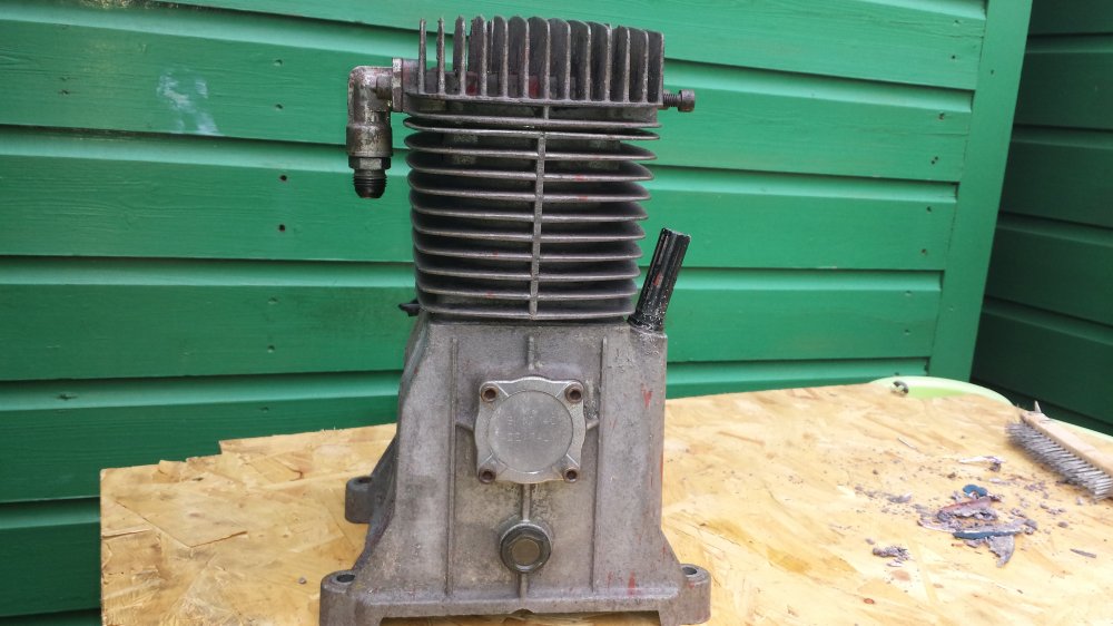

Please help id this compressor i need a new set of rings and gasket it would be ashame to bin it as it made 40psi with sticky rings 15mm of gasket missing and all the valves sticking open thanks guys it has made in italy on it

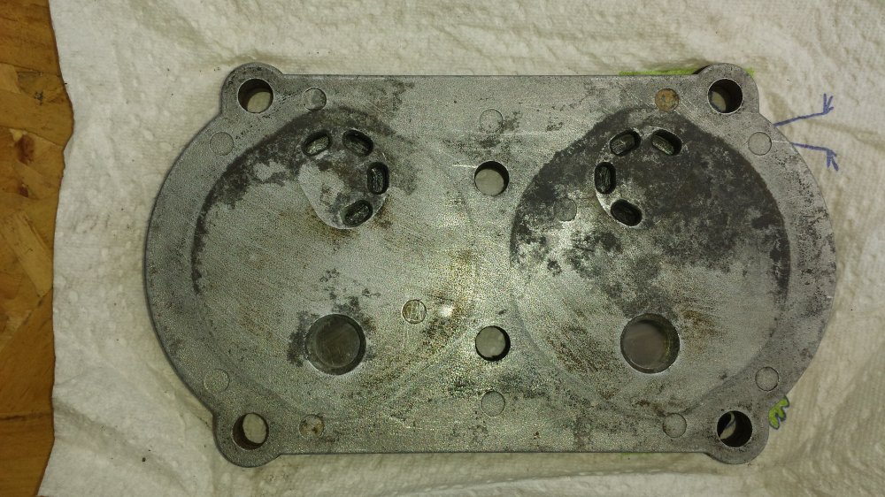

Ok bud i have found one similar but the head and valve plate is not the same its the head gasket i need as well il keep on trying google and so on the find the make
To me it looks like an abac pump, I think there made in Italy. What are the markings on the end plate in the first picture or does it just say made in italy
B/10/40 made in italy that is it bud it looks very similar to the abac pumps i found one on ebay the seller says his is the same on his the valve plate is different
The pump motor looks similar to the Snap that I have been repairing in this thread but you have a lot more fins. The valve plate in yours however is identical (see page 4 on my thread).
The gasket between the valve plate in mine had split between one of the inlets / outlets, managed to get some gasket materiel from a local Engine Workshop and fixed it, running like a beauty now :-)
Have a look here for some info maybe? Its and American company but there is a lot of info and exploded diagrams, never found a valve plate the same as mine but the complete Valve Assembly from the B3000 probably would have fitted? The pump closest to mine like I said was a B3000 which is now obsolete, but some parts are still available?
