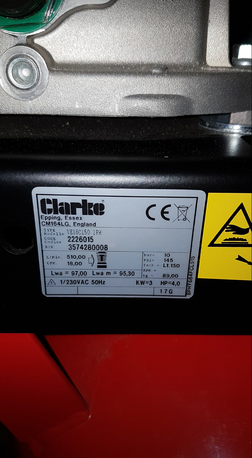

So I’ve hunted about and decided that what I’d like is this vertical type compressor with a 4hp motor running on 1ph: Clarke VE18C150 18cfm Industrial Vertical Electric Air Compressor 1ph (150ltr) - Machine Mart - Machine Mart - https://www.machinemart.co.uk/p/clarke-ve18c150-18cfm-industrial-vertical-elec-2/

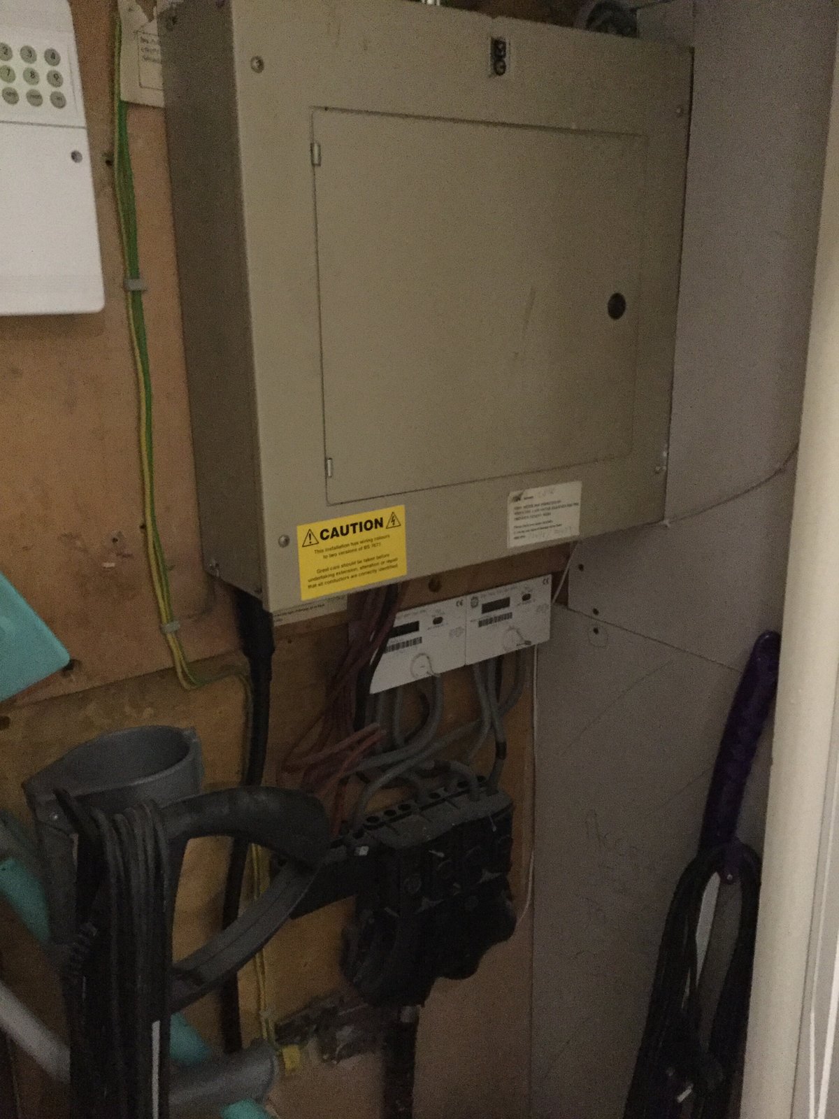

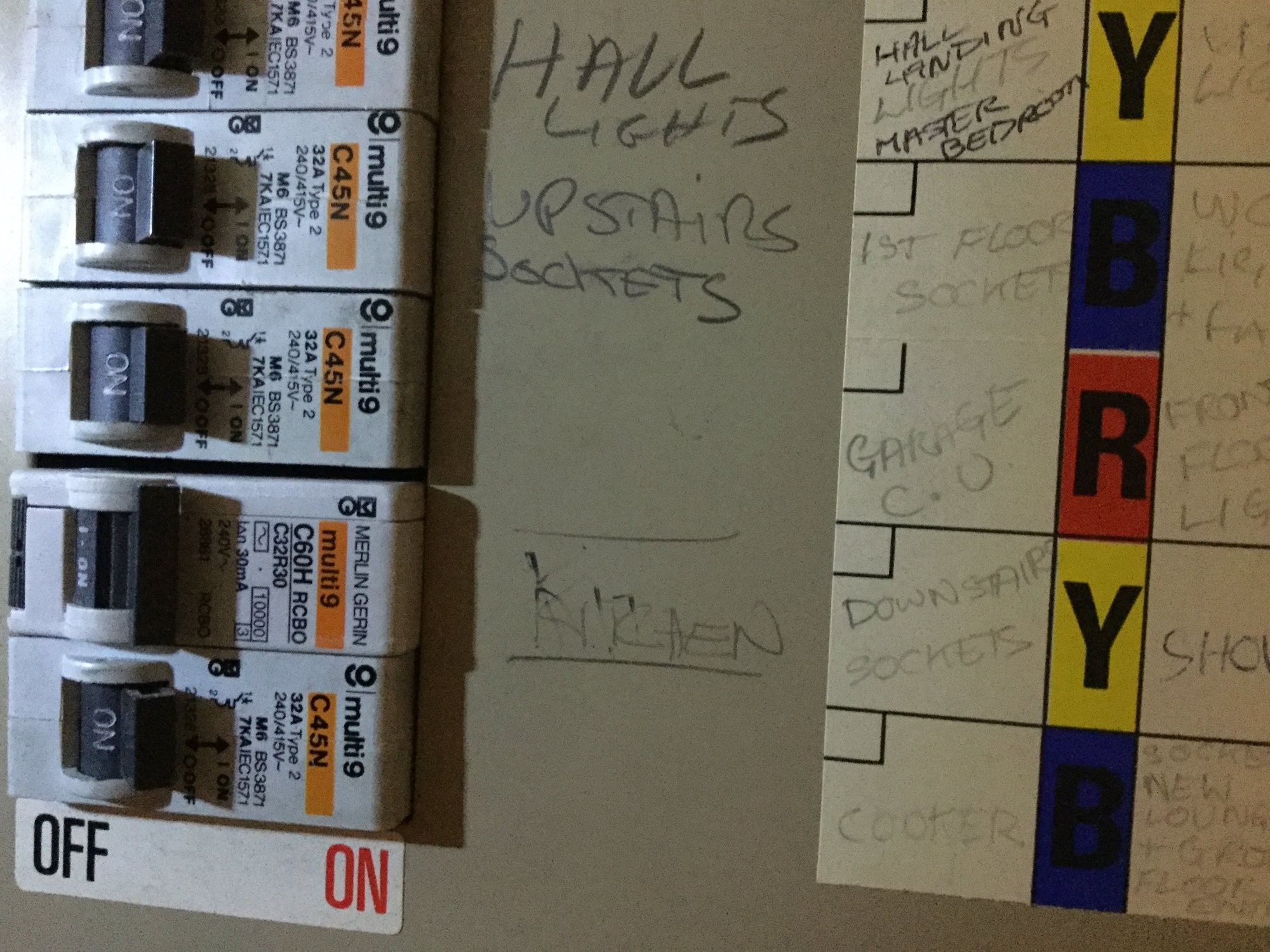

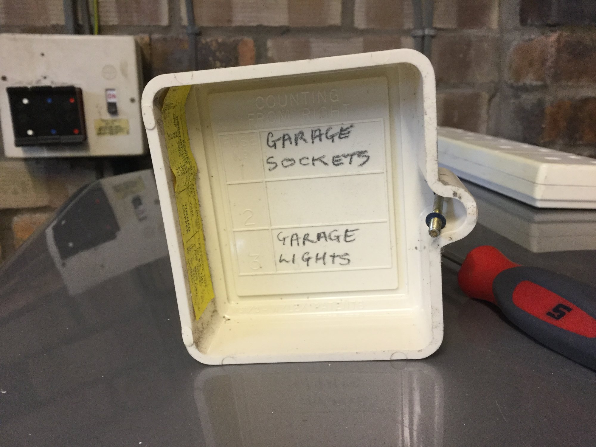

My garage is separated from my house by about 50 metres and the picture below is what electric I currently have wired into the garage (I think this is called a Consumer Box). From this box runs 6 6ft LED tube lights and 3 double sockets:
Below is a pic of the specs of the power I need (unfortunately I’m no electrician but know it’s not for plugging into a normal socket 13amp socket):

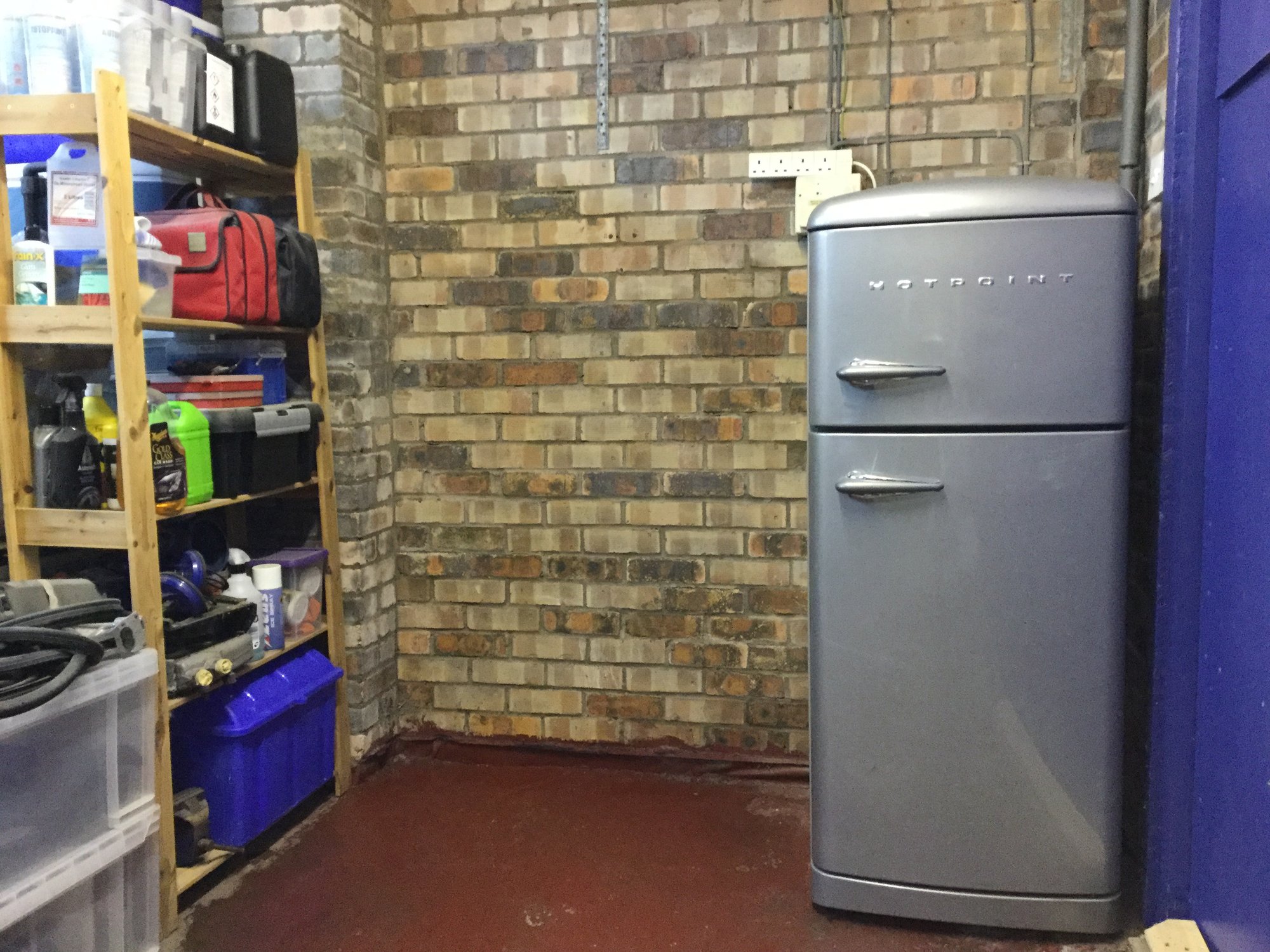

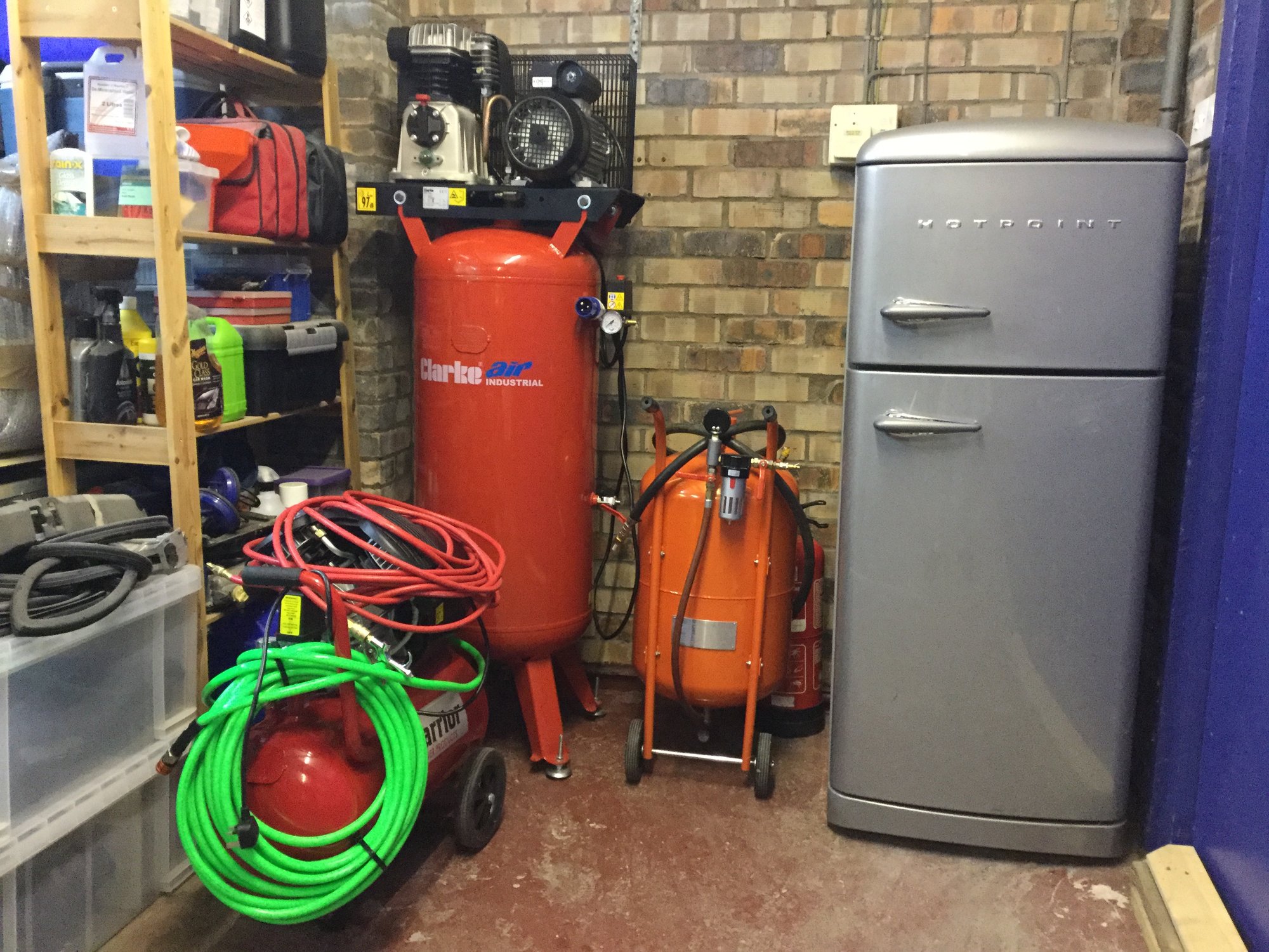

Here is a pic of where I’d like the compressor to live (note the location to where my power comes into the garage so I hope only short wiring will be required):

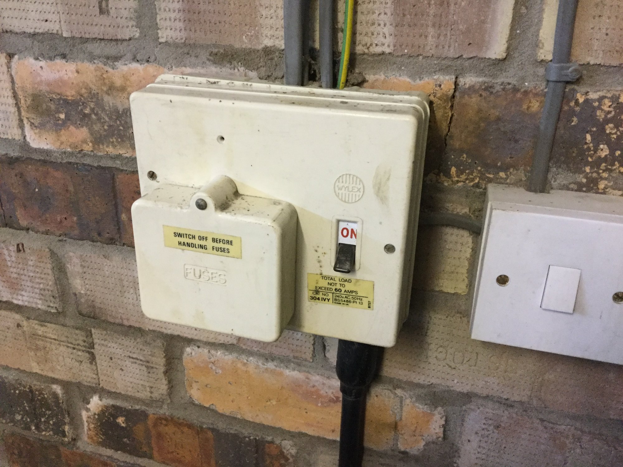

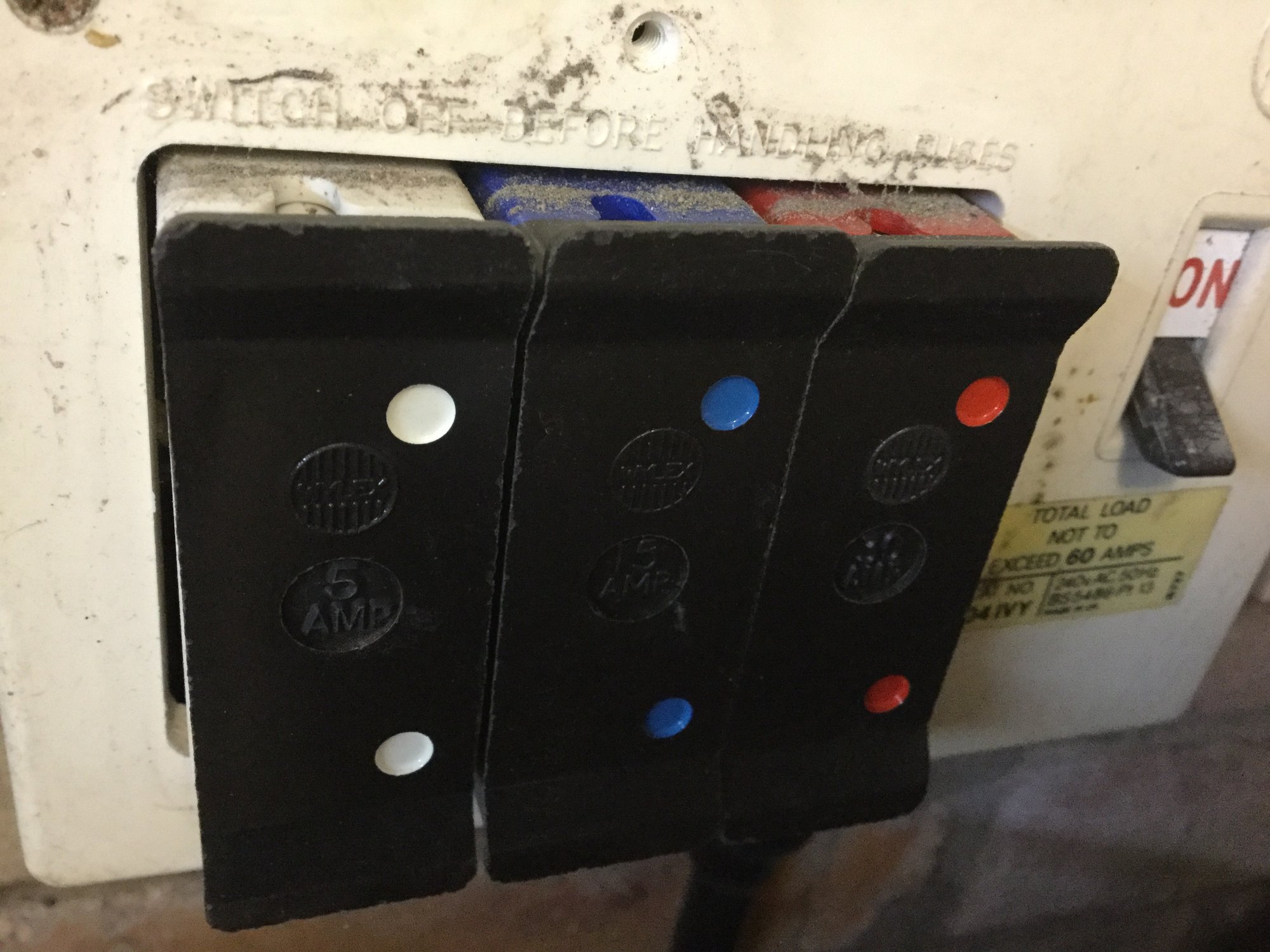

Here is a pic of where the electric enters the house:
Firstly I’d really appreciate if somebody could clarify exactly what I need doing to make this work for me (what questions to ask an electrician for phone quote and parts I may need to buy).
I’m really hoping I’ve not committed to purchase this compressor in vein being left having to sell it on.
Lastly any ideas what sort of cost should I be expected to pay and how long this takes.
