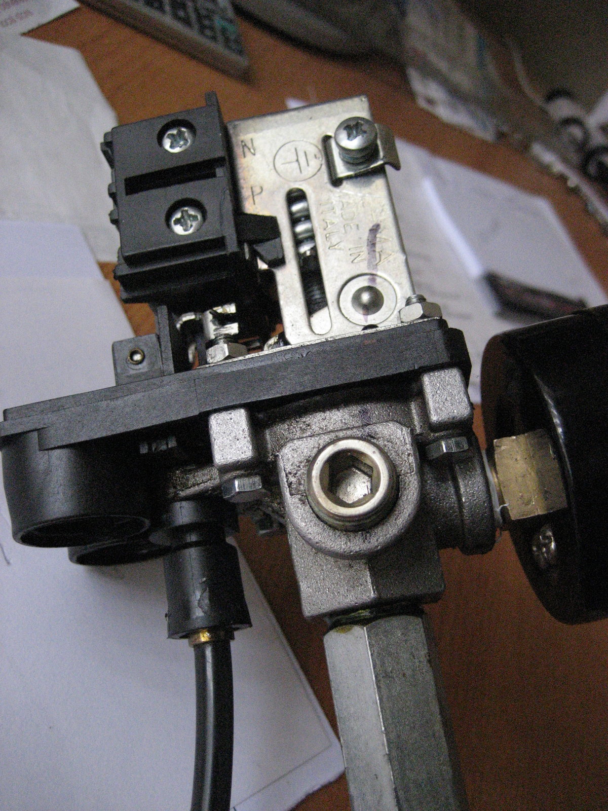

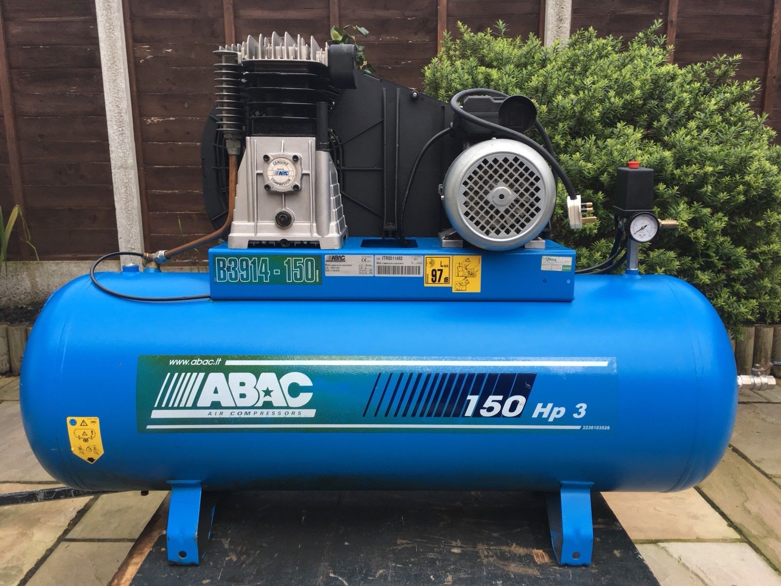

I've just bough an ABAC 150 compressor - 240 volts single phase 3HP - it was advertised as 'faulty' on EBAY. You can see from the pics it's in very good condition and there's nothing wrong with the pump or motor.

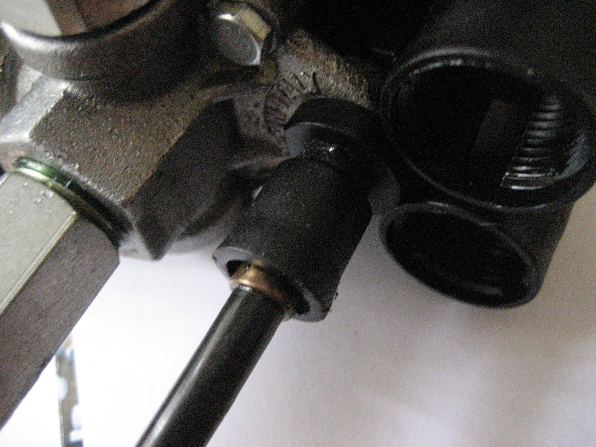

I had a word with the guy when I collected it and he showed me the problem...it seems that the small air tubing going to the regulator is leaking air quite badly at the regulator...he also told me that the 'other end' where it goes into the tank had been replaced with a new 'pastille' I think he said??.
So...do I need a new regulator or is there some way of tightening the tubing up..I can't see any way it comes off?? Also the gauge didn't seem to read any pressure even though the tank did fill with some air??

, or something to do with the centrifugal start switch (if it has one??)
