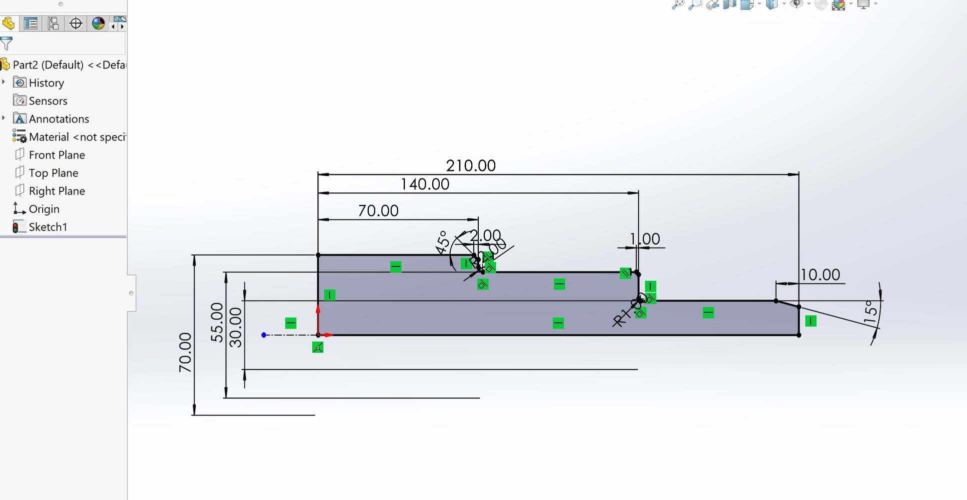

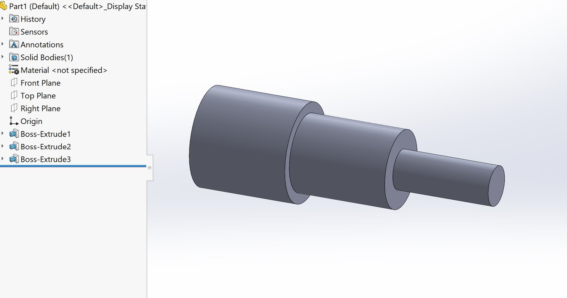

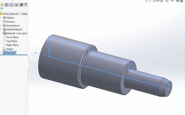

I have just drawn a part that is cylindrical. It has a number off different diameters and lengths etc, but all have been drawn on the same axis, so every time I needed to add a different shaped cylinder I just started a new sketch on the end of the last cylinder and used the centre to start the new sketch- so pretty simple.
However, I now need to make a rectangular hole through the side of the cylinder. As each different part is a feature (extruded section to give length of cylinder) I am not sure how to create a new sketch on the side of the "feature" - ie, the side of the extruded cylinder.
Could anyone give me an idea of how to do this, or do I need to draw in a different way?
Thanks in advance for any help and advice.
Mick
