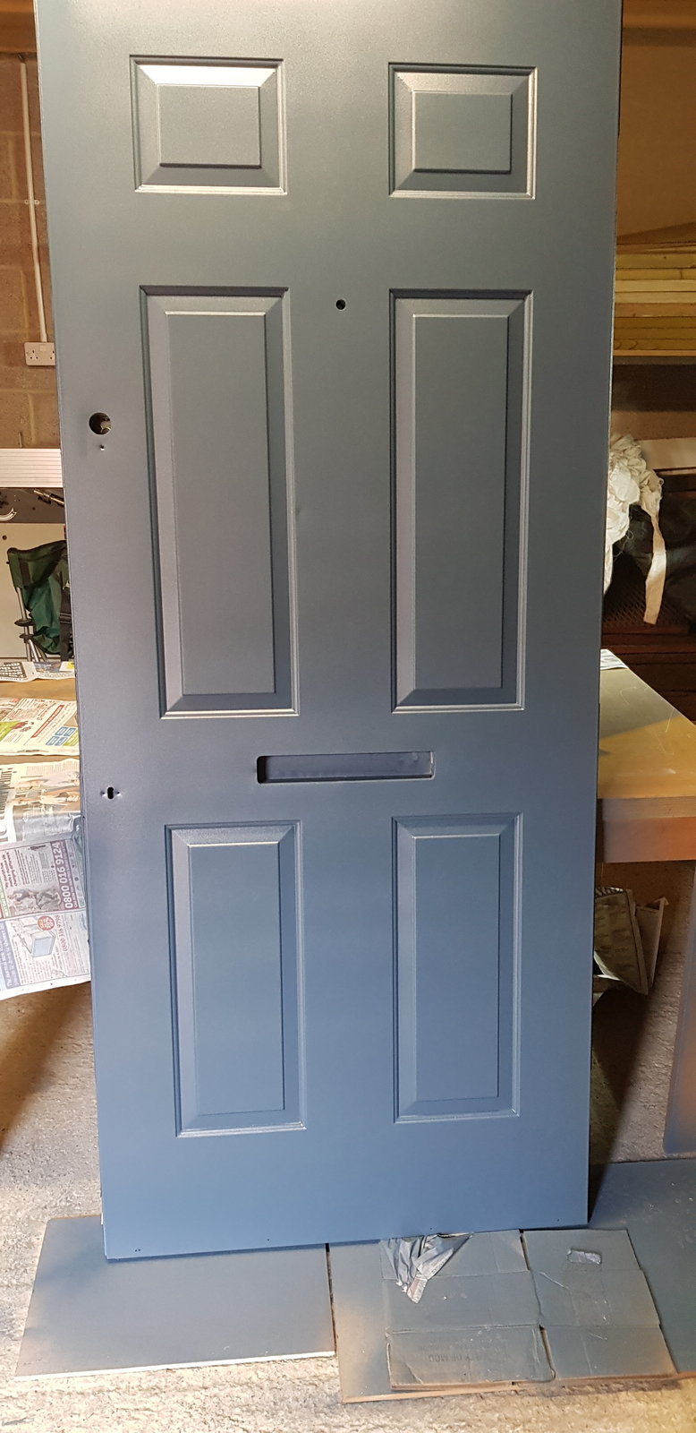

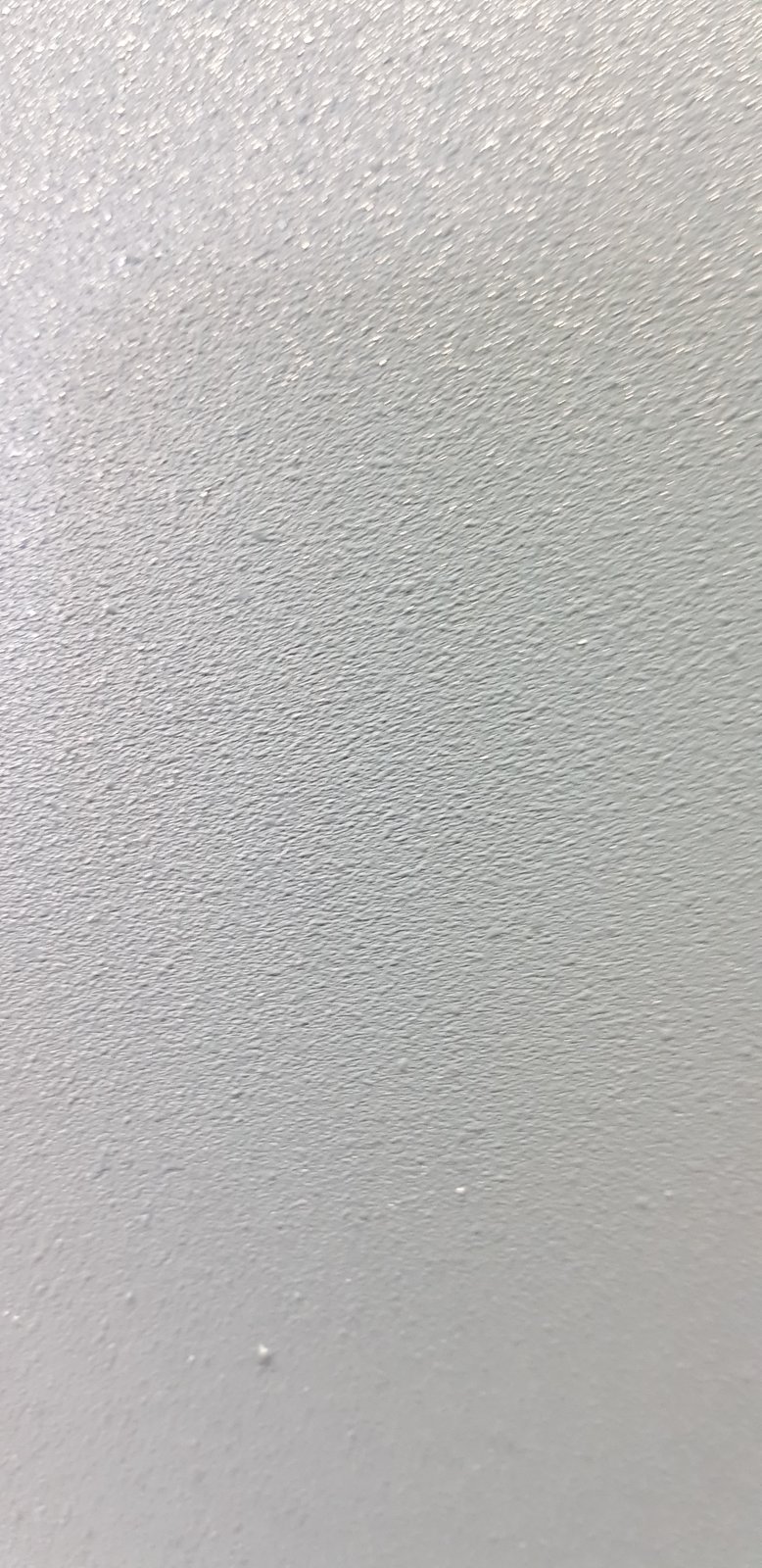

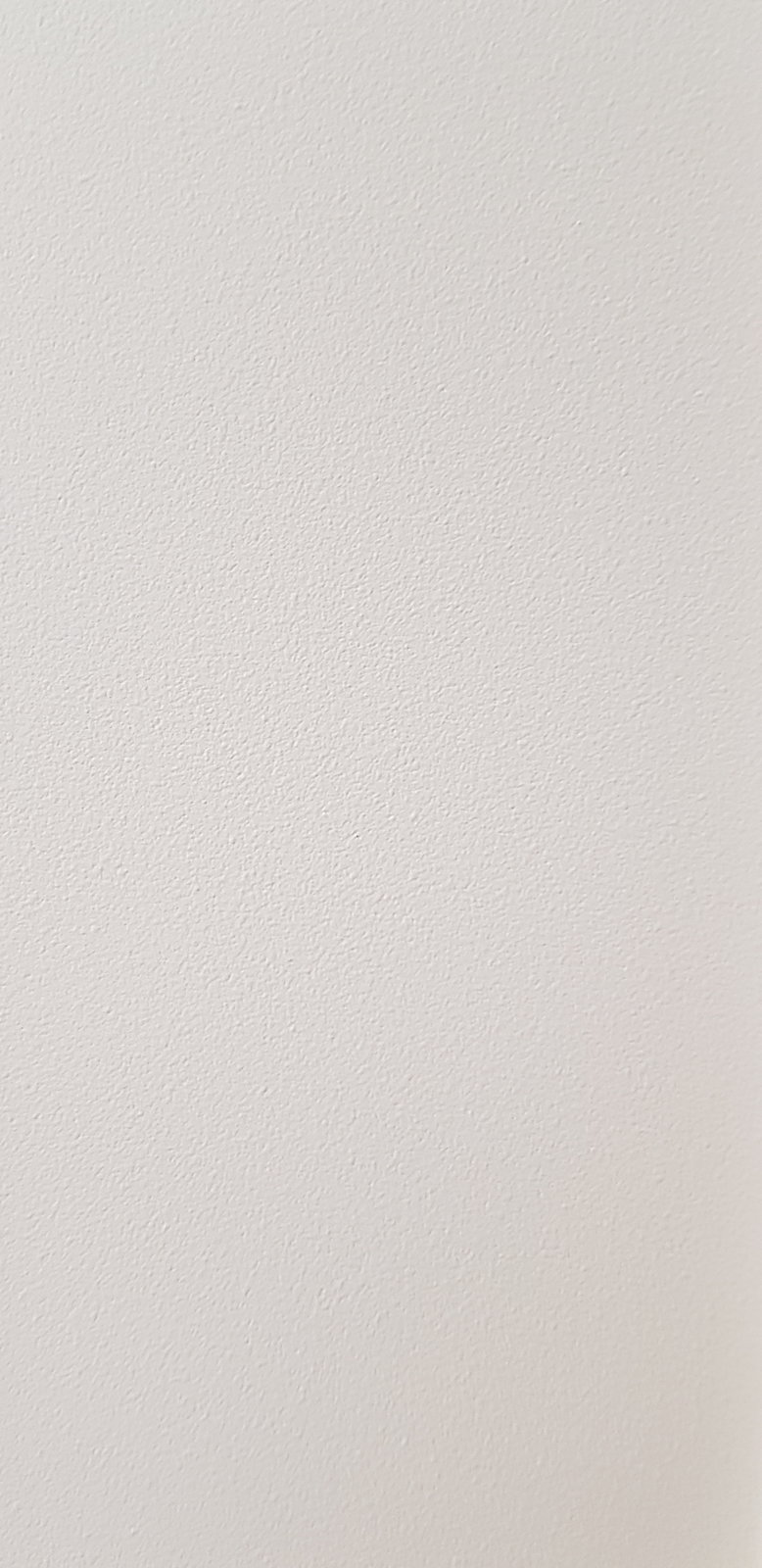

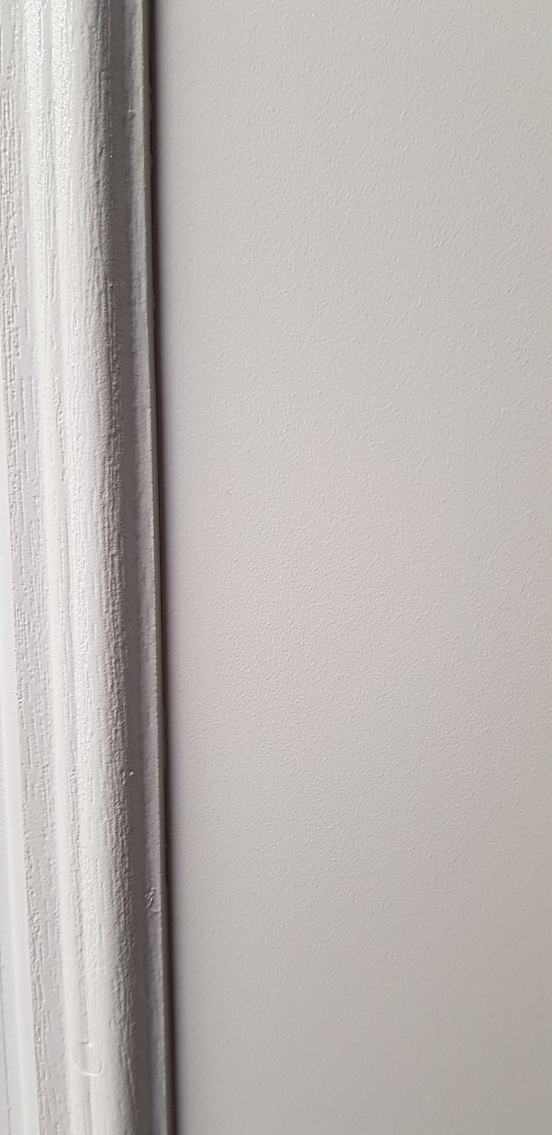

I bought the Wolf Dakota compressor last week and yesterday I have had my first go at spraying with a compressor with mixed results. I could not get the spray to a fine mist.
Setup as follows:
Wolf Dakaota 90ltr compressor - water trap - hose - small water trap - spray gun.
Granted the spray gun is only cheap https://www.amazon.co.uk/Silverline-783124-Gravity-Feed-Spray/dp/B000LG0VMU and I dont expect to get AWESOME results from it but I do feel I should have had better results.

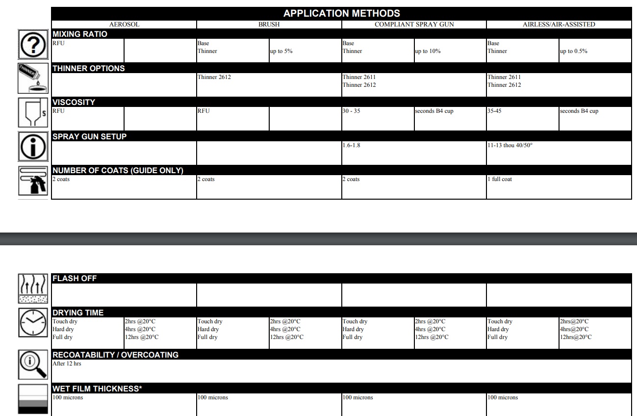

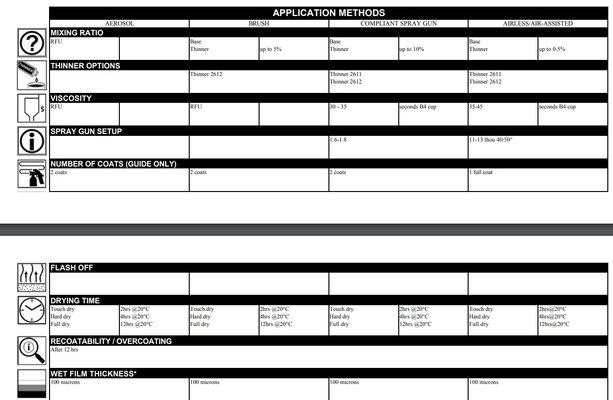

I used HMG Speeddline C71 paint - https://www.baileypaints.co.uk/indu...ck--1k/_file/551/c71-speedline-datasheet-pdf/
I thinned the paint with recommended thinners up to 10% but it did not seem to make much of a difference.

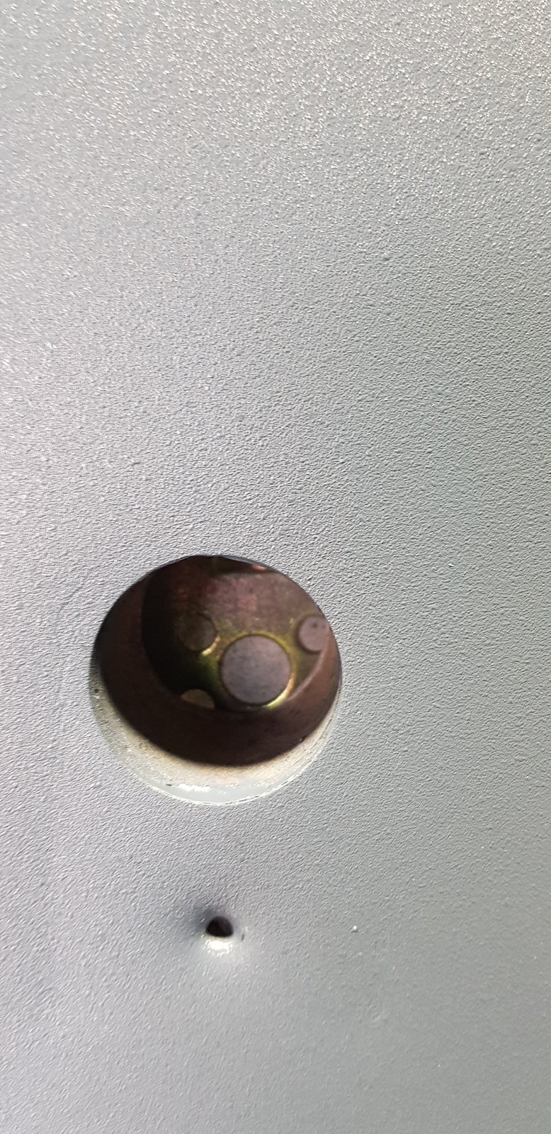

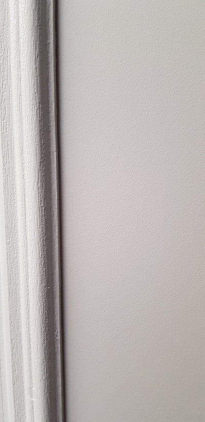

The main problem I have experienced is there seem to be a fine mist of spray but with it there is also little "blobs" of paint.

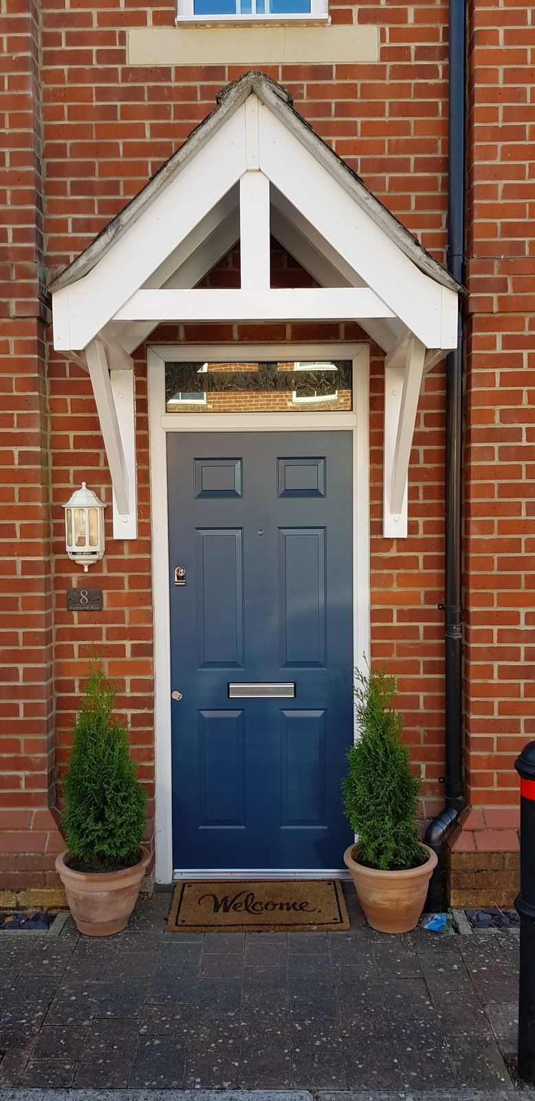

While I am overall pleased with the outcome of the door, I would like to sort the problem out so that I can get a smooth finish on other items.
Please look at the attached pictures especially the close ups.
Any help appreciated.
