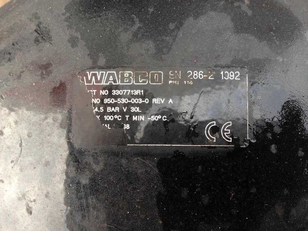

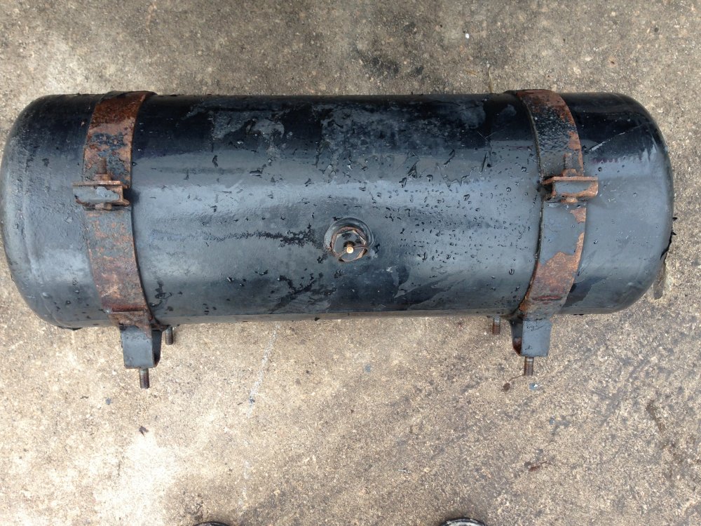

The air brake system will be 10 bar ish working pressure, So the tank will be plated at more.
I will have a look at a tank on Wednesday.
As for the threads most are now metric fine.
i work for meritor, they make all of volvo lorry brakes and the tanks we used to make ran at 13 bar max pressure bit that wasn't the max rated pressure, just the pressure that was required afaik
