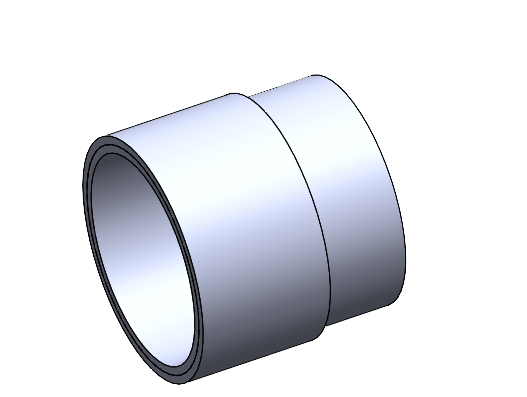

I need a narrow pipe followed by a thicker pipe to secure other (loose) parts on the narrow pipe in placeWhat's it for ?
It's a support part for a beach flag. The legs (which have to be able to rotate will be secure on the narrow pipe. The wide pipe makes sure the don't fall off.Coolant ? Exhaust gas ?

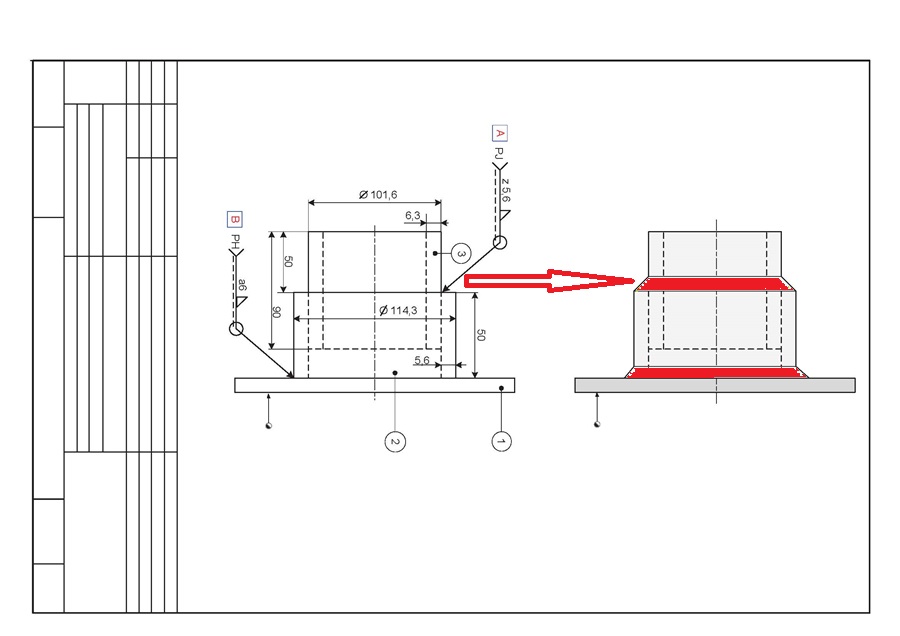

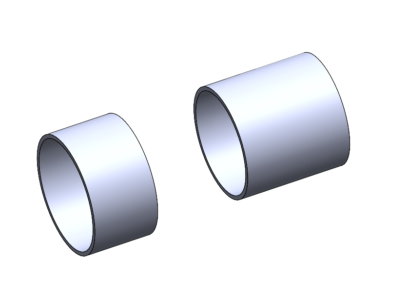

here I have an example for you.So I need these two pipes two be fastened over each other and I was wondering if it's possible to weld this. The pipes would be made of steel. Thanks in advance!
View attachment 448564 View attachment 448565
Who's put those weld details on?
Much better/easier to do them both in PB, rather than PH/PJ...
An a6 weld is quite chunky, be looking at a 9mm leg length to obtain that sort of throat.
