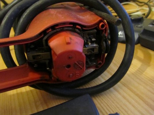

I have a hilti te10 sds drill here, the last time I was using it, there was a funny sound coming from it after use, sounds like burning/shorting but didn't seem to have any affect on using it.
I would also give some thought to double checking the 2 core cable right where it enters the drill handle area, very prone to fracture, but it generally fails or burns. brushes might well be on a special brush carrier.

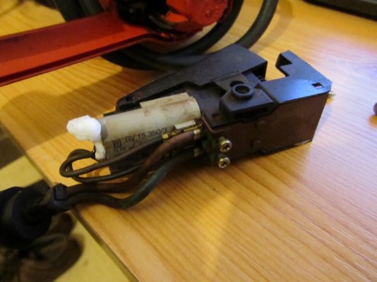

fried suppressor /capacitor In there to stop the nasty lines on your TV Replace or remove. Think of the caps that go (cook) on compressors or digi boxes ext.
