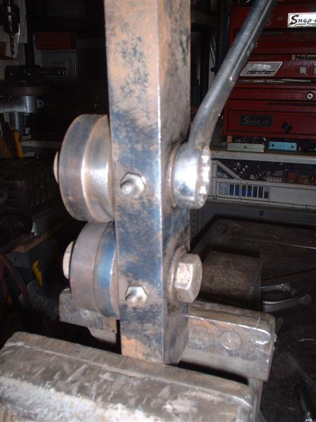

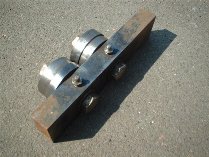

I knocked this roller style one up about 30 years ago just to do one job and its still working well, easier to follow curves with too.
Usually turn it with a ratchet and 15/16" socket, not the spanner shown here

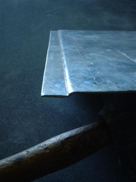

1.5mm galv sheet, much thicker than the tool was made for.
