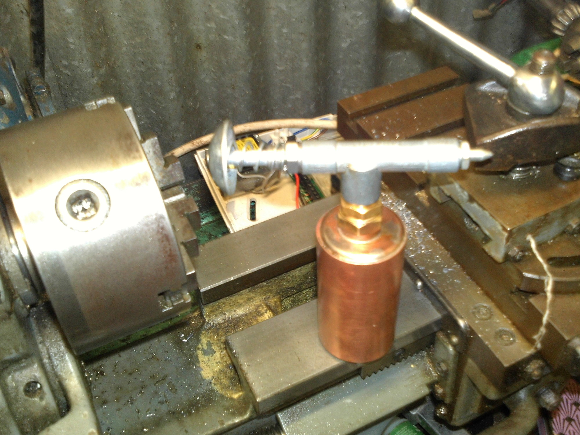

using the supplied oiler for a myford is a poor affair and leaks all over from the plastic screw on cap in use
. shox doctor on here was selling the oilers minus the oil bottle we bought a few and my brother made a copper bottle for them and used brass bsp couplings for it / the bottle is made from 2inch copper tube and formed copper end caps silver soldered in it works perfectly for the job without leaks
just a pity my photography wasn't as good
