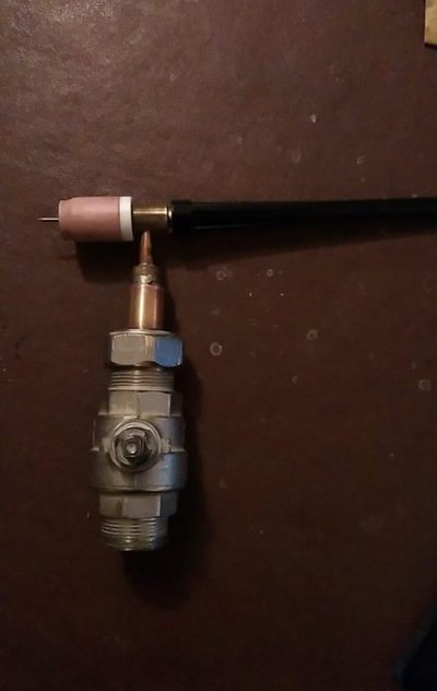

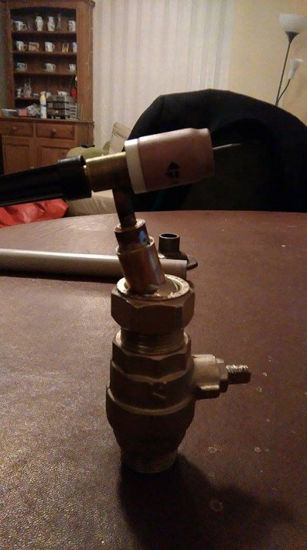

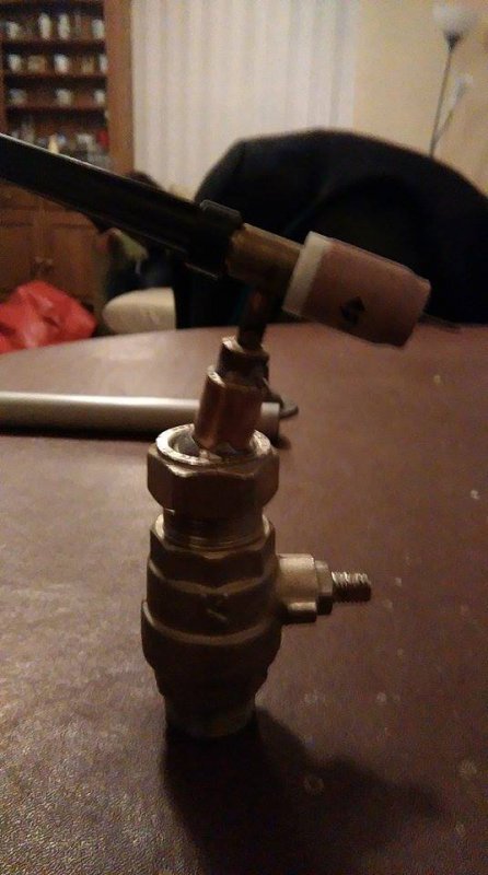

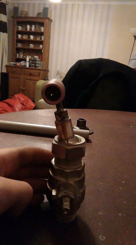

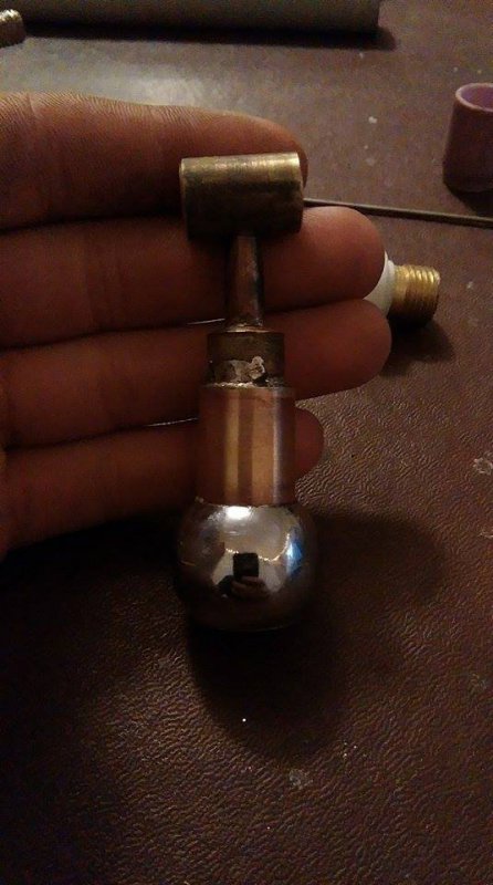

The head pivots on the ball stolen from a quarter turn valve and is locked in position by the compression nut.
The big valve is just to show how it works, I'll make a much smaller plastic handle soon.
It's got series two gas lens consumables (Which Weldequip delivered the day after I ordered, very impressed) .
A thinner neck on the ball would allow it to angle further, and a smaller ball would allow me to use a smaller compression nut so the whole thing would be smaller and lighter. I'll make another if I find a smaller ball.
What do you think?
