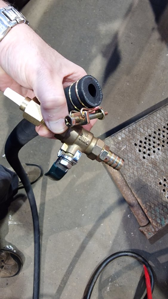

Tight as I can get it pulls off by hand. 115psi no chance.what's wrong with it?
leaking? hose coming off?
air? oil? water?
Worth a try.Fuel hose clip?
I agree, if it's not a struggle to get the hose on then the barb is too small.if it pulls off by hand as easy as that I think you need a bigger hose barb?
It is supposed to be the same size bore. Doesn't go in easy but not that much force needed either.if it pulls off by hand as easy as that I think you need a bigger hose barb?
I've always found this sort of hose clamp to be the best... https://www.ebay.co.uk/itm/203846963479
Unless it’s under pressure it’s should sealIt is supposed to be the same size bore. Doesn't go in easy but not that much force needed either.
It will be. 125 psi. Its for a sandblaster.Unless it’s under pressure it’s should seal
Only moderate then ..Correct clamp and it will be fine I would think ..It will be. 125 psi. Its for a sandblaster.
