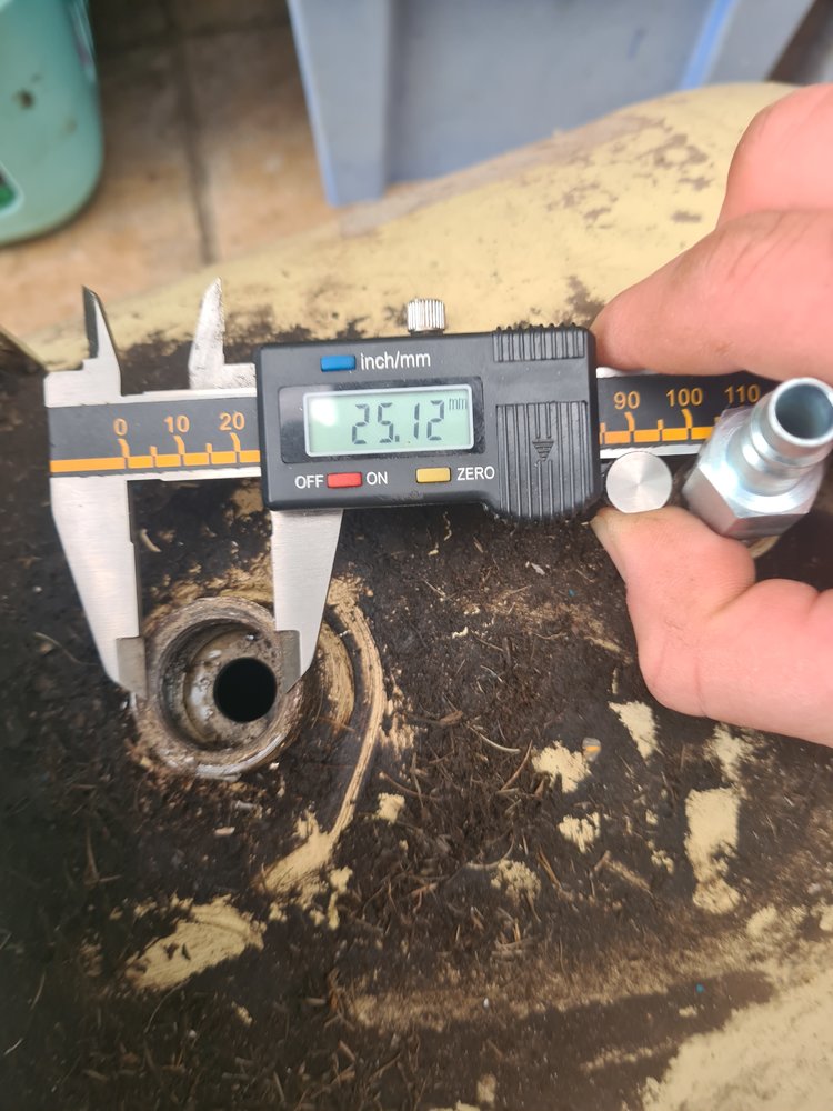

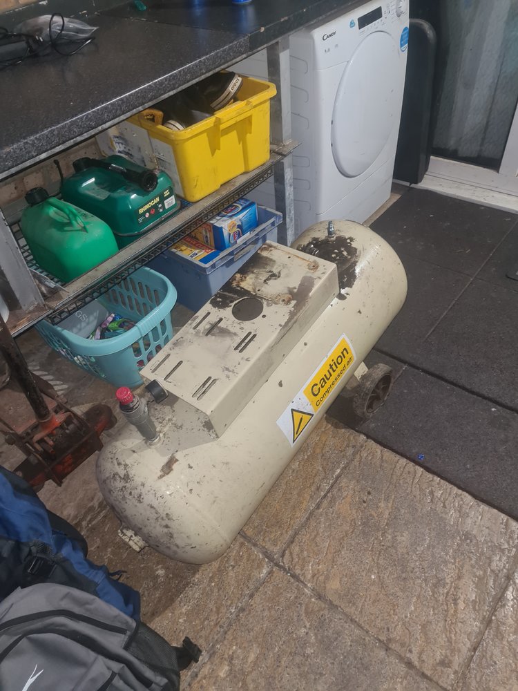

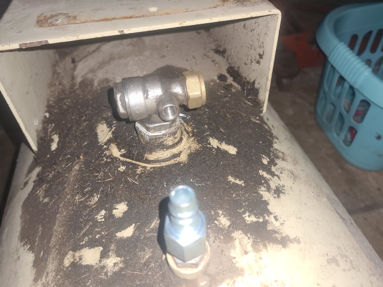

Ok going on my thread for swaping over a motor and compressor on my old air tank

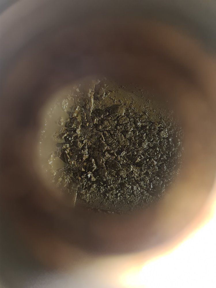

I wanted the old metal bracket off the old tank that was knackard but before I slice it up I want to cheak its not just a thread weeping that can be fixed with some ptfe
(This I dout very much as the bloke is very good at what he does but they did need a bigger compressor and all the electrical needed redoing)
So might be a chance that there is some thing silly wrong and I can redo all the electitery stuff as only needs a new box and rewire

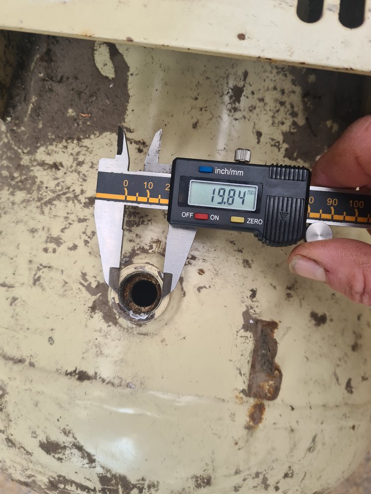

I've managed to block off a couple of the holes there's one in the 2nd metal that needs blocking off and 2 holes that feed the out put
Now I don't want to spend loads on this as it lightly to be knackard but don't mind a 10er
I was thinking filling with water then pressure the container up with air to test it

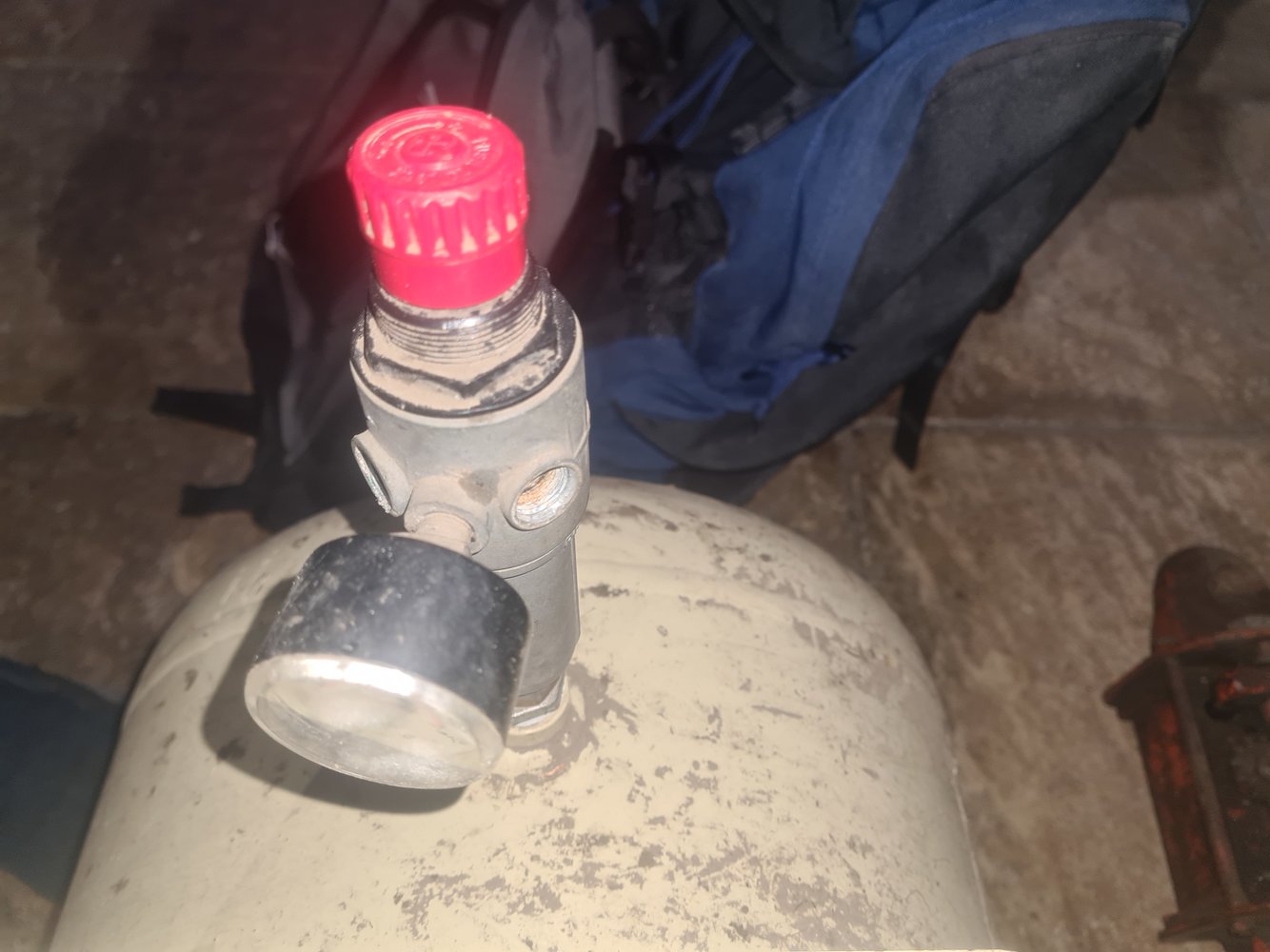

Will this knacker the pressure bit at the end with the adjuster on it if I do this ?
Or better ideas ?
