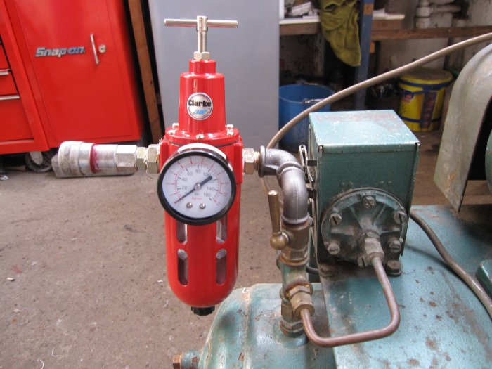

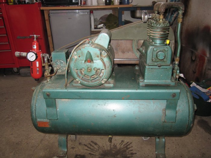

I probably sound a bit thick asking this question,but im a newbie where it comes to compressors.Will the filter really be ok where you have fitted it straight from the compressor,or is better to be mounted on the wall just above it?
It's OK there, but a large compressor is not likely to be moved around so I would install an airline system in the workshop working at tank pressure and locate regulators at the points where air is required.

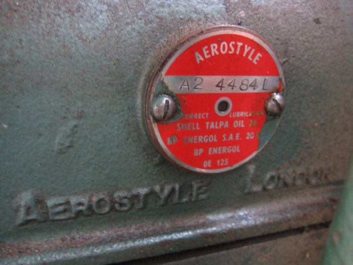

Hi the compressor is from around 1960, but it may be from late 50's too, Mine is from early 60's, my father owned Aerostyle company, and its premisses were in Sunbeam road Acton London.
