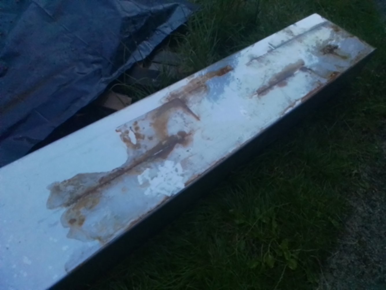

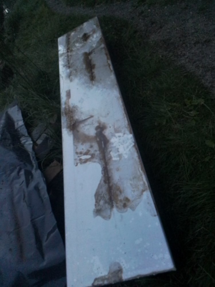

How to clean these marks off a stainless tank where its been in contact with mild steel ?
( Can't blast it )
Totally agree the strip and clean 3M scotchbrite wheels are great,Yeah the crap on the stainless in the first post, i wouldn't have thought citric would touch it. Even nitric acid pickling paste would take a while. I think you did the right thing in abrading it off. Poly abrasive wheels work great on stainless, at least the 3m blue ones do.
White vinegar in the UK is usually 6 % , American stuff in their pickling recipes is often only 3 %Yes, a soaked sponge should work. I think I'm right that citric is about 40 times more acidic than acetic ( but still a very weak acid) and citric does not smell. I once visited a workshop where they were using lots of vinegar to clean some big steel vessels - after a while the smell becomes a pain in the bum.

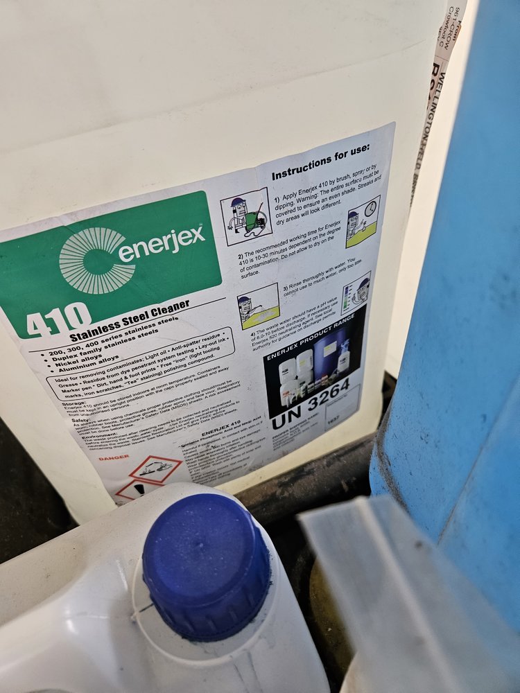

What do you use for neutralizing?This stuff remove light marks....a mix of hydrochloric, nitric and phosphoric acids I think.

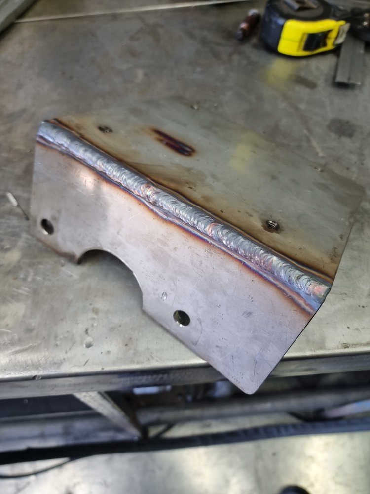

We tend to give everything a good wash down with that after cleaning welds with Antox or electro wand. Removes light rusts marks from forming, forks, benches etc.
Water
I've just geared up for a load of passivating for upcoming work, I'm using a bymat electro cleaner, and a couple of different phosphoric acid based cleaning solutions. I'm going to use elmer wallace mainclean, its at 10% dilution ratio which makes it way more cost effective than other brands neutraliser. But whatever i do i need to avoid white staining.
