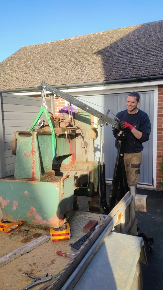

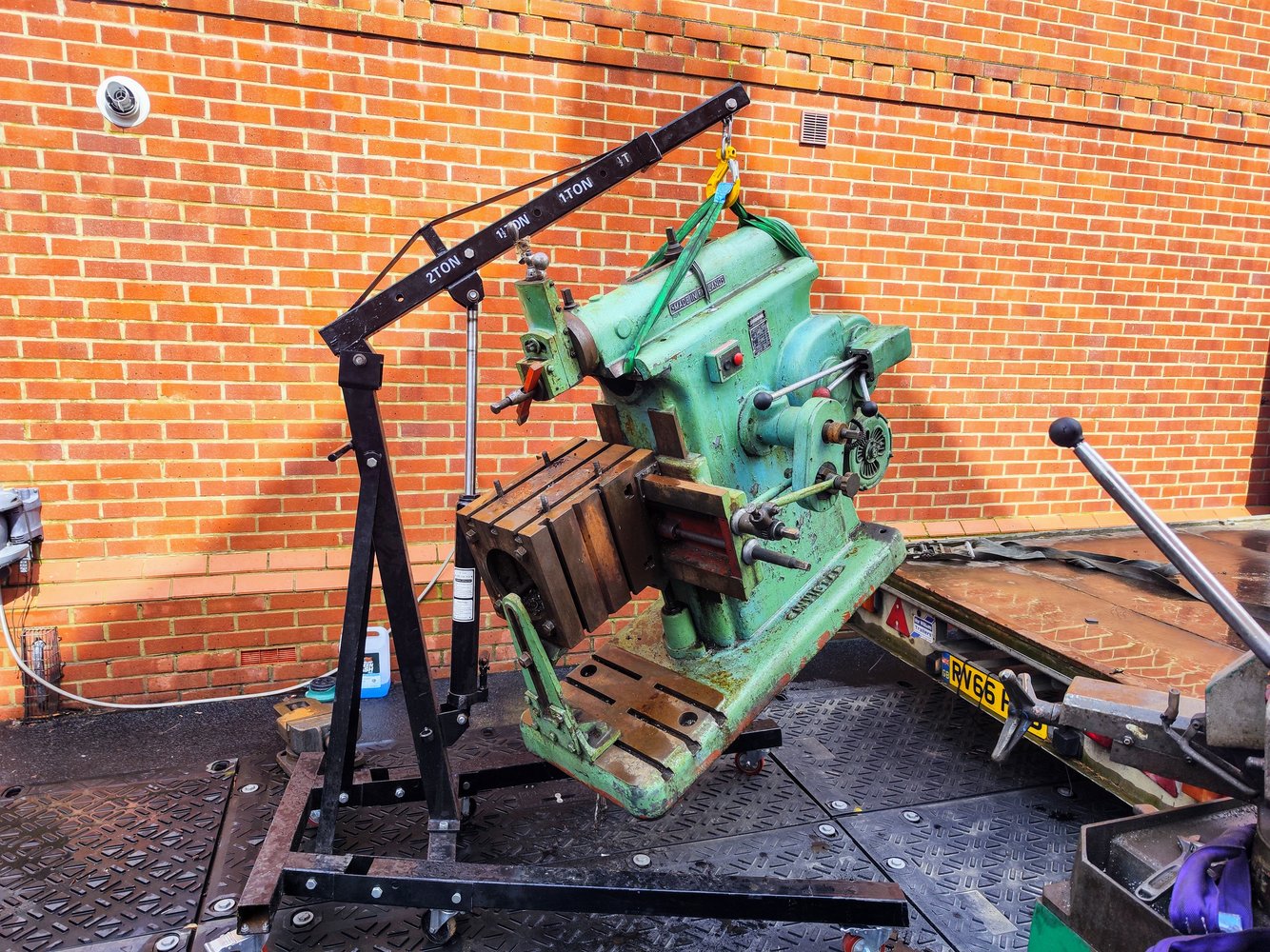

I'm looking at one shortly, and need to understand how I move it if I press the button. There aren't any lifting facilities where it's coming from, and I want to get it onto a trailer that's 15" off the floor, with nobody around to help, which makes it interesting. At least it appears to be coming from a nice even concrete floor.
I've looked all over and apart from finding they weigh 350kg or thereabouts and are top heavy, I've found no definitive information.
Here's what I think - remove the tailstock
Move the toolpost to the rightmost side and lock it of to help with balance.
I've read there are holes in the cabinet to put a bar through? I can see somethin on the photo - are they obvious when I stand in front of it? How long and thick does the bar need to be?
If lifted using the bar, do I need weight bearing slings around the tailstock end, or is it well balanced?
Can I move it on rollers (Round wooden fence posts)
Is there anywhere I should/shouldn't attach ratchet straps to - I'm guessing not over the ways is a good start.
Is there a simpler way??
