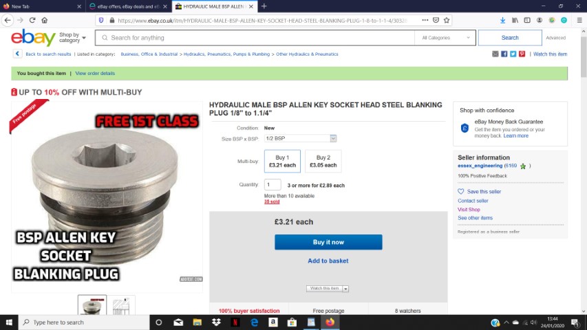

So should I remove that rubber ring?As long as it seals on the face, then yes![]()
nope, that's your seal. As long as the regulator also has a flat face for it to seal against, you'll be fine.
The "correct" fitting (and I'm guessing here) is a BSP tapered thread plug with thread tape, that's the usual air fitting thread, either that or NPT (similar enough to BSP to usually work)
The parallel thread face seal will work though
OK thanks.nope, that's your seal. As long as the regulator also has a flat face for it to seal against, you'll be fine.
I've been looking on EvilBay for a couple of flow meters/peashooters and a tee so I can run backing gas in pipes/tubes, they all just say "3/8 thread", no clue BSP or NPT, will they seal well enough (with a wrap of tape if needed)?

Some thread sizes, half inch in particular are dangerously similar, the difference is NPT is 60 degree thread angle, the BSPP is a parralel thread, BSPT is the taper, the BSP thread form is 55 degrees.3/8 bsp and 3/8 npt are close and will fit together but it can be hard work after a couple of revolutions.
