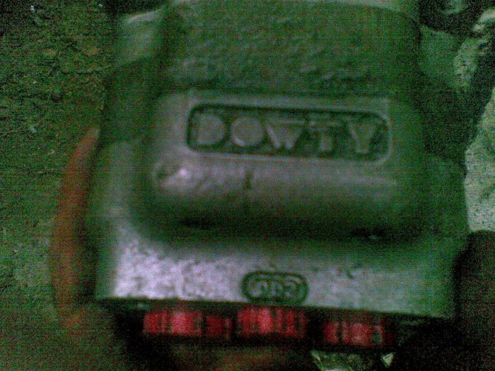

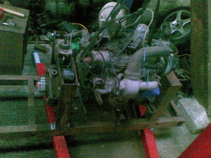

Hi, Ive been toying with the idea of making my own power pack for a while now. I have a few bits got, but must do a bit of research on the subject so any bit of help is appreciated. Myself and a few mates made a log splittter for a college project years ago and I inherited it after the project was finished but i dont have a tractor to drive it so I want to make this.
What i have is a peugeot 1.9 diesal engine and a hydraulic pump off a tractor driven hedge cutter. I managed to get these parts off my neighbour as he was planning a similar project for his silage bale wrapper but instead purchased a proper one.
I know an air cooled engine would be ideal as it would be stationary but im sure with the proper coolant and the fans working properly it should keep cool.

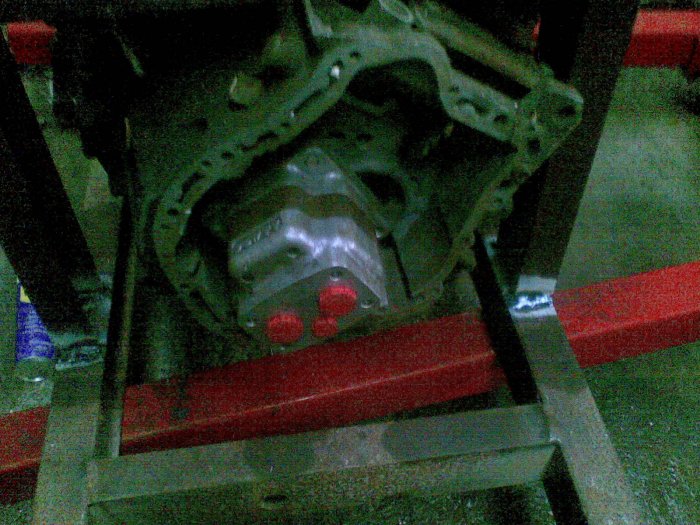

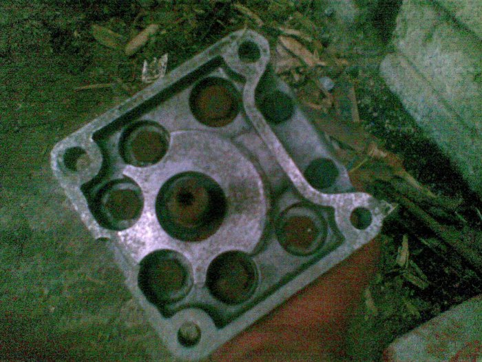

I got a shaft made up and its to be bolted onto the fly wheel where it mates with the pump which is mounted on the gearbox housing.
I have a dual tank partially made, one half for diesal and the other for hydraulic fluid.
The pictures i have taken arent the best but they show the progress i have made so far. This has been in my shed for 2 years and i want to start at it again.

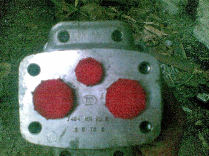

So some questions i would like to ask would be the best option for the hydraulic circuit. I know the pump has an inlet and outlet but what is the 3rd small port for on the pump? A friend said its for limiting the flow that exits the pump so it wouldnt flow at full pressurs when its turned on is he right? what kind of a valve would i need to control this? I could always blank it if its too much trouble.
My simple understanding of the circuit is this:
resevoir-filter-pump inlet-pump outlet- neutral on spool valve- return to tank
or- spool -ram
The spool i have doesnt as far as i know have a lock on position. The logsplitter is fully plumbed up and all it needs is is a supply but i want to incorporate a spool valve on the power pack incase it is ever used for something else. So can a way be devised to have the spool encorporated into the circuit without having to hold it forward to enguage the flow to the logsplitter. I wouldnt mind having multiple outputs like that of a tractor but would i be able to get the full force of the hydraulic pump by doing this.
Other things to be incorporated into the design would be safety pressure regulator to return fluid to tank when certain unsafe pressure is reached.
On another note im looking to put guages for oil and water temp onto a small control panal. Is it possible to get guages to work off the signals sent off the oem sensors or would new sensors have to be got?
Sorry for all the rambling put a little input from someone into hydraulics and electrics wouls be appreciated.
