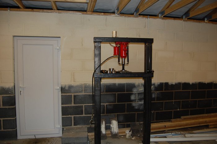

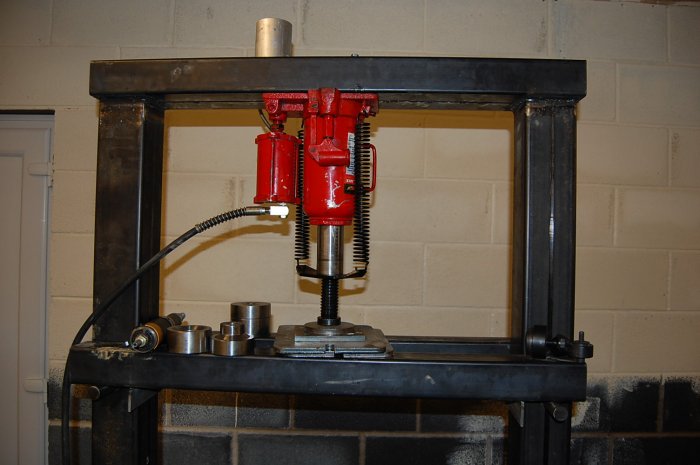

Yet another project i'm starting is a hydraulic press.
Just a simple bottle Jack press.
I picked up some 4" 6mm wall box today and some 3" box for the cross pieces. I've stick welded most of it together.

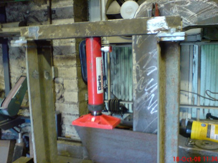

I also had a quick play with the bottle jack to get it to work upside down. It has 3 "ports" 2 are the 1 way valves, the other i'm not sure what it does. It seems to be connected to the reservoir rather than the ram side, but it doesn't draw fluid through.
I'm going to drill and tap the outter body of the jack and add the reservoir to that, hopefully this will work and the air of hydraulic will work as well so I can have both hands free.
The main reason i'm making this now is so I can fold some sheet metal for my parts washer project. From experience what will a 20 tonne press bend? I'm wanting to bend 1.6mm stainless the full width of the press, (800mm)
I'll post a few pictures up, cost a fair bit to make, but better than the cheap junk you buy and there simple enough. I'm all open to other ways (other than use the jack the normal way) to mod the jack and how to make the tooling to fold the metal etc.
