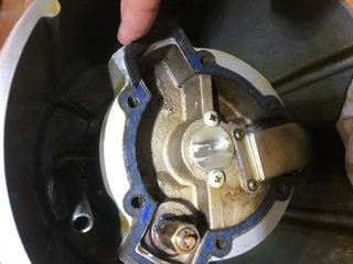

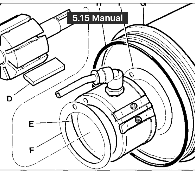

I just ordered one of these not fitted yet and need the Shim things, and can’t buy them unless in a kit £110, i already bought a service kit plus that teddy bear gasket mentioned, but on stripping down and looking in the manual, I see there’s supposed to be the shim spacers or what ever they are.

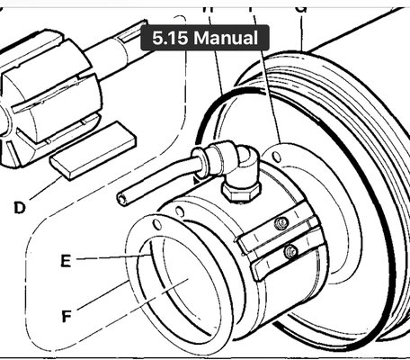

Item F in pic.
Any ideal if I can make anything?
cant use it at mo and psi too low, some of the vanes dropped out when I was taking apart, so could be that as they need to be fitted into slots they come out off, but for fell out and had no idea what went where as no way to tell.

they're light coloured plastic... they need to be exactly right or you don;t get any air pressure... they control the elearance at the ends of the rotor shaft/vanes
when you get akit you get a pill of different ones, all different thicknesses to use.... had no idea how to check what I needed with mine.... did it and got no pressure, swapped to thinner ones and got pressure
It’s all fixed now, I made a thinner set of shims around rotor, and all good again, guess first ones were too thick as mentioned. I only bought basic service kit, so didn’t get all gaskets/shims. Removed all vanes too, cleaned them up and rotor. Fitted teddy best gasket.

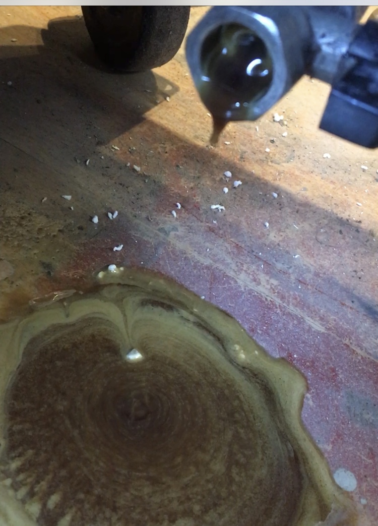

Works great now no oil leaks.
