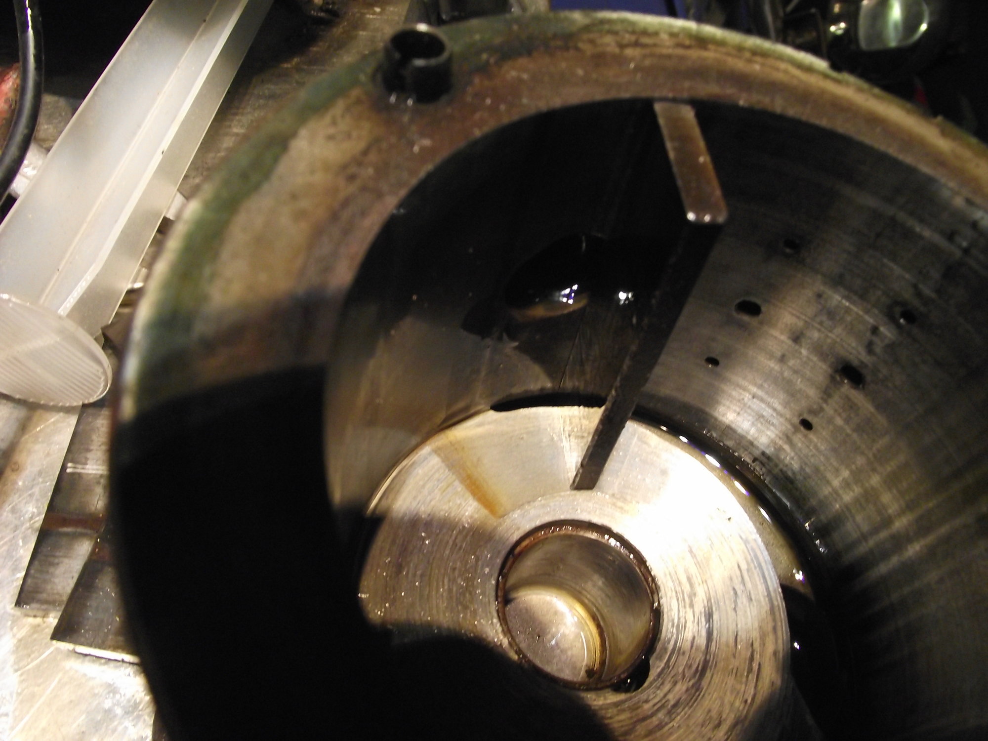

After many years I finally aquired a hydrovane!
But, it doesnt produce air.

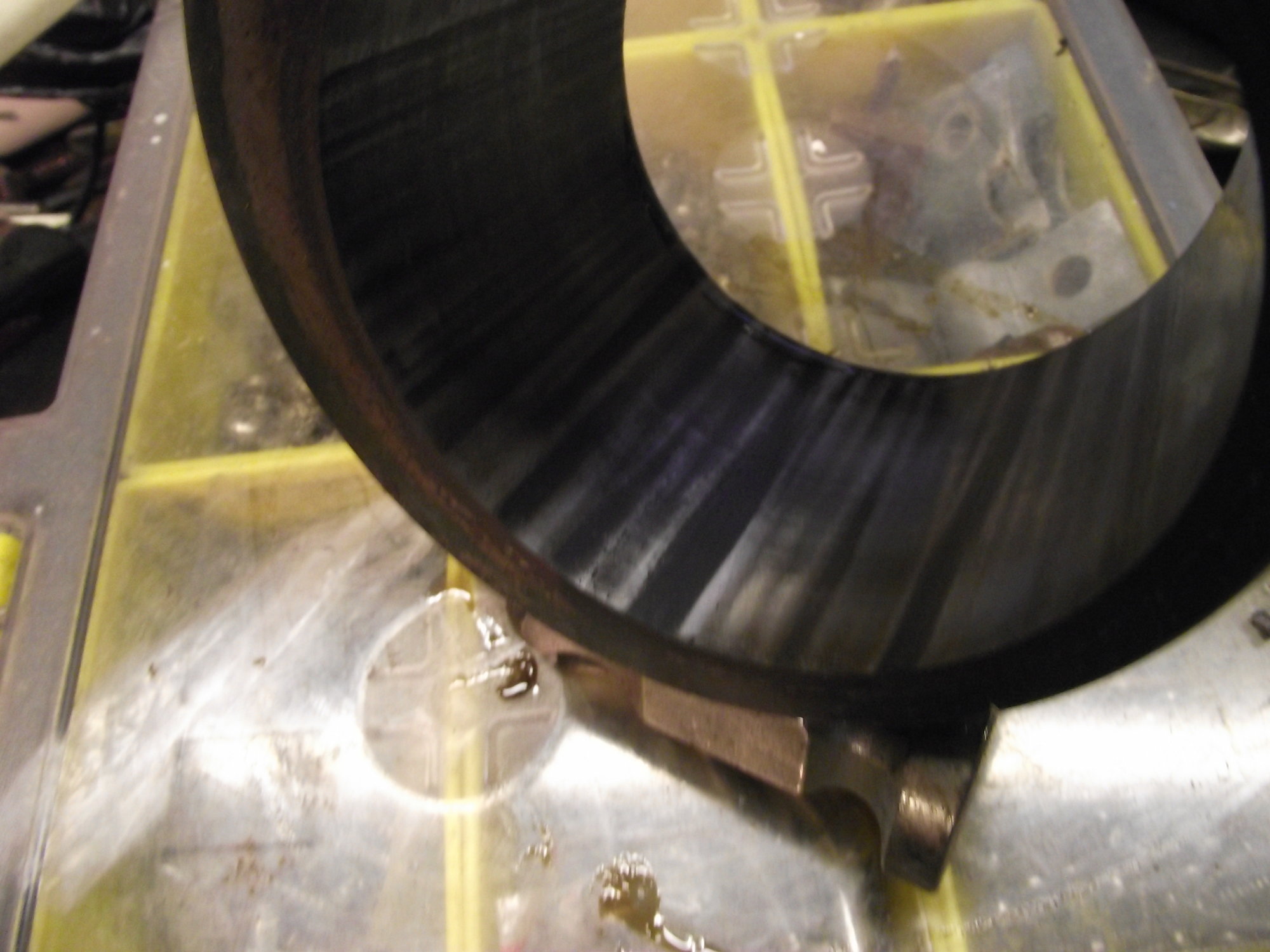

Pulling it apart revealed ripples in the eccentric main body where the vanes run...

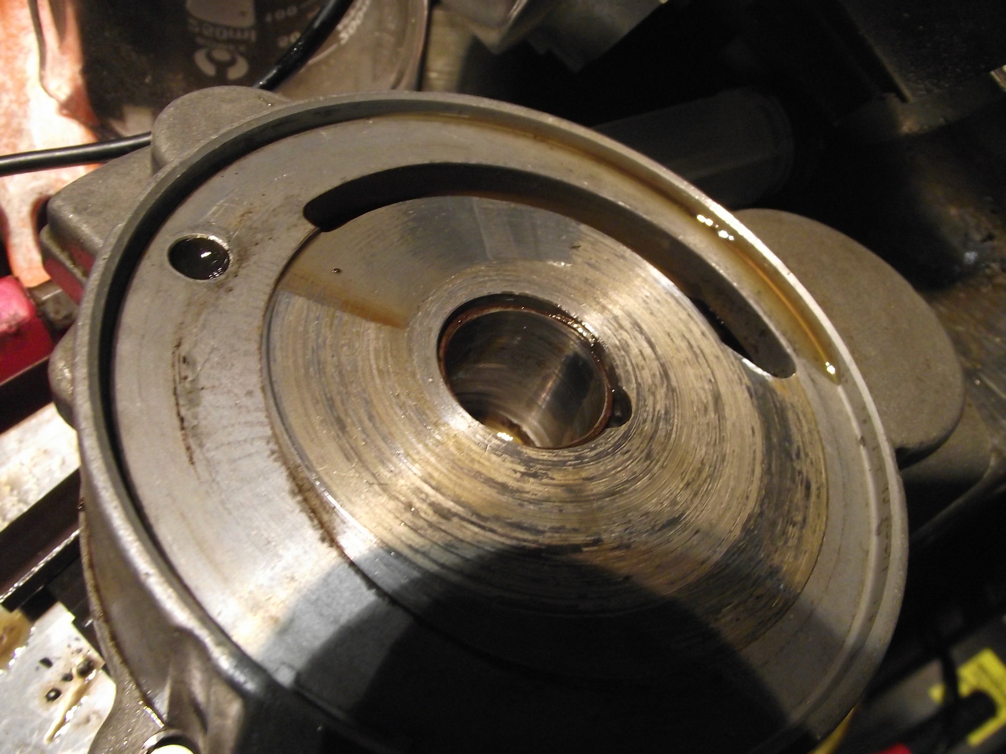

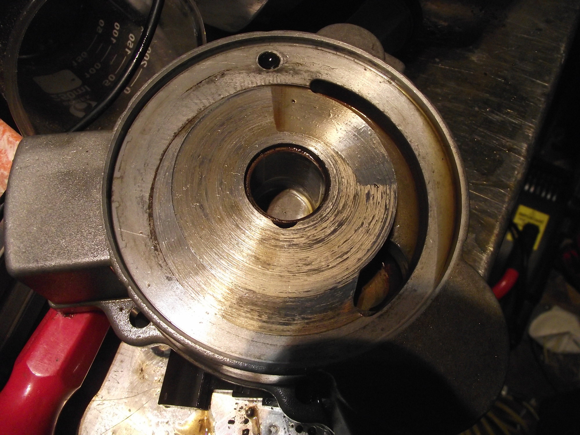

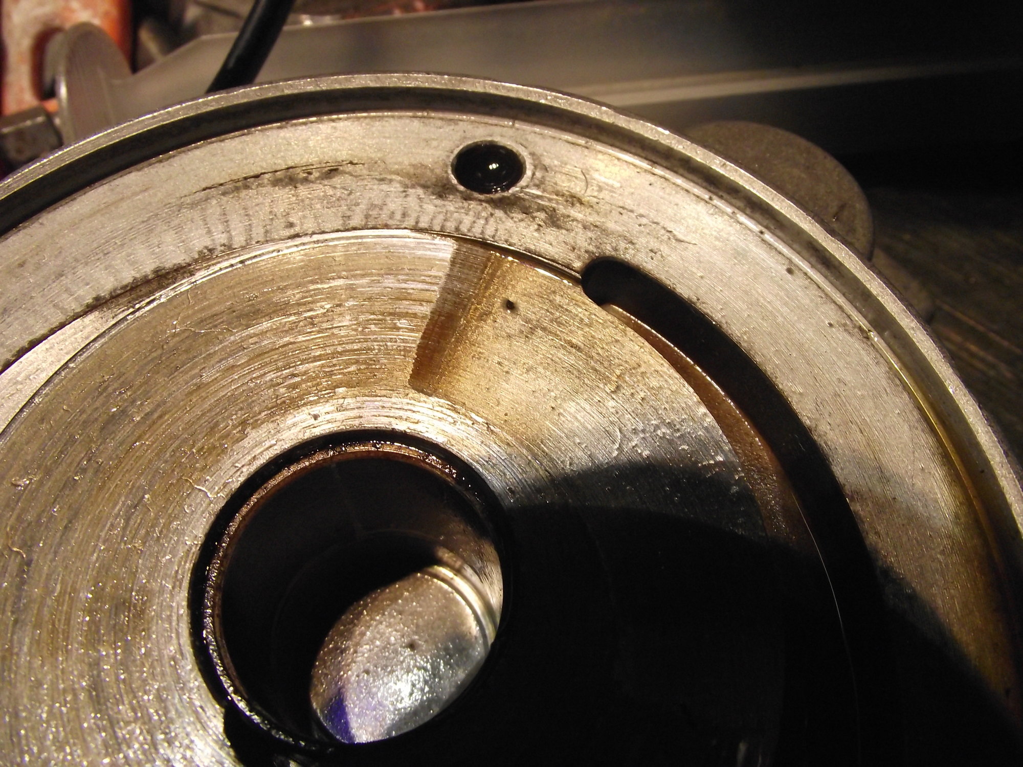

ok, so that could be machined out a few thou to get it smooth again, but!
the ally end cap (part 75686) has been a little chewed by the ends of the vanes as well. Again, I could get this skimmed flat, and I guess I would have to shorten the body/vane-holder rotor as well as the vanes by the same amount.
Before I embark on this rather costly excercise, I was wondering if any experts out there could give me a nod of approval or tell me straight that I'm way too ambitious/stupid and I should wait for another one to come along.
It's just so nice and quiet!
Thanks
