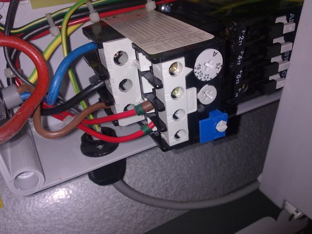

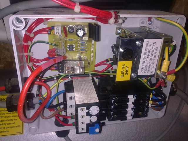

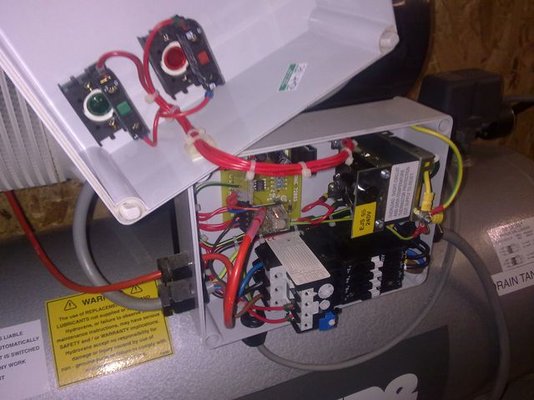

I have a Hydrovane 502 Single Phase 2.2Kw Motor that was working fine until a fuse on the supply blew (due to being too small).
The supply has been upgraded now but now the contactor won't lock on (otherwise the compressor seems to run fine while the start button is pressed)
From the manual (http://www.compaircal.com/V01.pdf page 46/47) I seem to have the "02 Single Phase (PUTS) Starter" which has an overload device connected to the contactor.
Does anybody know if the overload protector has tripped?
The overload protector is set to 18Amps (start load of the motor is up to 16.0 to 17.5 Amps) and it is also set to Manual with the blue sort of button is sprung out with it's pointer pointing upwards to R
A picture of it is attached
If it has tripped then can it be reset? If so how?
Or is there another problem?
Thanks
