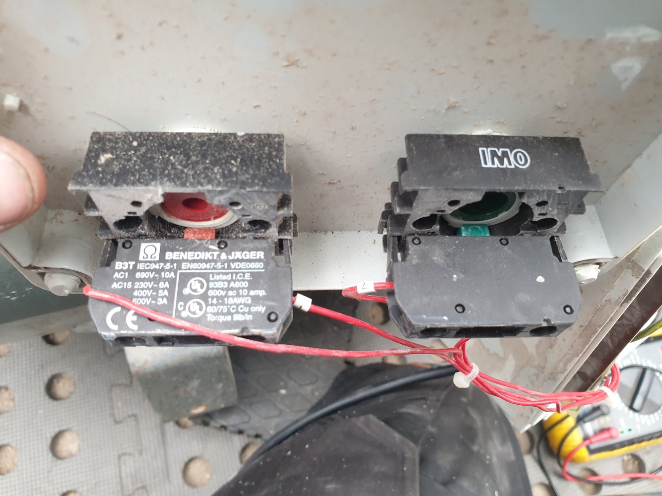

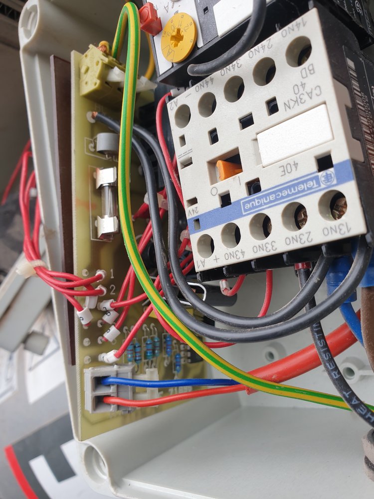

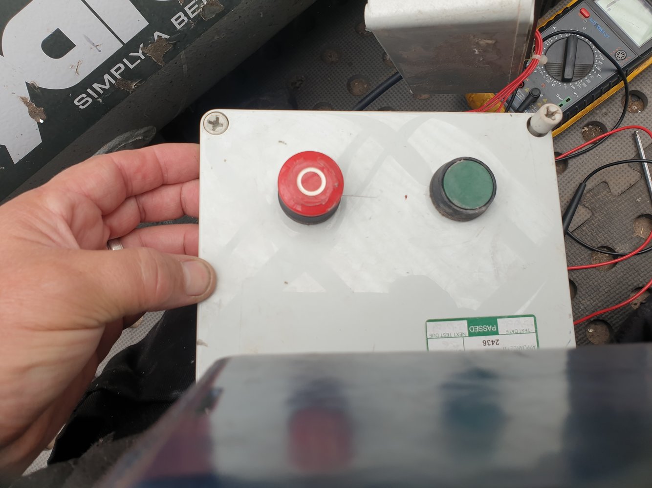

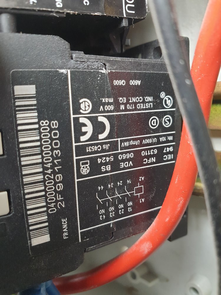

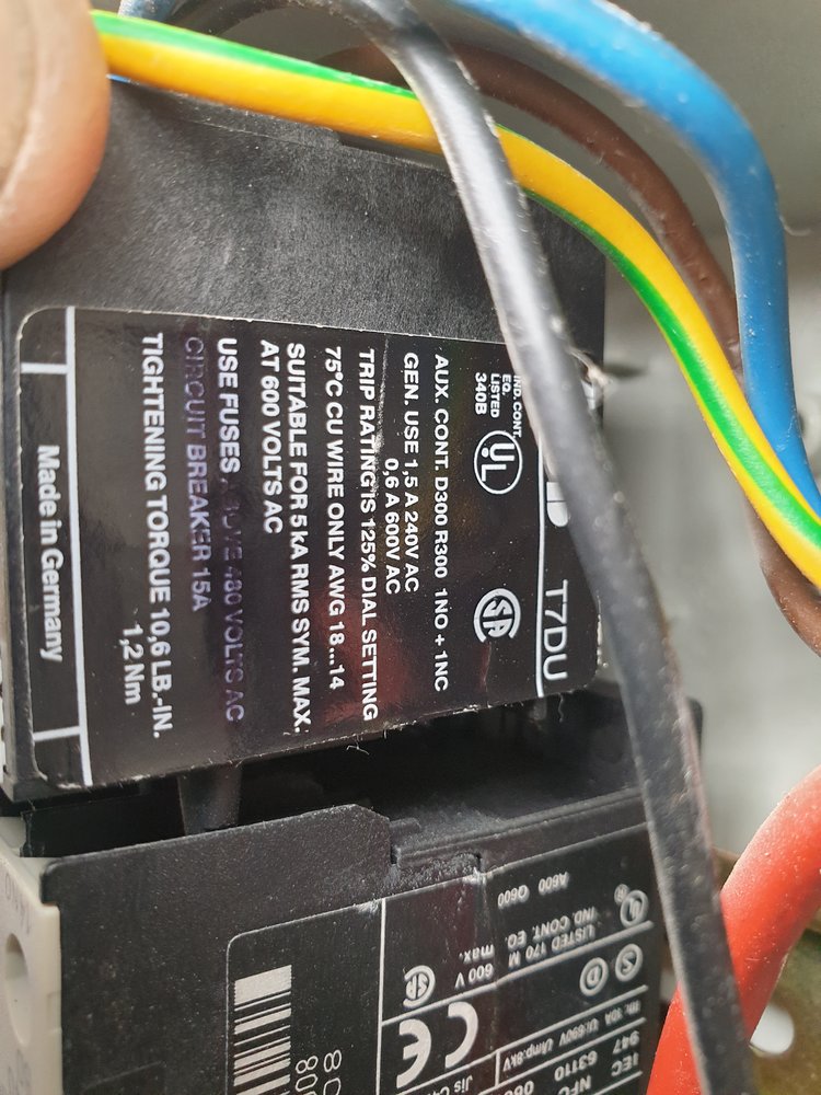

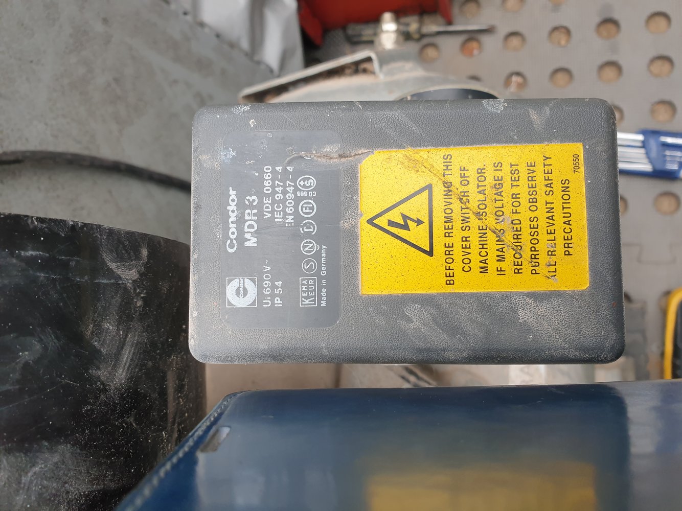

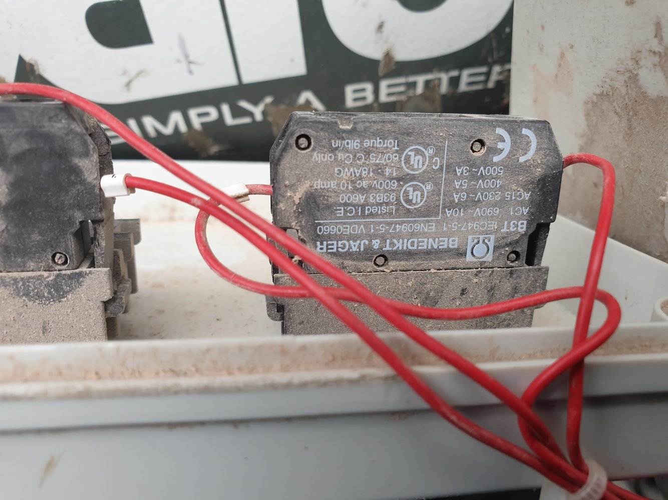

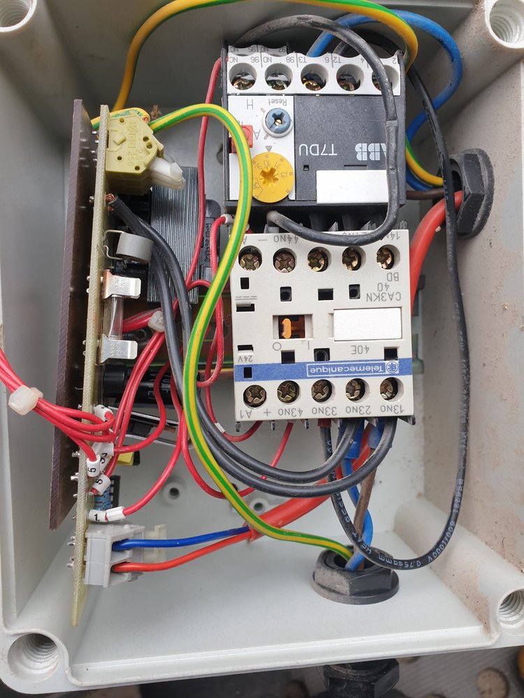

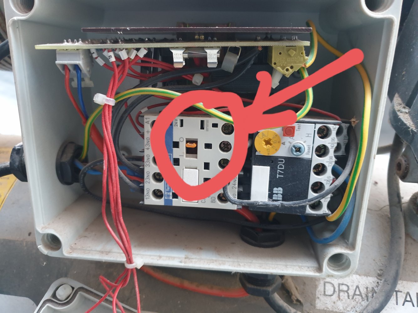

Hi people first of all thanks for letting me on site. I'm hoping for a little help to stear me in the right direction. I have a hydrovane 501 240v with a starting issue. If I press the green button nothing happens. I removed the cover and a wire was out on the stop switch. Replaced the wire and still no joy. If I push down the small tab circled in red it runs, however only when holding. Soon as I let go it stops.
Anyone have a idea what to test or have even had a similar problem.
