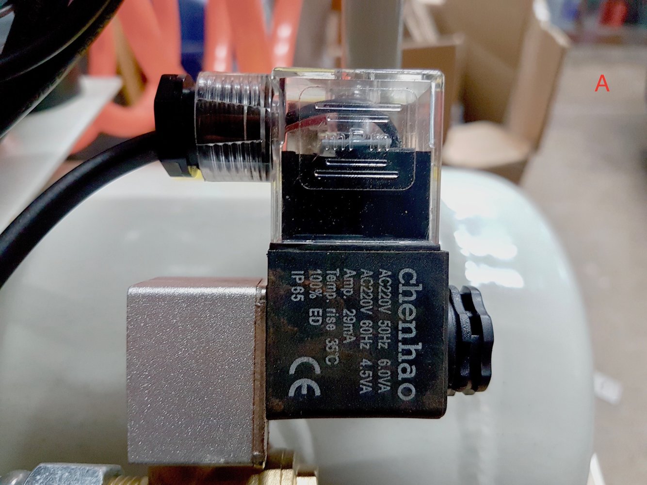

Bought this off Amazon as a used/returned/refurbished unit at a knock down price so I sort of knew it was going to have some issues and I wasn't disappointed. Slight air leak. However, it did the various jobs that it was bought for and it's only now that I want to fit a pressure regulator that it needs to be fixed.

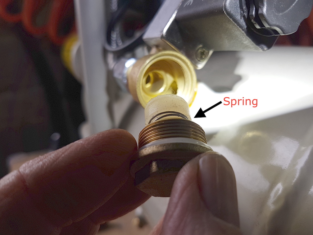

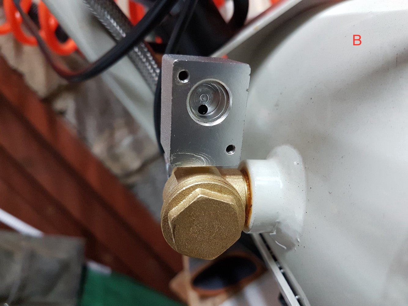

It fills up the tank to the required pressure but when the solenoid switches off it very slowly leaks through the plastic end cap in pic A. It seems on closer inspection that the solenoid shaft (C) when release by the deactivated solenoid, doesn't cover the hole, to the tank, in the housing (B). Is there a rubber stopper missing from the end of the shaft or am I barking up the wrong tree?
