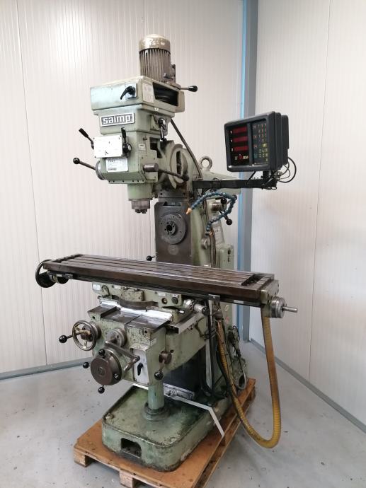

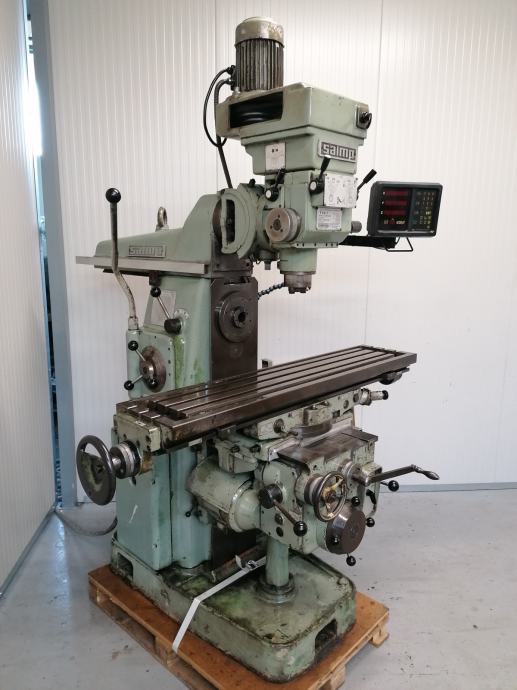

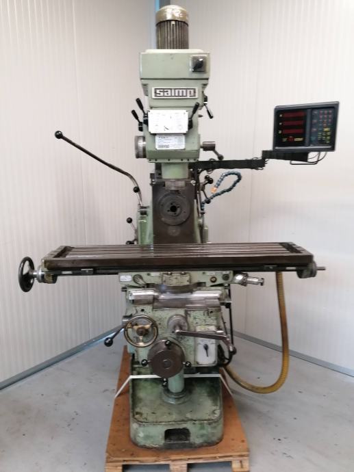

That will be fine - its got Luigi's trouser belt holding it on!Looks very nice.
Don't even try to move it on that pallet or it will fall over!

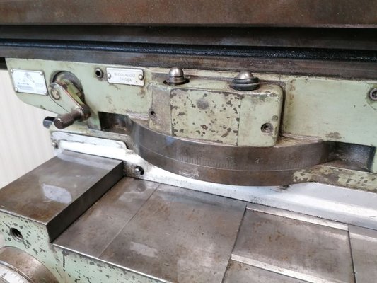

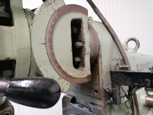

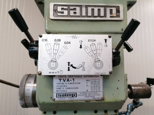

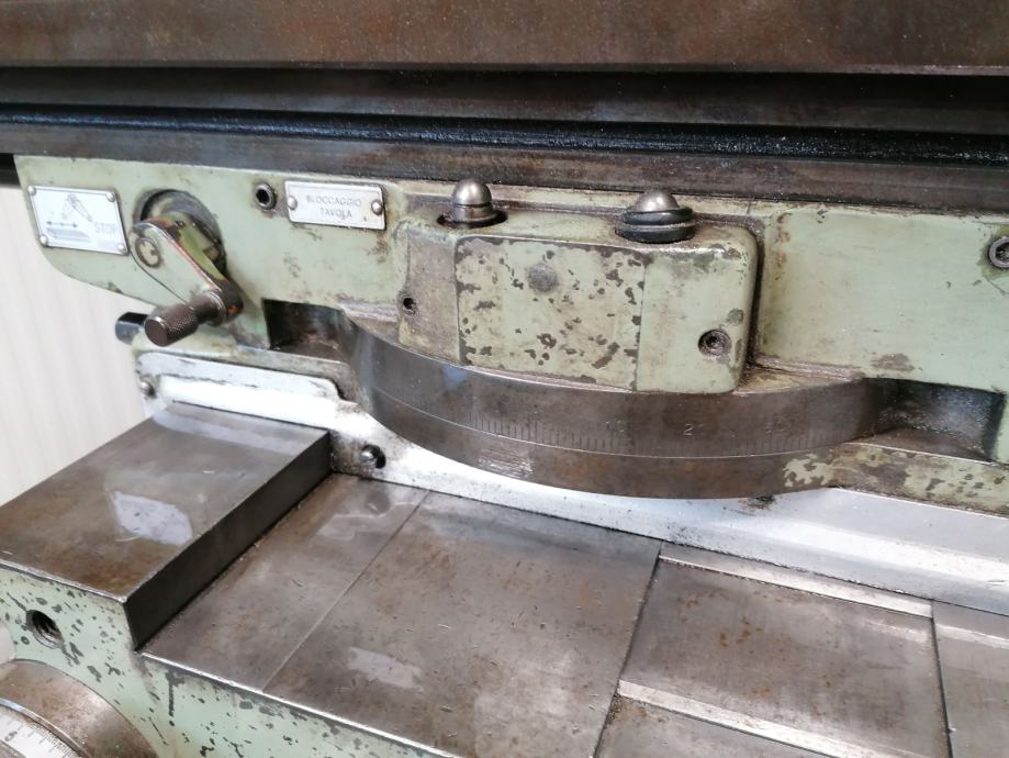

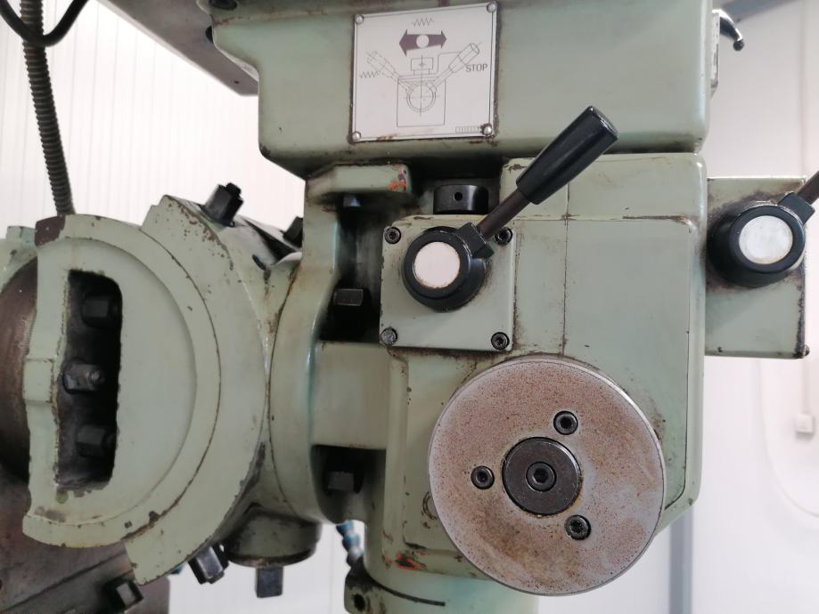

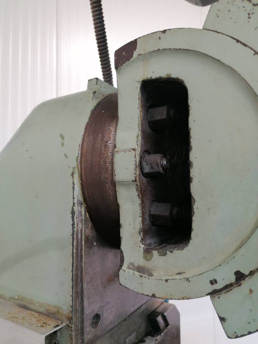

Alas, the ad doesn't mention rigging. An earring (ear) for a horizontal shaft and the shaft itself can be made. I don't see the tilt adjustment of the table (sinus?) The head can be tilted in two coordinates, as well as forward. At the table, I see a scale, like on a lathe support.Make sure it has the necessary support for the horizontal arbor included.
Not one I've seen before. A google suggests decent quality but no spares once machines get older than 10 years old from the manufacturer means you're entirely reliant on machines being broken up for parts and fairly limited numbers vs other machines may make that tricky. So assume no spares and make sure you're happy with the level of wear and everything functions. You may find some interchangeability with bridgeport machines however, looks a very "bridgeport" head.

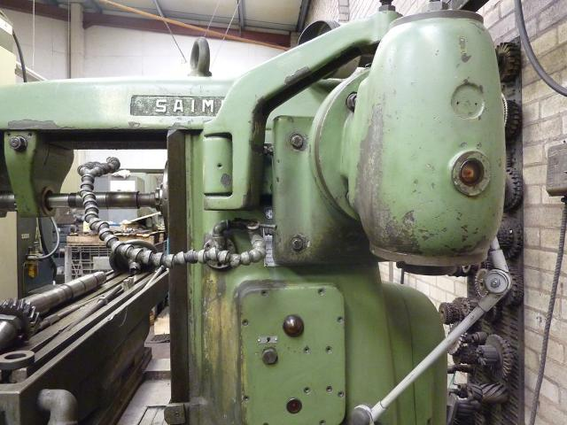

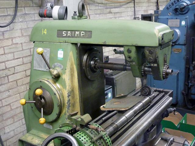

In the last photo, the model is around 1962. On my version of 1970. Oh, hell, 52 years have passed unnoticed, the mill is a little younger than me, but it looks good on the outside and has not been repainted.Here is his brother

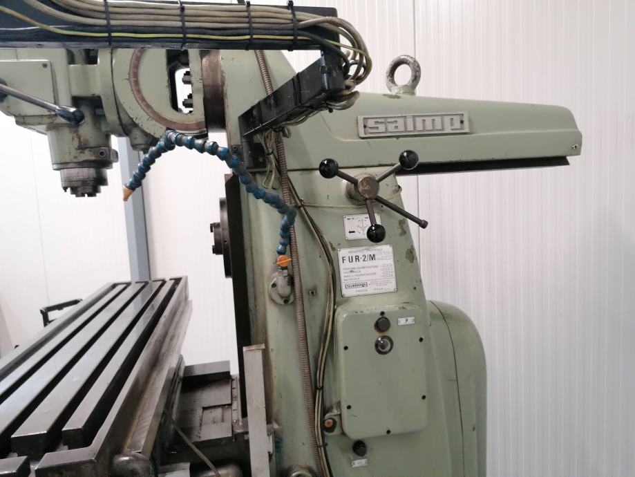

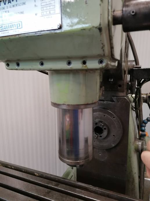

Its a similar setup to the Harrison but with a separate motor for the vertical on the top slide rather than using the horizontal spindle. Makes it heavier but more travel and versatile. Downside I'd presume being two motors as well...but if you don't have a horizontal arbor you may be ok to pretty much ignore the horizontal one. Looks like they did a similar one with a horizontal to vertical head as well. As well as a version which is more of a bridgeport design. View attachment 362964

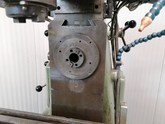

I quite like the horizontal/vertical setup....but with no arbor and bearing the horizontal is pretty useless apart from maybe using it as a normal spindle at 90 degrees to the vertical one (which can be useful sometimes).
I'd assume arbor/bearing should be something like this
Anyway, very little info on it. Buy entirely on current condition.
In the bronze bearing, you need to make a pocket for oil. With wick or oil cavity with stopper. But first, I'll go and see it. I have a small 40 cm granite slab, two spirit levels 0.02 mm / meter and sets of probes.Its Taiwanese close relative is discussed here: https://www.mig-welding.co.uk/forum/threads/so-i-bought-a-mill.120062/
The head seems to swivel both behind and in front of the nodding mechanism.
Would you not just bring the ram fully forward and use that as the overarm, with a drop bracket on the dovetails as outboard support bearing? See, e.g. https://easson-vertex.com/product/vertex-horizontal-milling-attachment/ without the right angle gearbox. The drop bracket is not hard to make as you make the dovetail clamp and bore the bearing on the machine itself, so it cannot fail to be aligned correctly.
The drop bracket is what I meant. Unfortunately, the way my mill is configured I have to remove the vertical head to install the bracket..................................... Would you not just bring the ram fully forward and use that as the overarm, with a drop bracket on the dovetails as outboard support bearing? See, e.g. https://easson-vertex.com/product/vertex-horizontal-milling-attachment/ without the right angle gearbox. The drop bracket is not hard to make as you make the dovetail clamp and bore the bearing on the machine itself, so it cannot fail to be aligned correctly.
If it's for Saimp machines, I'd love to see those manuals! How can this be done? Often, time-tested solutions for machine tools (original solutions) could be reproduced for decades, from model to model.There’s a couple
Of manuals on passion usinage but not sure they’re 100% your machine

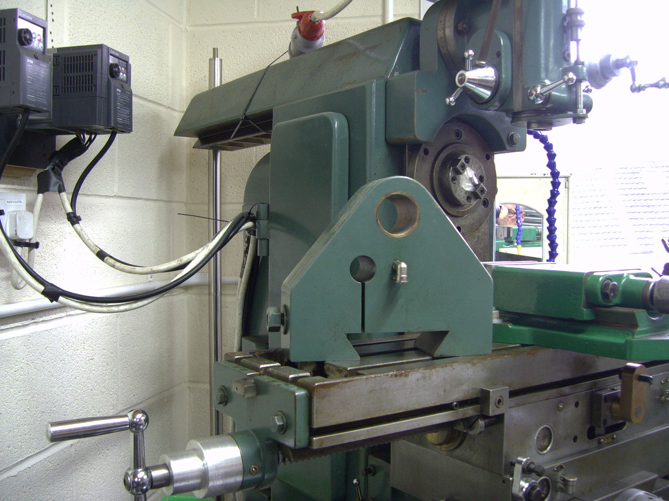

From the planned initial 24 meters, the new workshop will grow to 42 m2. Plus, the second floor is 18 m2 for an electrician. We will have to move another 6 m3 of crushed stone and asphalt and move the place of the foundations to another place. And there will be a place for a one-armed crane with a lifting capacity of ~ 500 kg and with a long arm of about 4 meters. He will be able to serve both a lathe and a milling machine. Im just need to do it, period.The drop bracket is what I meant. Unfortunately, the way my mill is configured I have to remove the vertical head to install the bracket.View attachment 363003

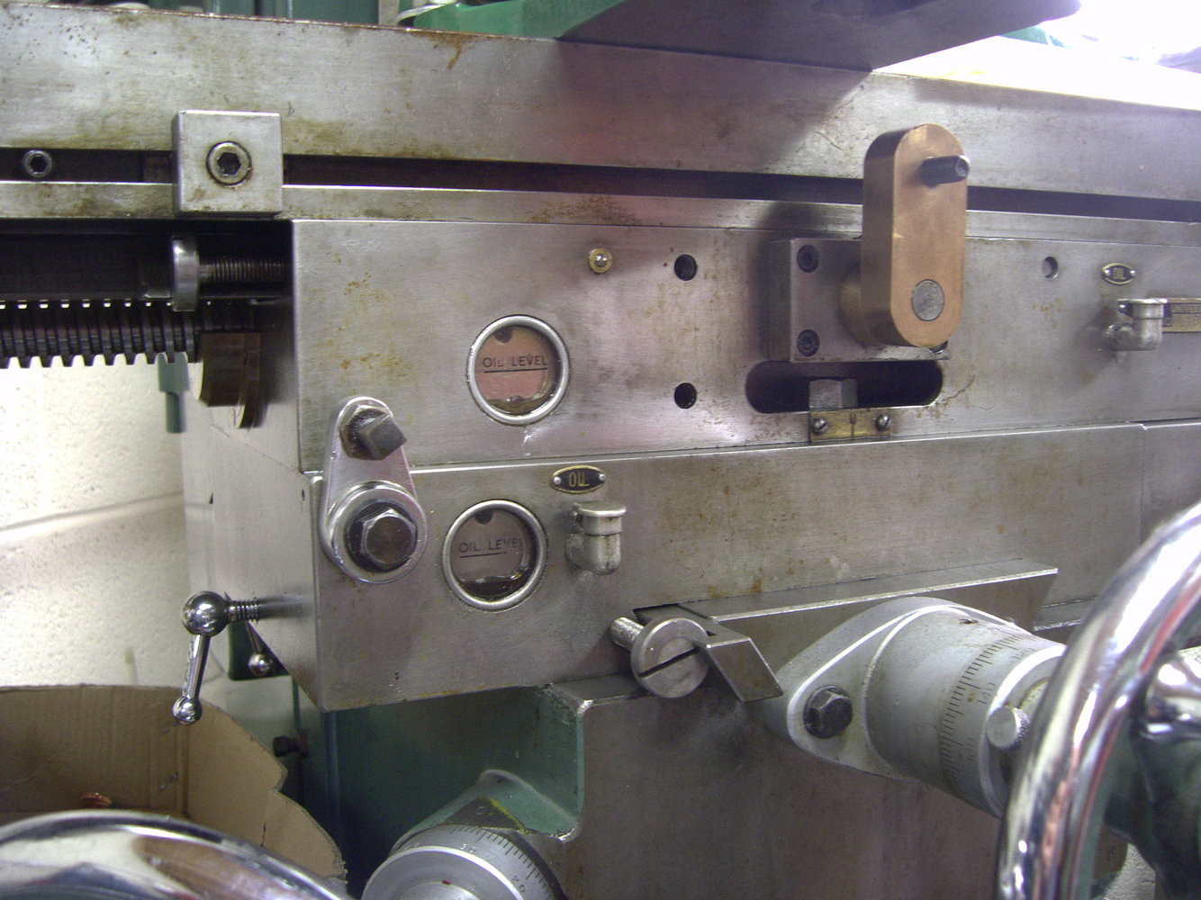

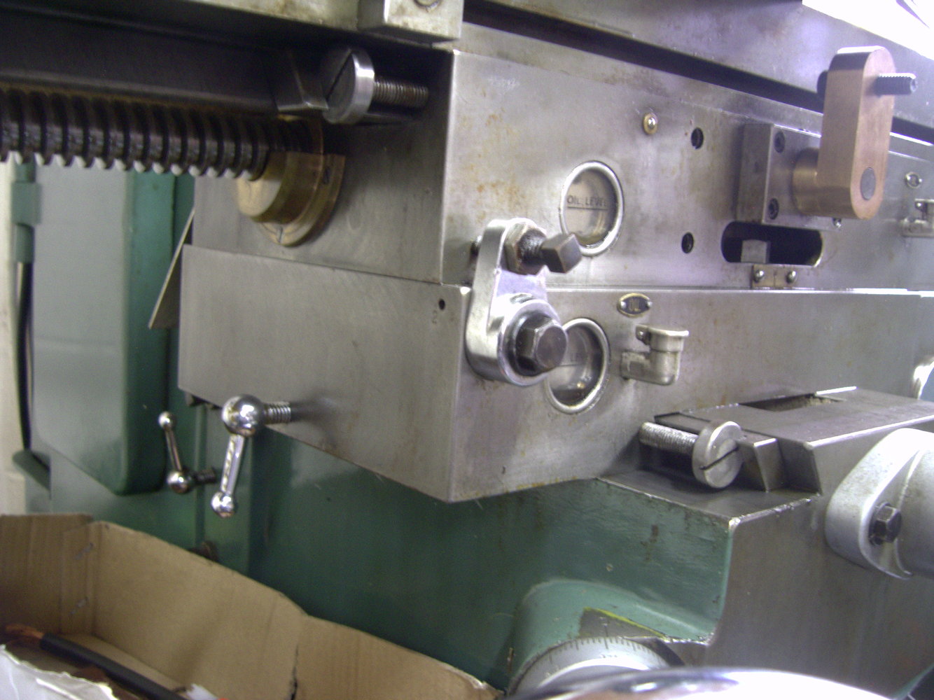

There is such a photoI have a smaller universal mill where the table has the capability to swivel. You can see this by the locking nut in the center of the table and the brass indexing plate. Also the double oil gage and the adjustable centering stop on the left. The stepped appearance on the table mount attached to the knee of the machine in your picture is a bit blurred, but looks like it has this feature ?View attachment 362998View attachment 362999
