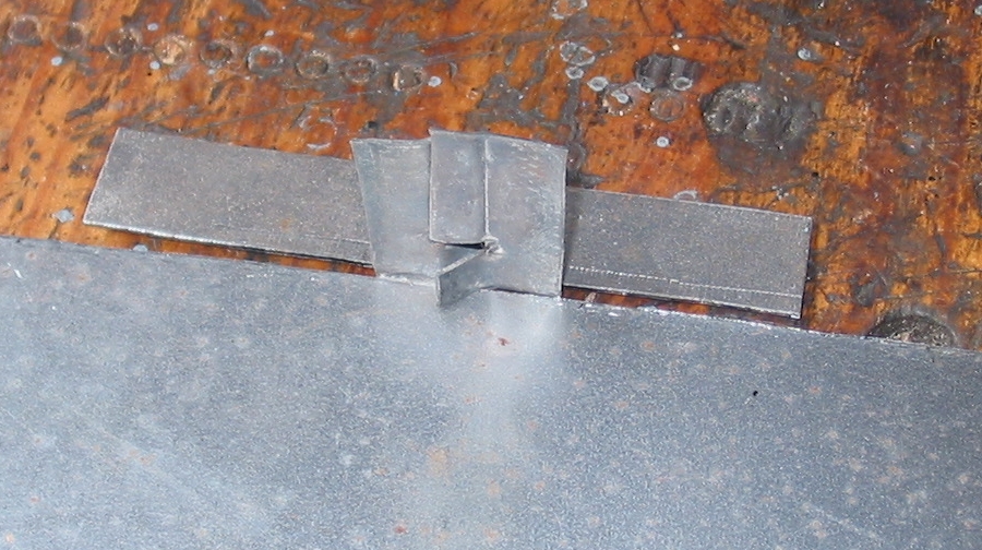

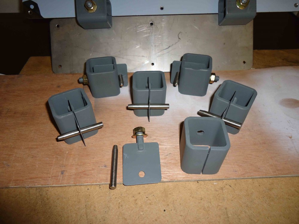

around 10 mins each including the planning ...
Snap, square box section.
Stan

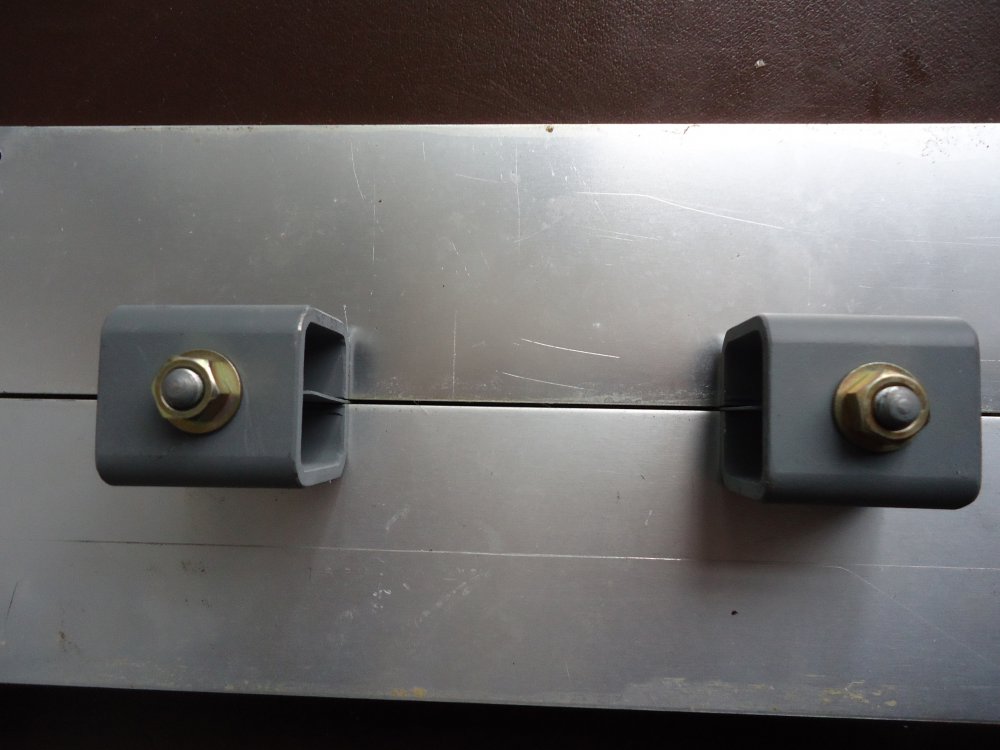

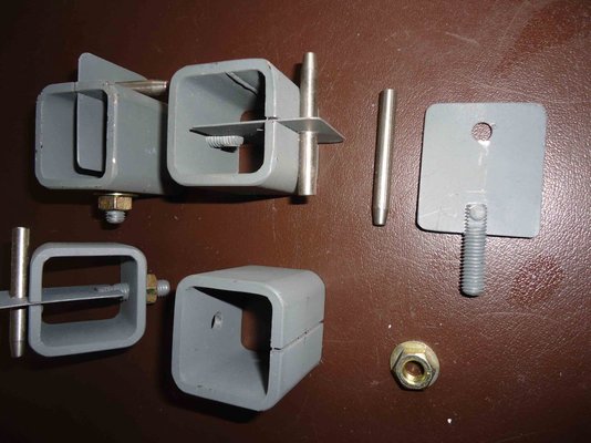

Plus wingnuts means you don't need a spanner to set them.
If you cut a shallow slit in the pins you will find they are less likely to slip out while positioning esp when reaching round a panel.

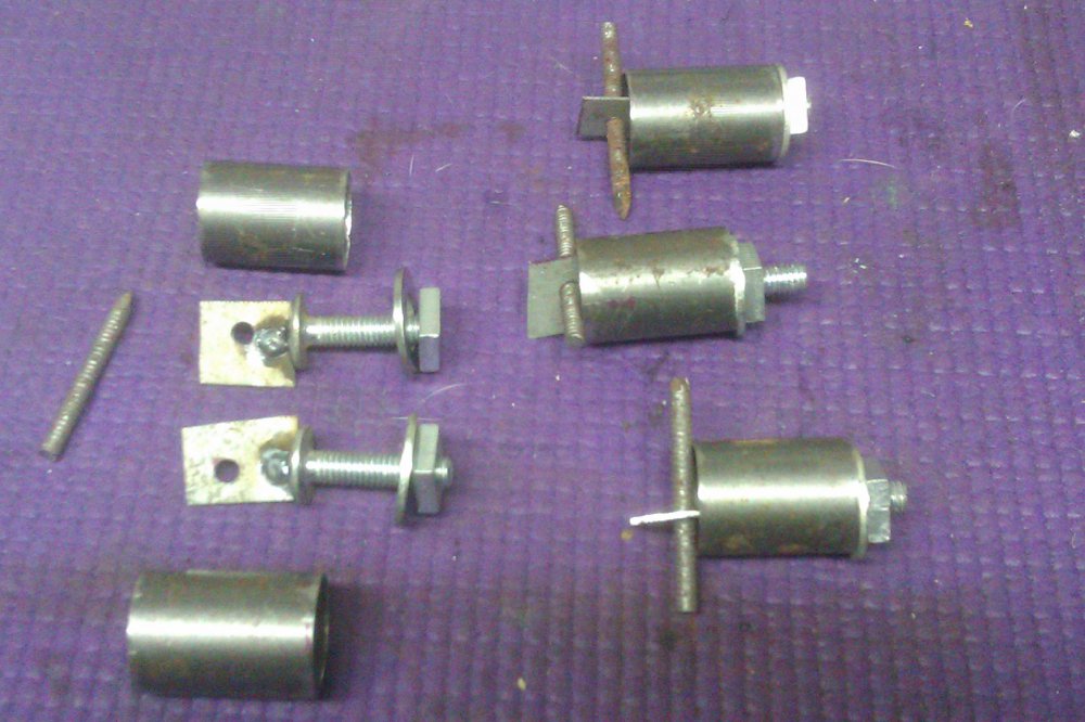

Just made these the other day;

You get them copper plated and they stop your camel getting up the stick?[SIZE=4][B][URL='http://www.mig-welding.co.uk/forum/members/tinman123.12779/']tinman123[/URL][/B][/SIZE] said:are they stops for something, slide it over a square or round bar and twist to 90dgs.
