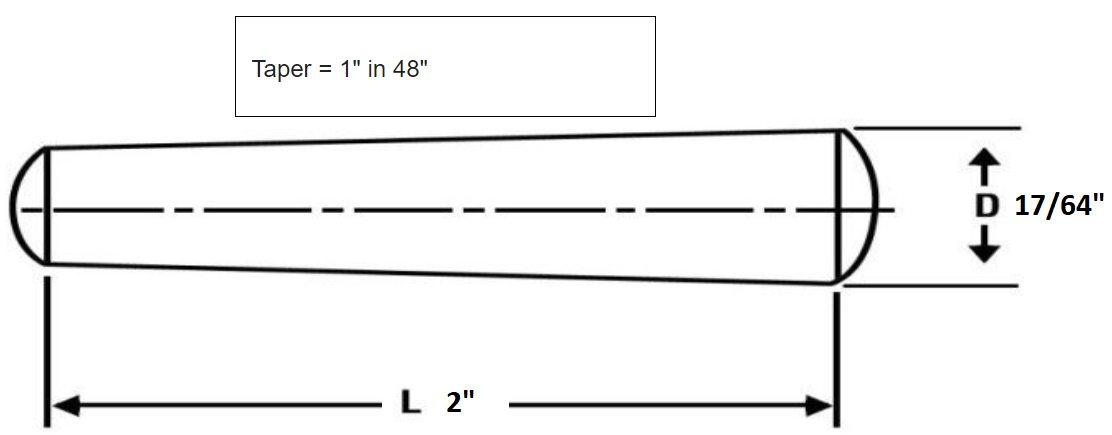

I did wonder that Seadog, 1/4" x 2" is a pretty standard size. 17/64" suggests an over-Are you certain about the 17/64"? I've a 2" one measuring 1/4" at the fat end.
reamed hole!
6mm will be too small...
Good thinking that man!A 6mm x 50mm metric one would be the closest to the size you quote, roughly 12 thou' bigger throughout its length, but would need a very light ream into a 1:50 taper.
