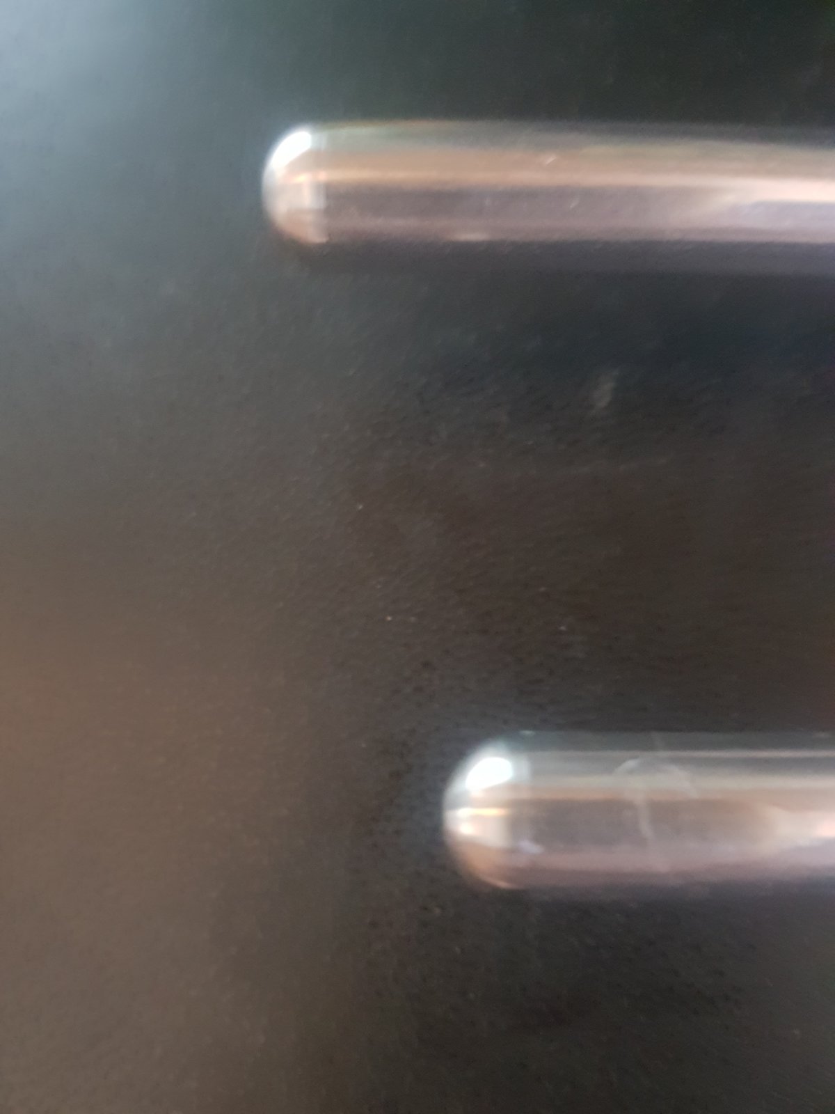

I have some 304 solid round bar, about 10mm OD.
I want to put a dome / half sphere finish on one end.
The bars are about 1500mm long and already have something fixed to the other end.
So far I have got a decent finish by clamping them in the vice and having at them with a flap disc then going over with a horseshoe rasp then a file then a buffing wheel then a polish. But that is not that quick to do.
What I want is a tool I can buy that will do this for me (for under a couple hundred £)
Failing that, I thought if I can find the radius inserts or a carbide cutter shaped like that I could mount them in a router or something and drill a guide hole through a block at 90deg that I bolt to the router then set it spinning and either clamp the bar and feed the tool onto it or clamp the tool and feed in / rotate the bar by hand.
I would prefer a rounded end as they are locking bars that engage under spring pressure into a plastic retainer so a rounded smooth finish will help with wear on the latch plate.

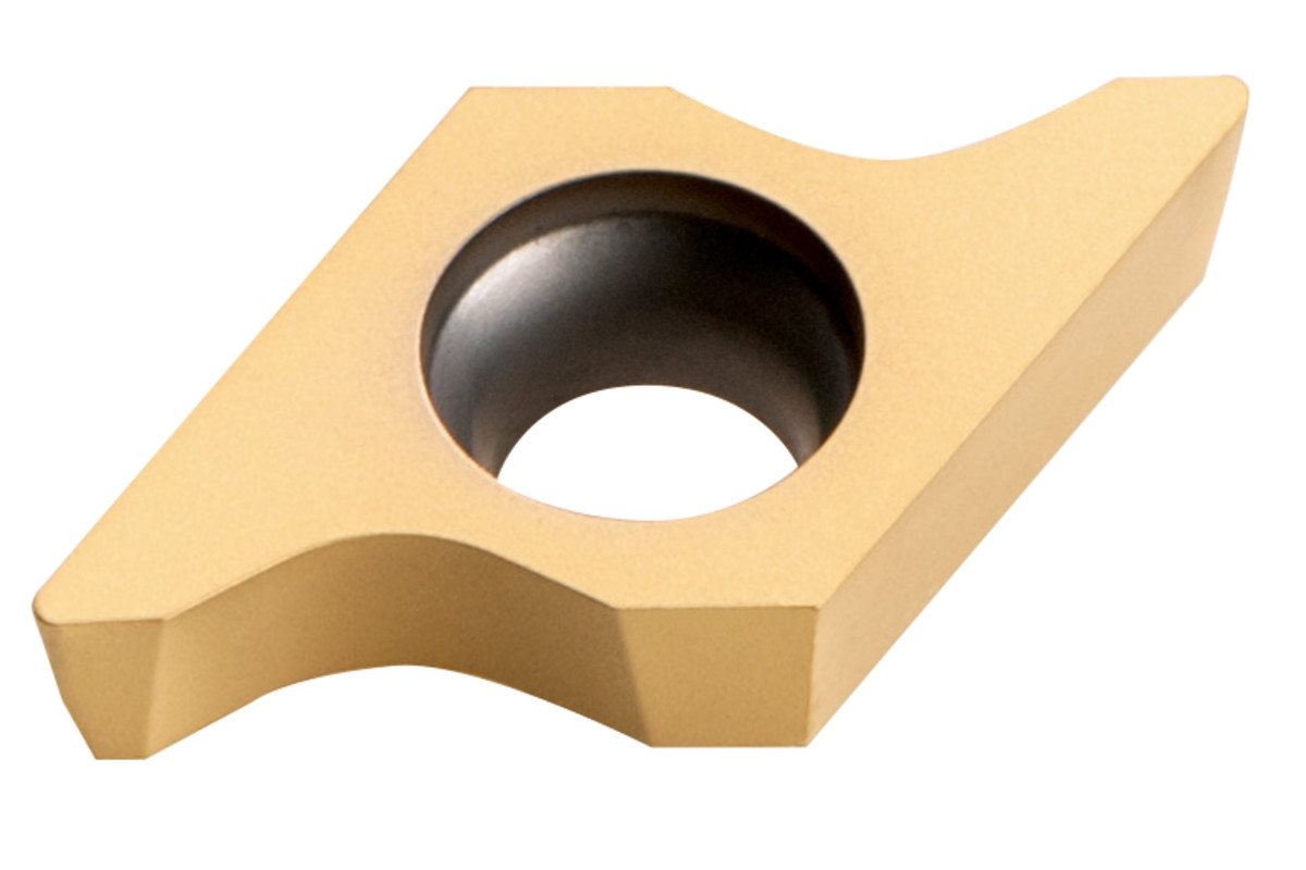

If needs be I could get away with a cone/taper on the end of the bar (using the type of cutter @500e has put in the pic above) but i think i will then be looking into having metal versions of the catch plate custom made instead!

Make a high speed form tool or super hss or if you have any old cobalt or stellite hss tools (far better than the modern versions) Grind by hand on a bench grinder then stone. . The tool will last very well if looked after and ground correctly. Use a piece or bar of the rad you want as a gauge, in this case the original material you are machining. An hour and a half and its done. Failing that get a cutter grinder to make you a form tool, Its common practice in the trade.
Edit: I didn't read all the replys, but assumed you were doing this in a lathe looking at the original tools you wanted... lathe is the way to go really, I think you mentioned routers this will not end well at all and will destroy the tools in stainless A burr would be better but a halla messy finish to clean up and will still kill the tools. Lathe is the way to go if you have a few to do for speed and finish.
Only problem with using the lathe is the bars are 1.5m long and have stuff attached to one end so I would have to remove that first then reassemble afterwards.
Unless I mount the tool in the chuck and the bar in the cross slide but when I though about doing that I thought it might be easier to make a tool that I could take to the bars...
