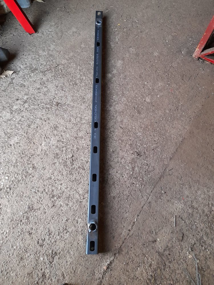

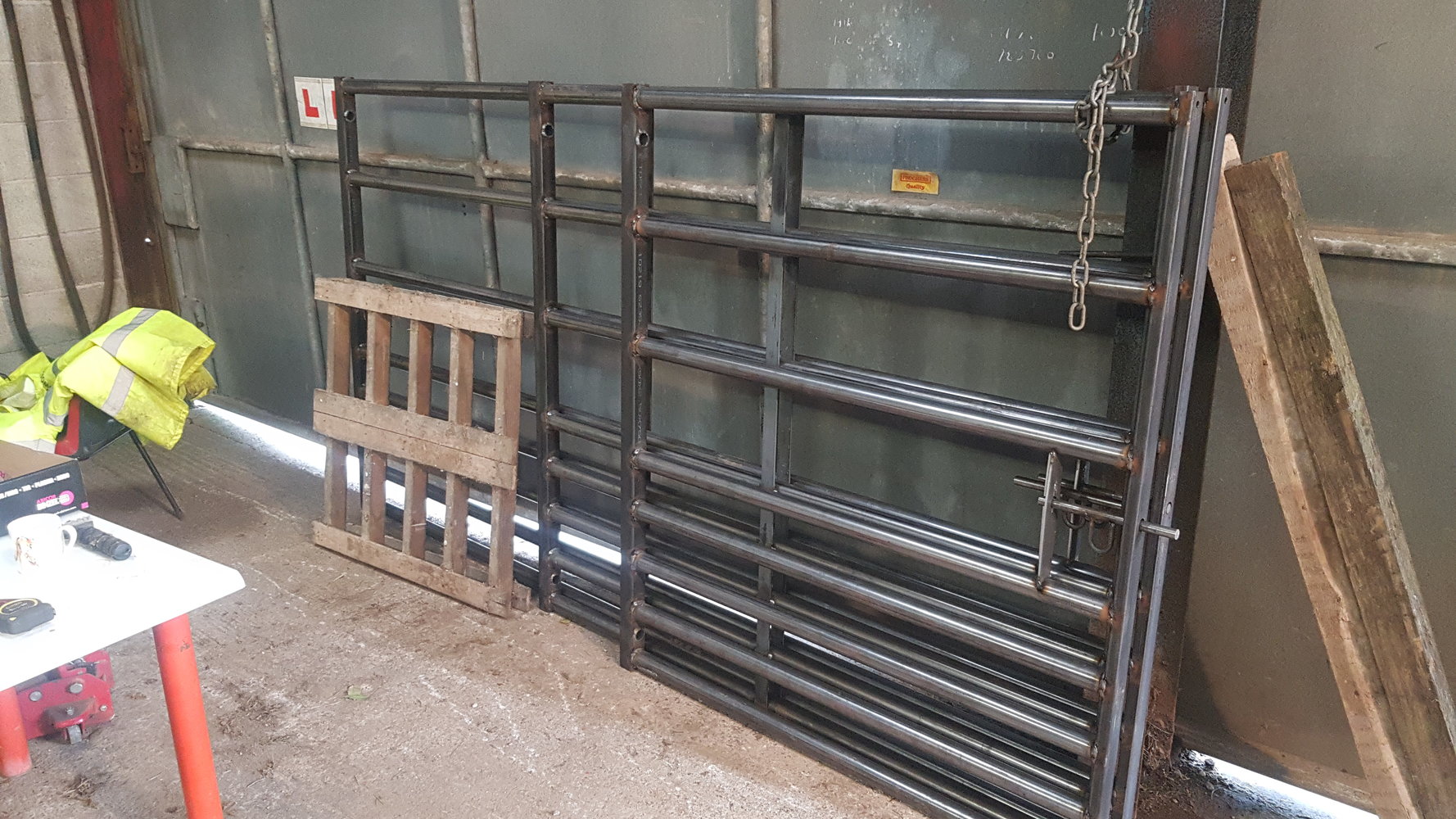

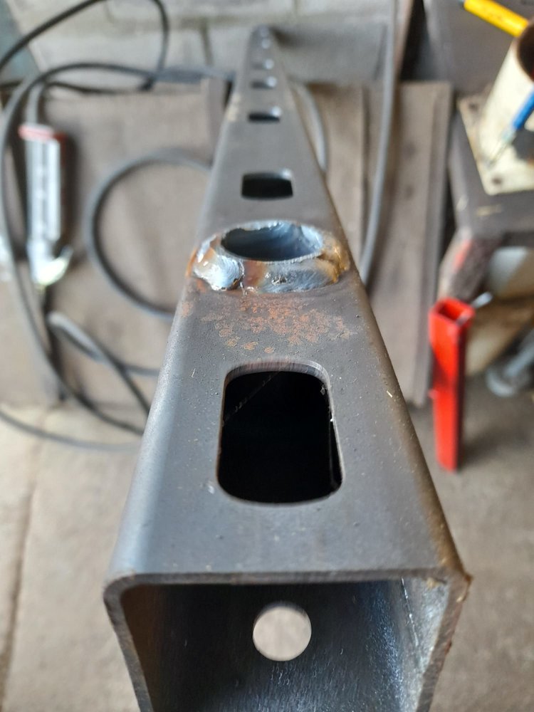

Hi, I've been making some farm gates and have sent them to be galvanized. The galvanizers have come back to me today and said they won't do them because all of the vent hole are not visible. I had all of the vent holes laser cut to nearly the inside diameter of the tube, so I'm a bit gutted. I've sent them pictures of the component parts but are still not happy.
Are they being a bit over sensitive or is it my own daft fault for trying to make too much of a good job? They can't see past the tube I welded in to reinforce where the hinge goes.
