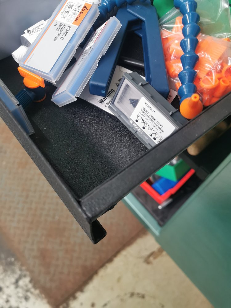

Mipa protect is cheaper and pretty much exactly the same.
I underseal all of the cars I restore with it and then paint over the top.

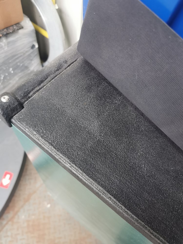

When I buy raptor I get them to give me the tint to add as well but you can also just add your own. Raptor gives a matt sort of finish, over coating gives it a shiny finish and looks closer to the A surface colour.
No worries. Probably a 2 or 2.5mm spray gun would be best at a guess. I've seen others spray it with a conventional guy so certainly can be done. 3m I think might have info on their website.Thank you.
It's more that, with a shutz gun you can't do small amounts and you always leave a load behind.
AND... I won't have a clean container, as you never get one with the gun, as it just assumes you're going to use the product in one hit.
Mix 150 grams and use a foam roller. I have done this many times. And there is no big shagreen. But the required thickness will have to be increased many times. Epoxy 2K primer requiredDo you buy it locally, or mail order?
