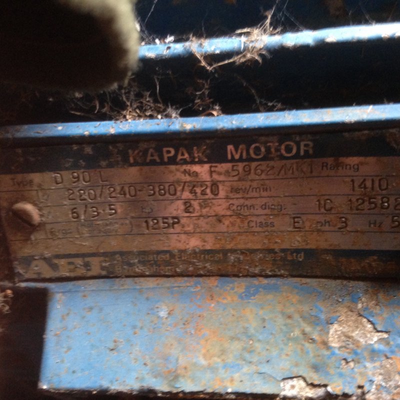

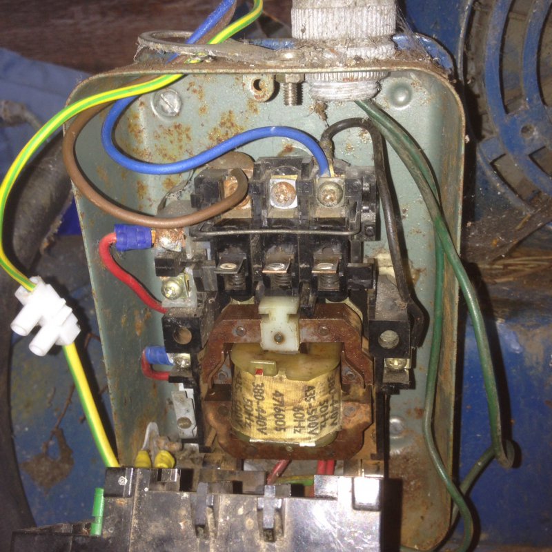

Yes, good spot I hadn't noticed the coil. I only looked at the motor plate!Looks like someone's tried to wire it for single phase. The contactor coil looks like it's rated 380-440 volts, so it probably wouldn't work on 230v.
It is a 3 phase motor but you can run it from a single phase - 3 phase inverter as it has a 230v connection.
But you can't run it from straight single phase.

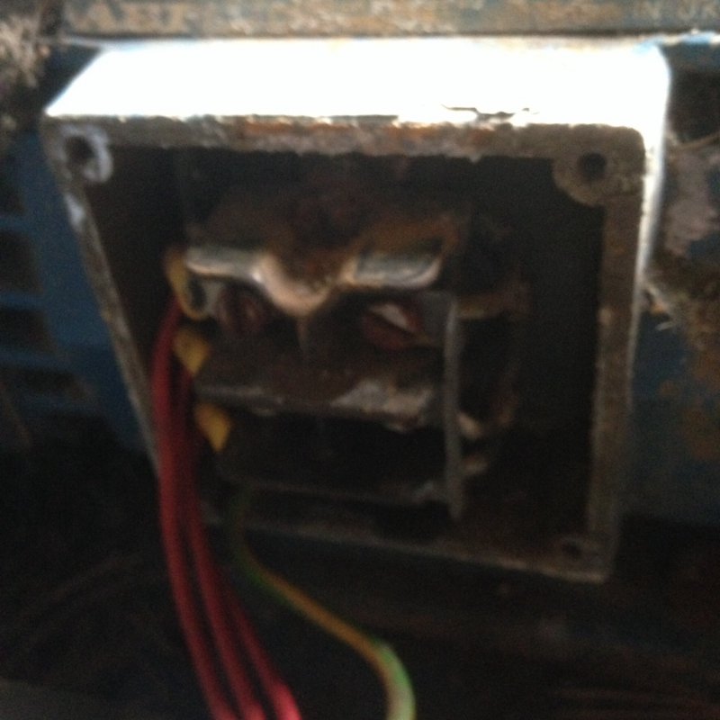

Yes that was me and my dad who is a sparky but hasn't had anything to do with motors since his teens! That is what we saw after opening the cover when the Sparks stopped!Looks like someone's tried to wire it for single phase. The contactor coil looks like it's rated 380-440 volts, so it probably wouldn't work on 230v.
