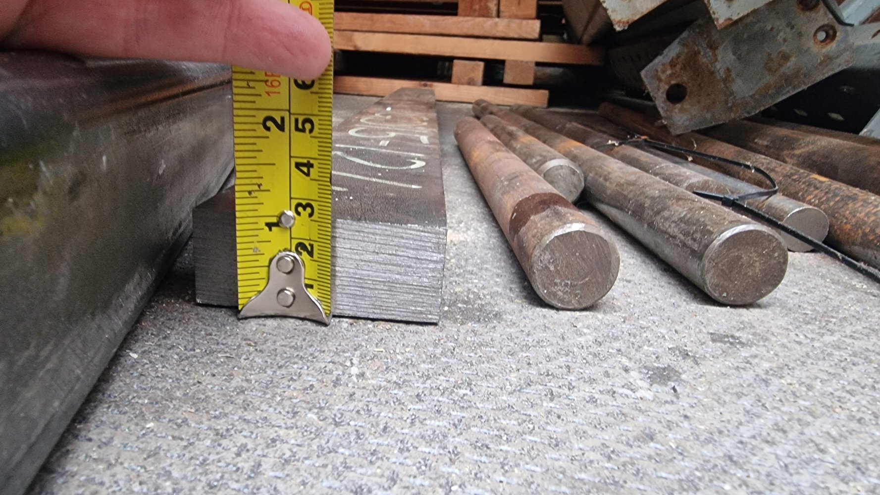

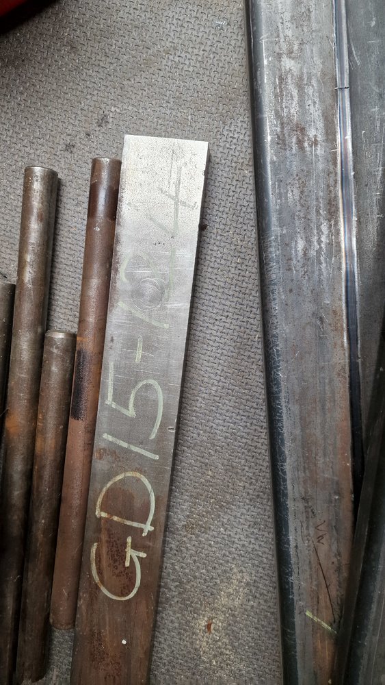

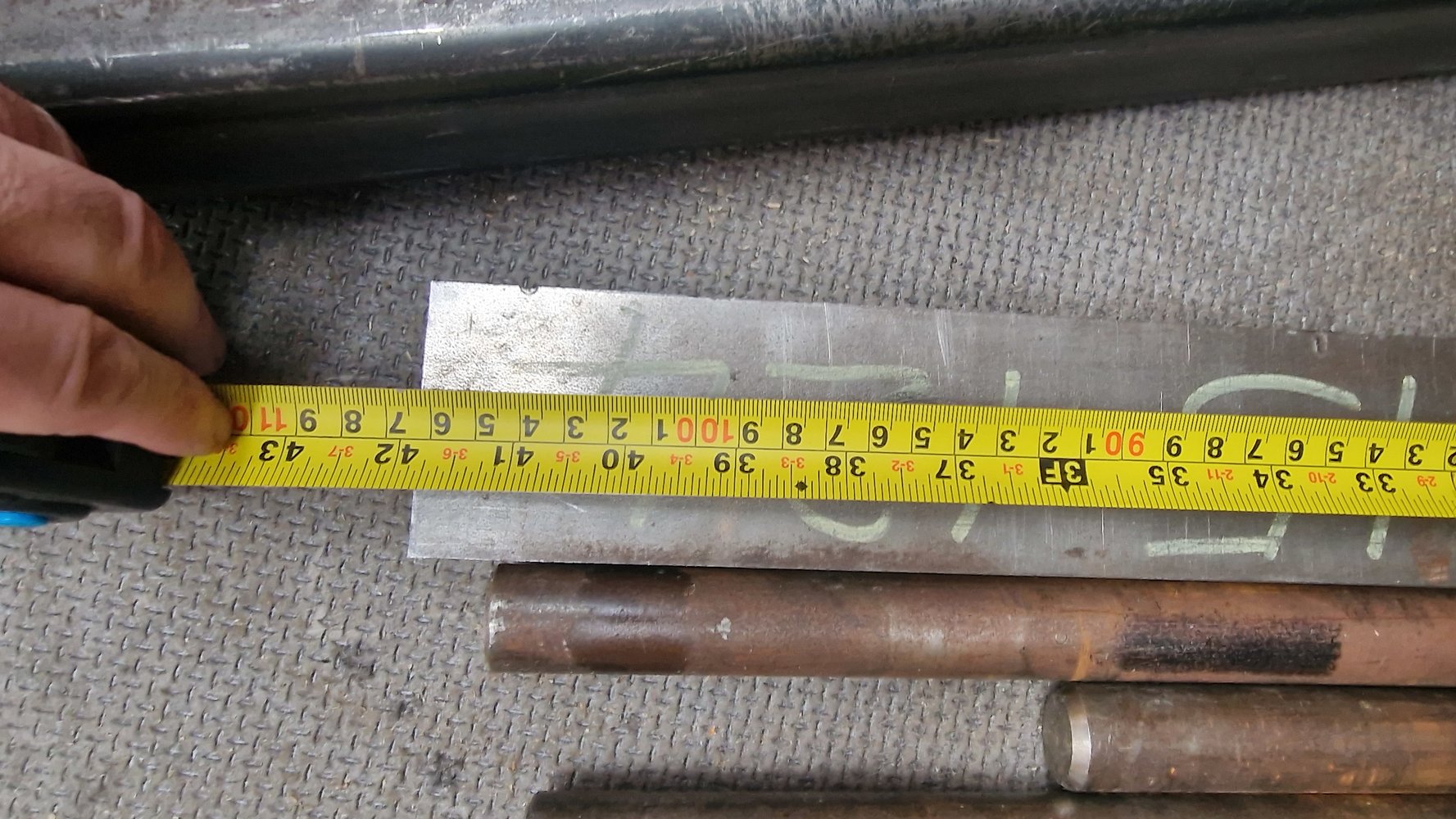

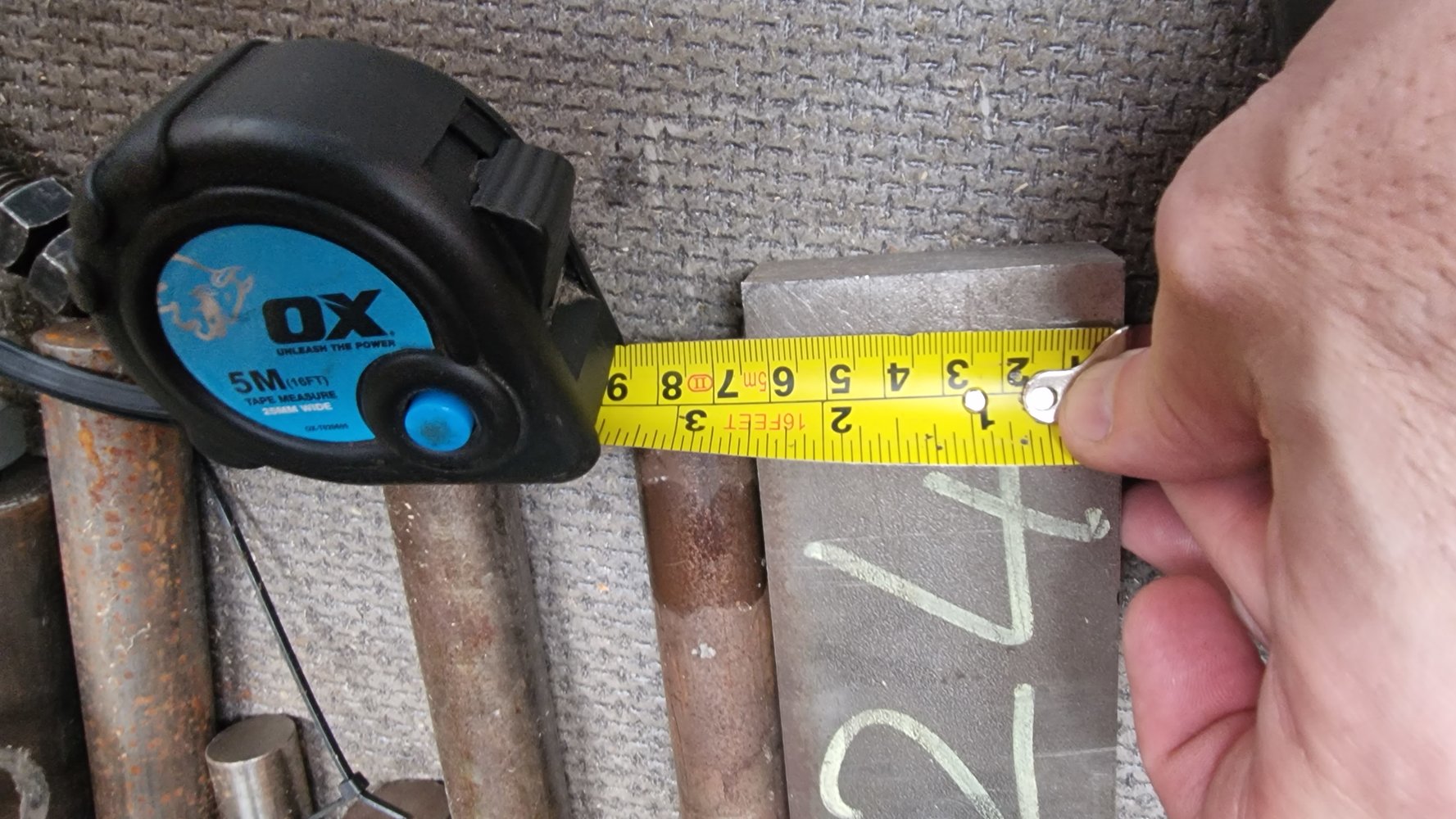

Just been given some steel offcuts. Bought some pallet racking and said I could have some bits and pieces.
The big chunk rings like a bell and can't be scratched. What is it? Bet its worth a bit
I very much doubt it would be HSS. But, nevertheless, worth a good deal more than scrap value!
Could be any one of umpteen steel compositions. Could even be leaded, but I doubt it, unless from an educational establishment. That one piece, at about 13kg, would be parked in a corner on my workshop for use as and when, but I expect shipping might be an expensive extra.
Could be gauge plate, I would cut a sliver off it, get it red hot and quench it, if its a carbon tool steel it will be glass hard, I googled the writing on it to no avail so could be anything.
