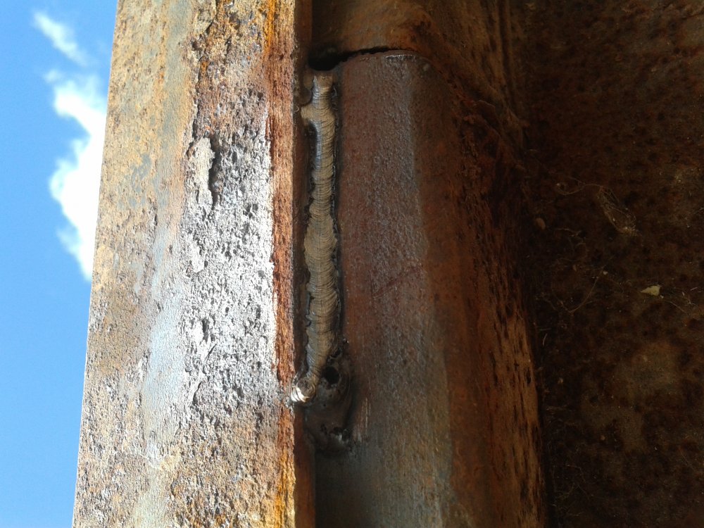

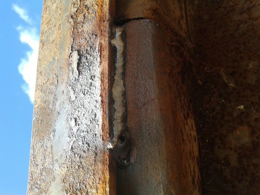

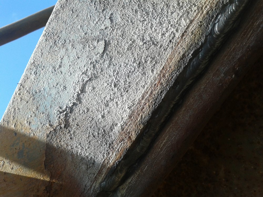

Ok guys let me tink I did above my head but is classed as over head and does it look ok
Thermal arc set to about 110 3.2 esab ok rods ive decided I dont like fincord rods
Fincords are excellent and meant to be multi positional if your using 6013s I take it. It is lacking fusion in a lot of places you can see. Would help a lot of you cleaned the material with more than a wire brush!!
That would be classed as a vertical weld. It doesnt matter how high above you it is, its always classed as vertical. If you butt two pieces of plate together and weld them without moving them, when you weld the top you have flat position, then whe you weld the underneath without turning it over, the underneath is overhead.
