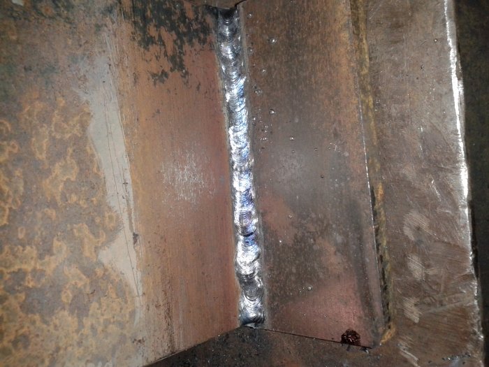

D davidjohnperry a different breed Messages 2,493 Location yate/bristol Jun 23, 2013 #1 Just finished welding a tee fillet 85 amps 2.5 murex rods what you guys think Hope fully it shows improvement

D davidjohnperry a different breed Messages 2,493 Location yate/bristol Jun 23, 2013 #2 Dam its the wrong way round could some one please rotate it 90 degrees right thank u
Badger1bear If your not on fire, then your too far away Messages 2,218 Location kent Jun 23, 2013 #3 any good for ya ?
Badger1bear If your not on fire, then your too far away Messages 2,218 Location kent Jun 23, 2013 #4 Its not bad, it is getting better. I think you need to work on keeping your travel speed constant and distance to work piece from the tip of the electrode, if need be steady yourself against your other hand

D davidjohnperry a different breed Messages 2,493 Location yate/bristol Jun 23, 2013 #5 Thats sound mate I understand what u mean to
