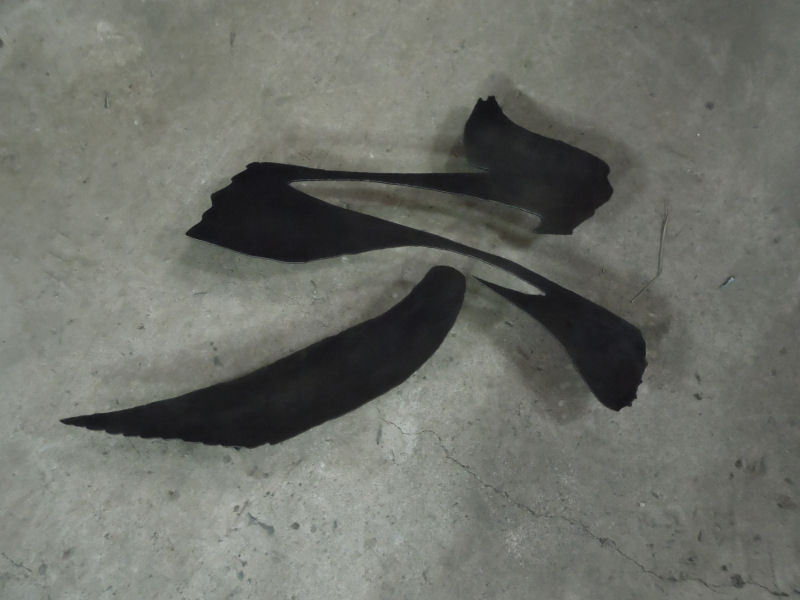

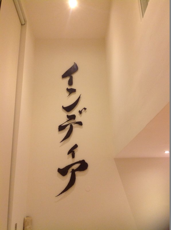

My customer asked for his daughters name in traditional calligraphy cut out of steel to fill a space 2.7m tall.
He had the calligraphy done by hand at considerable expense.
I scaled it up with my OHP, and by about the third attempt we were both happy.
I cut it out of 3mm mild steel sheet, cleaned it with citric acid, cup brushed it to give a slight surface texture then treated it with gun blue before drying it and coating with Jade Oil and leaving that to cook for two days on a radiator.
They are mounted using Through bolts and stand about 40mm off the wall. I made a jig to get the spacing correct.
Both of us are happy chappies with the end result.
