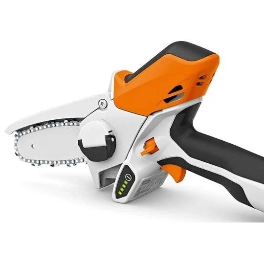

I got one of these, mostly for pruning small bits and cleaning vine/ivy while climbing.
Note its a left handed, theres no chain brake and the oiler is a manual plunger. The tool-less chain adjuster is in the chain cover, which is rubbish! Its a pain to get the cover back on.
Weight 2kg dry without battery.
It is single speed switch, which is a bit rubbish for a brushless tool. Knowing its a left handed tool... They cocked up by fitting a right handed safety switch
If I keep it, I will add a second switch to prevent accidental starts.
I'll be using Lidl batteries one I wire up another adaptor, so havent given it a proper test yet.
