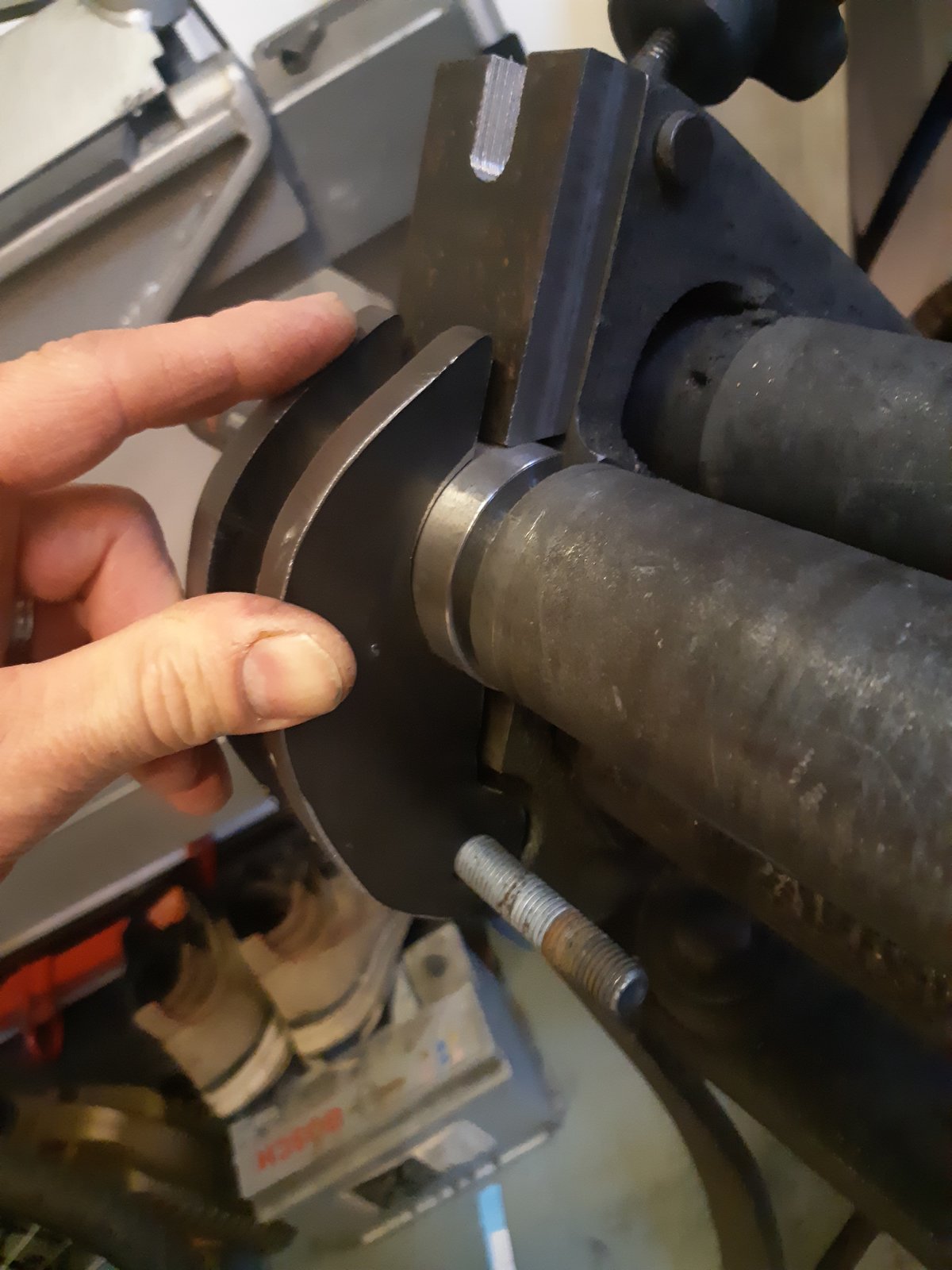

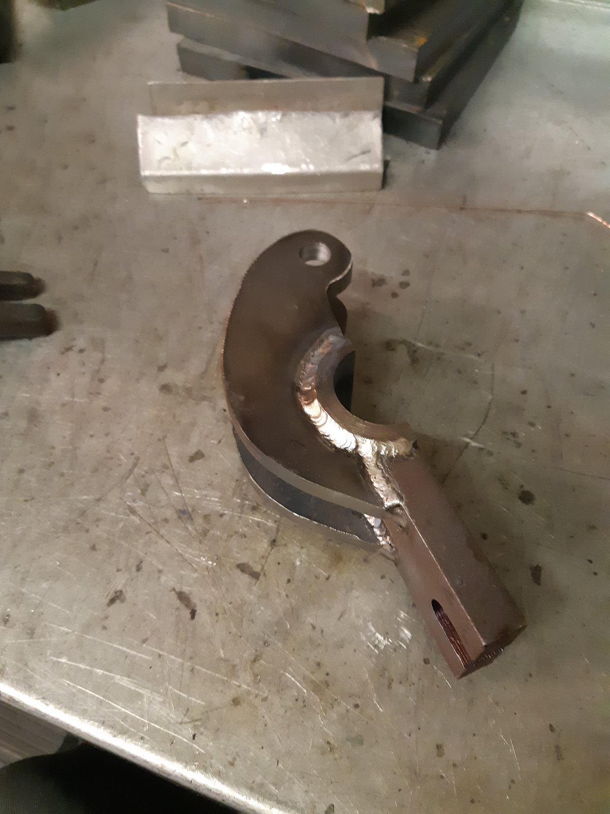

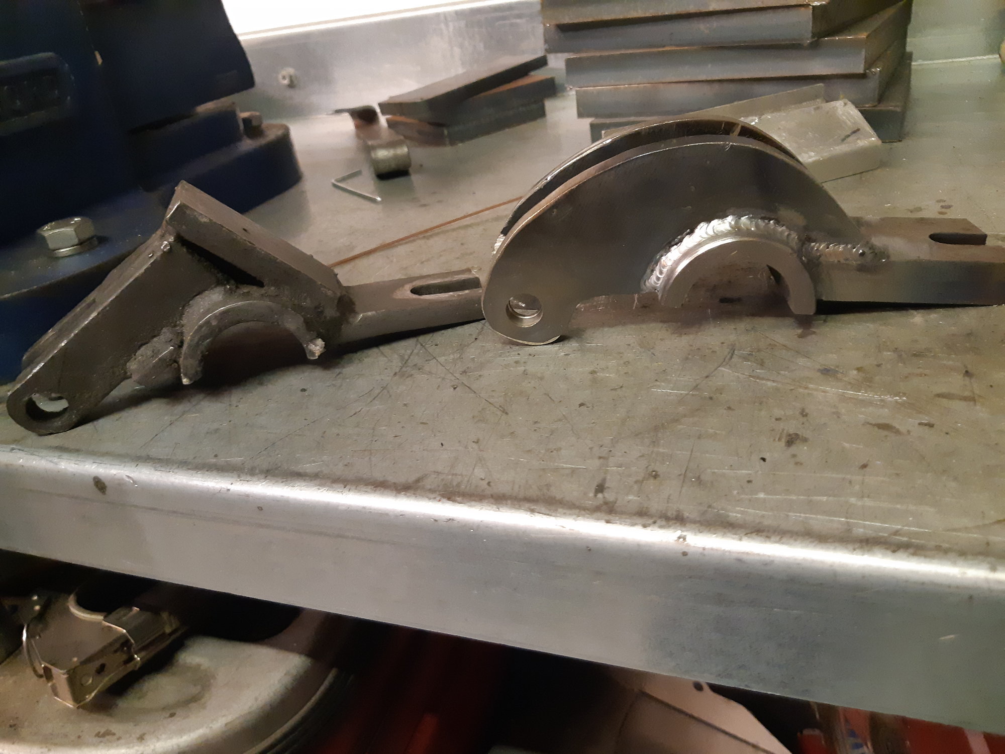

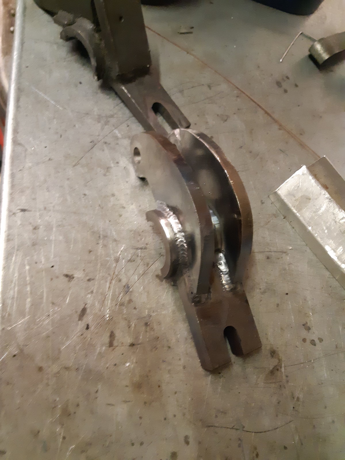

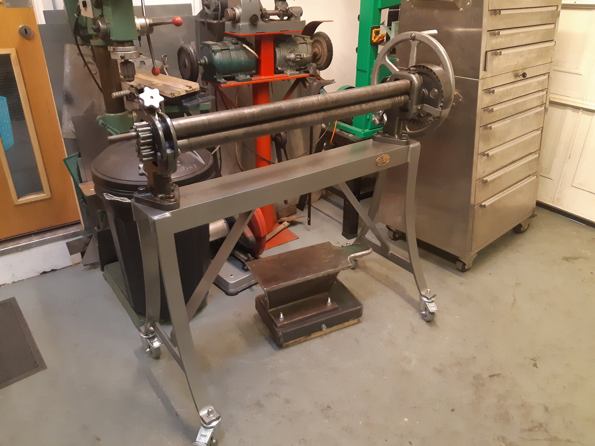

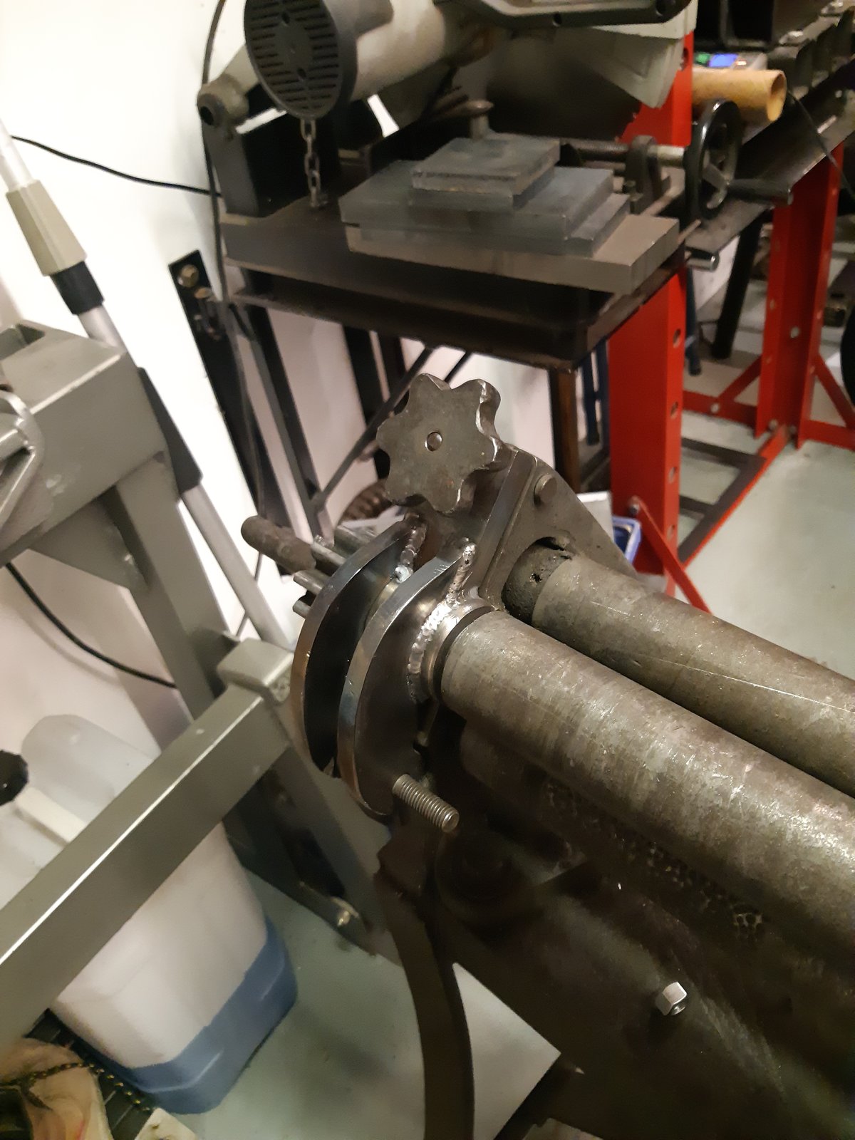

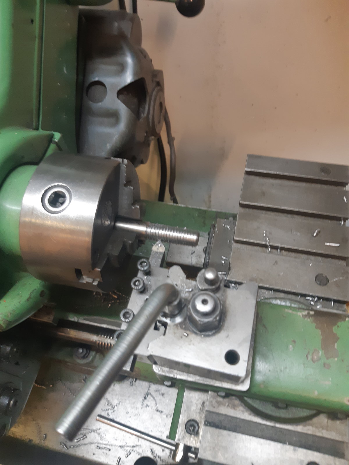

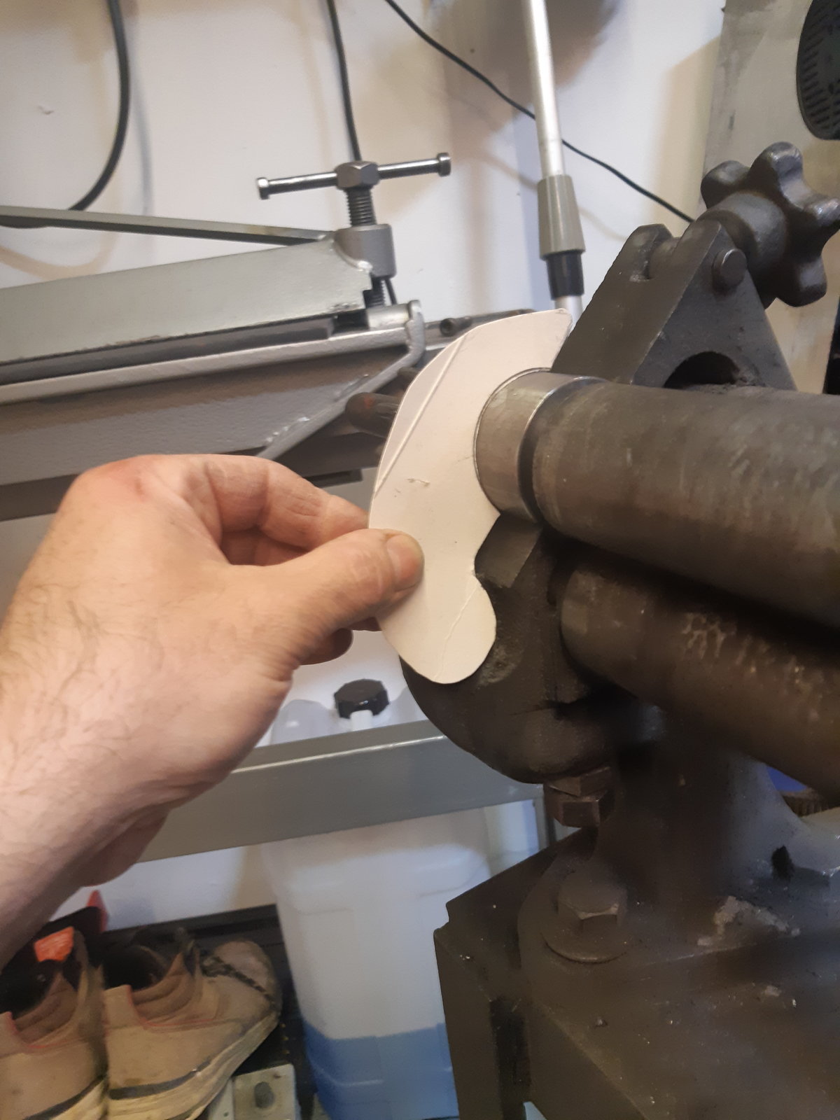

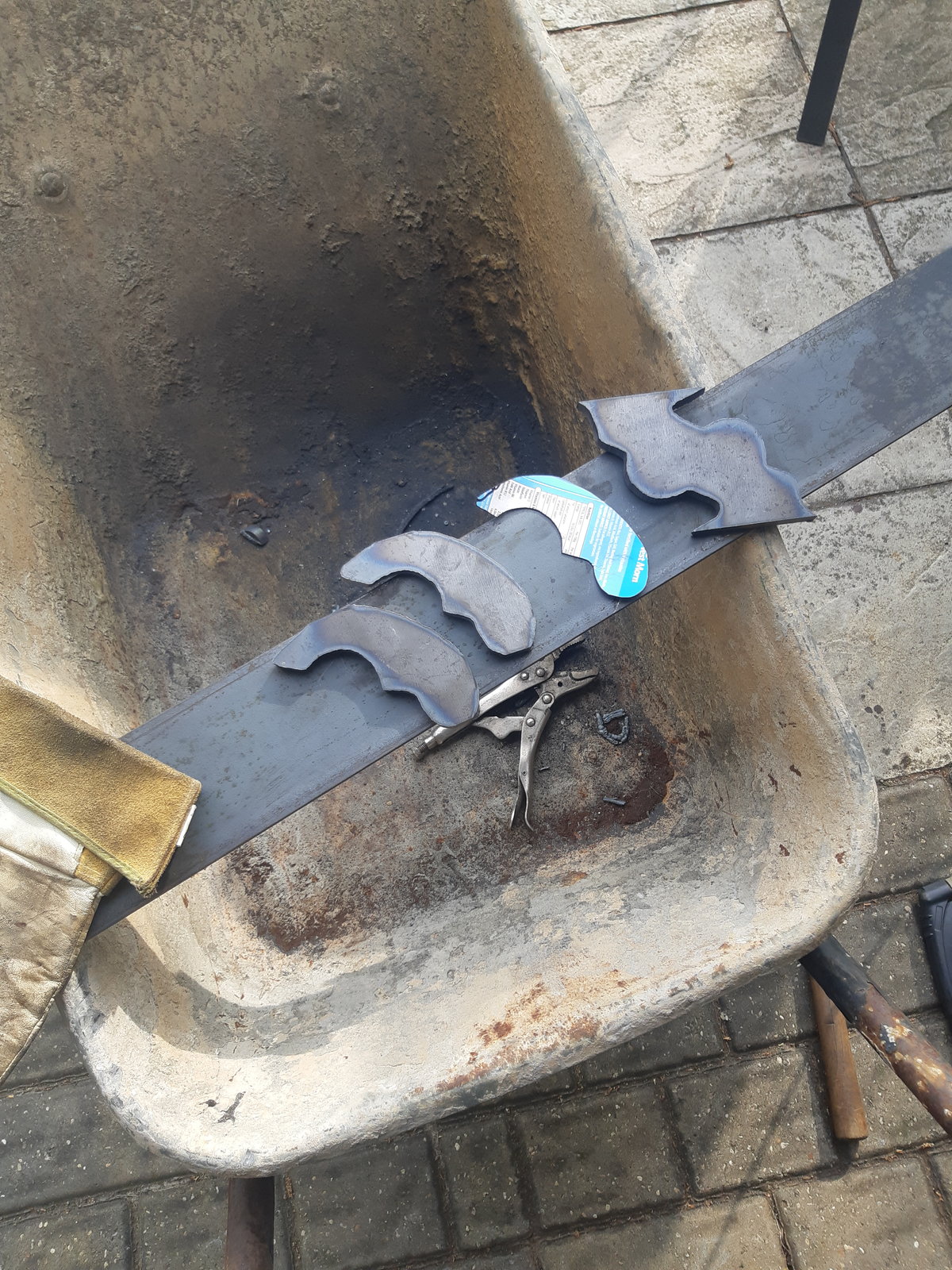

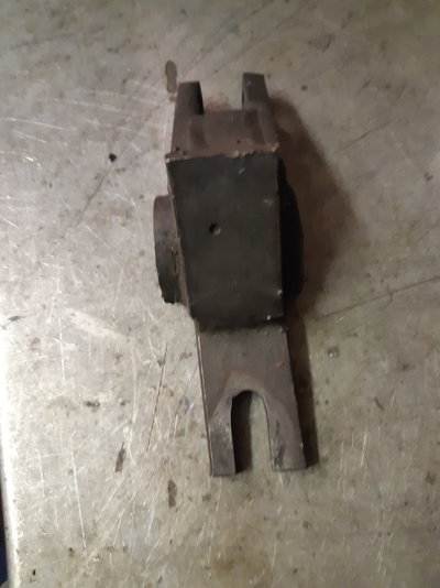

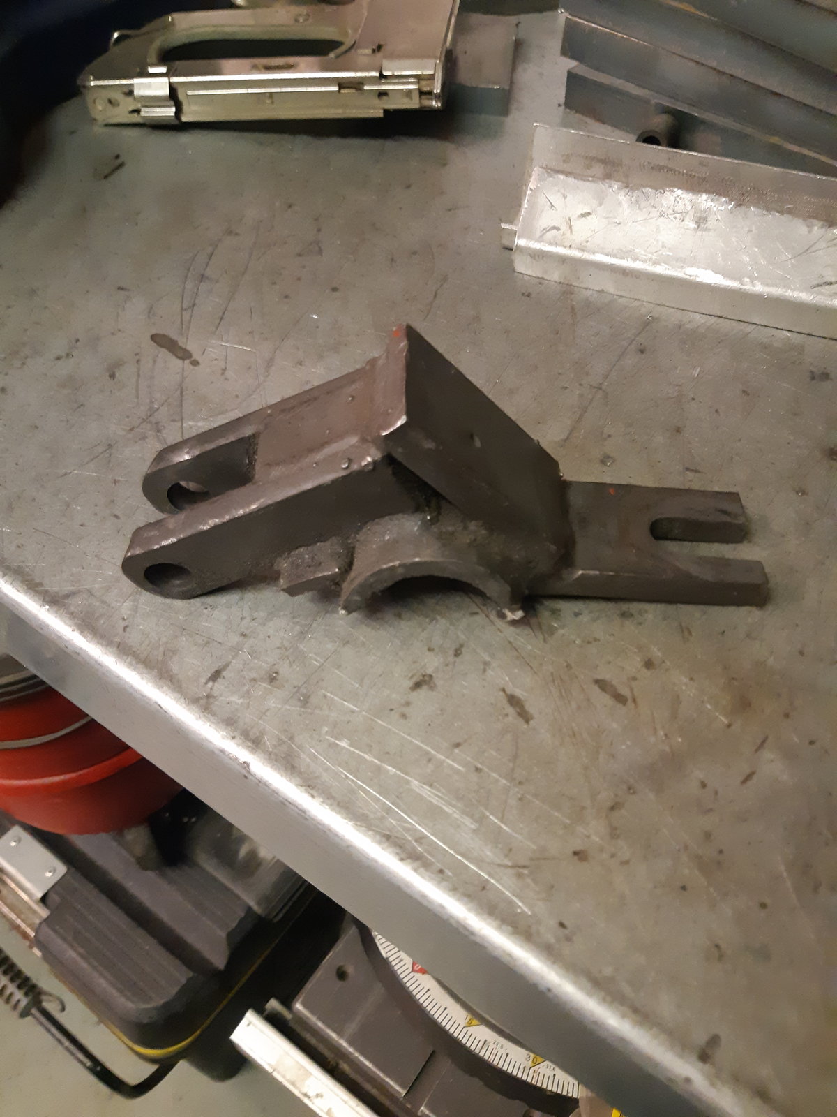

One of the first Jobs is to replace the clamp for the end of the removable roller. It must have broken in the past and someone has made a dogs dinner out of bits to replace it.

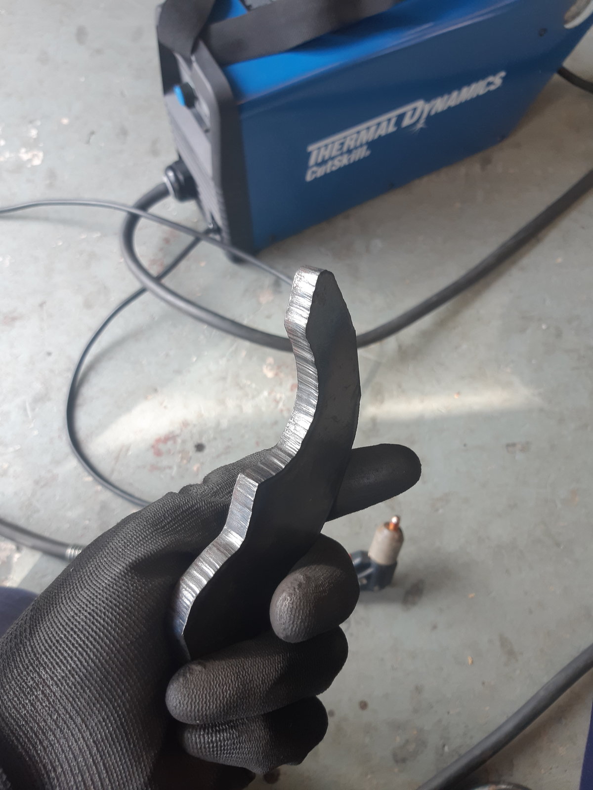

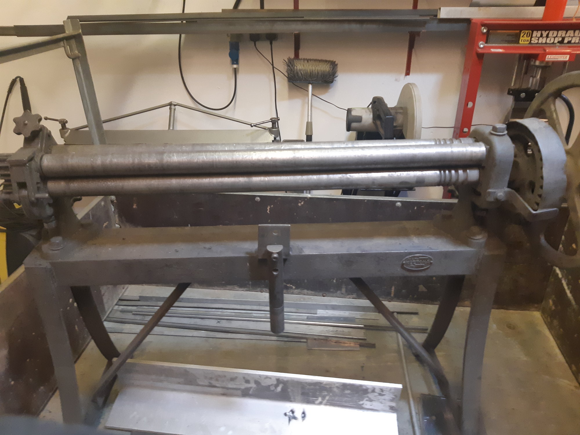

Yep it's a nice little machine. Like any tool though you get what you pay for. It's not as much as a Hypertherm but the next one down in price at the time I bought it.

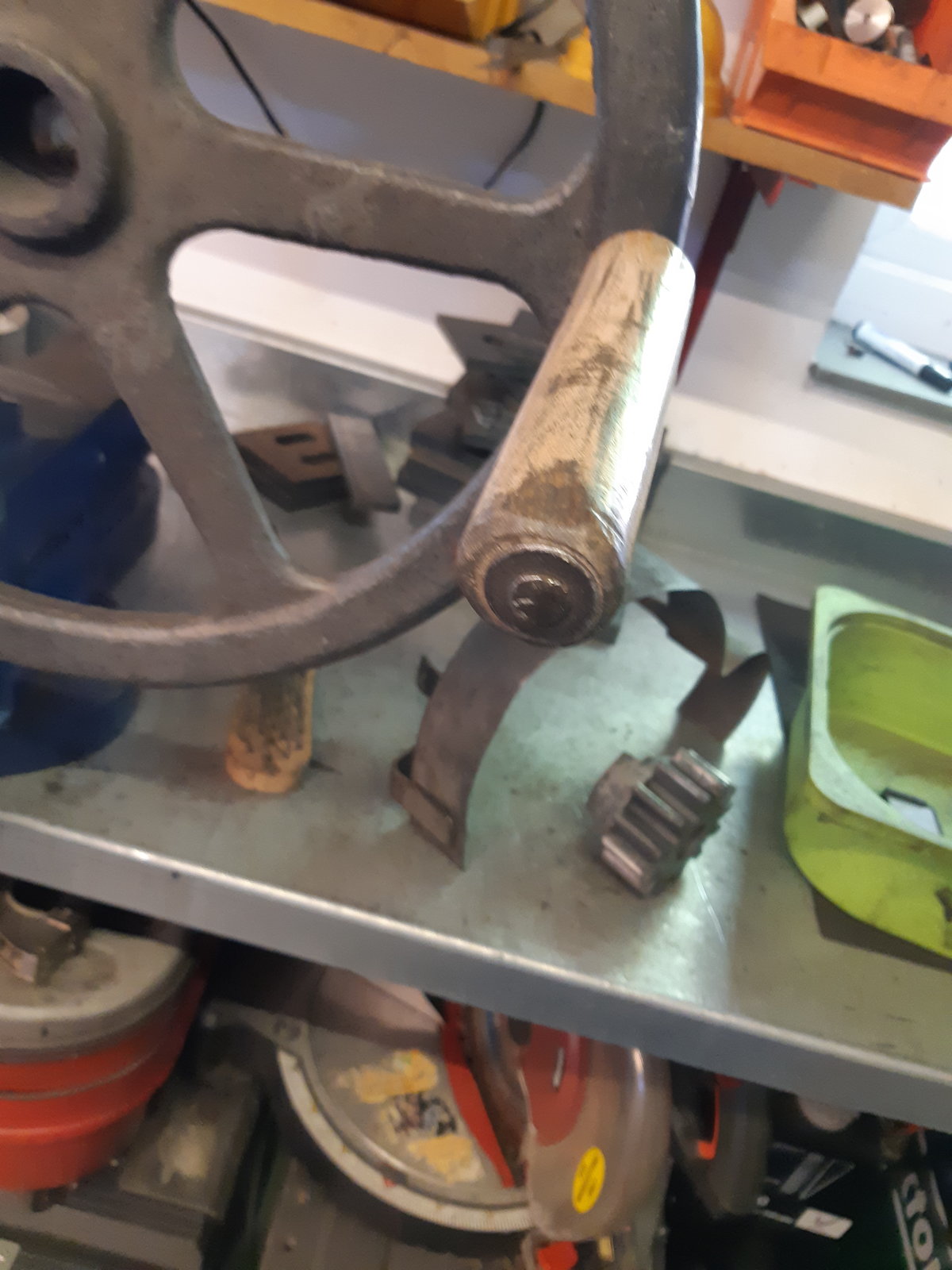

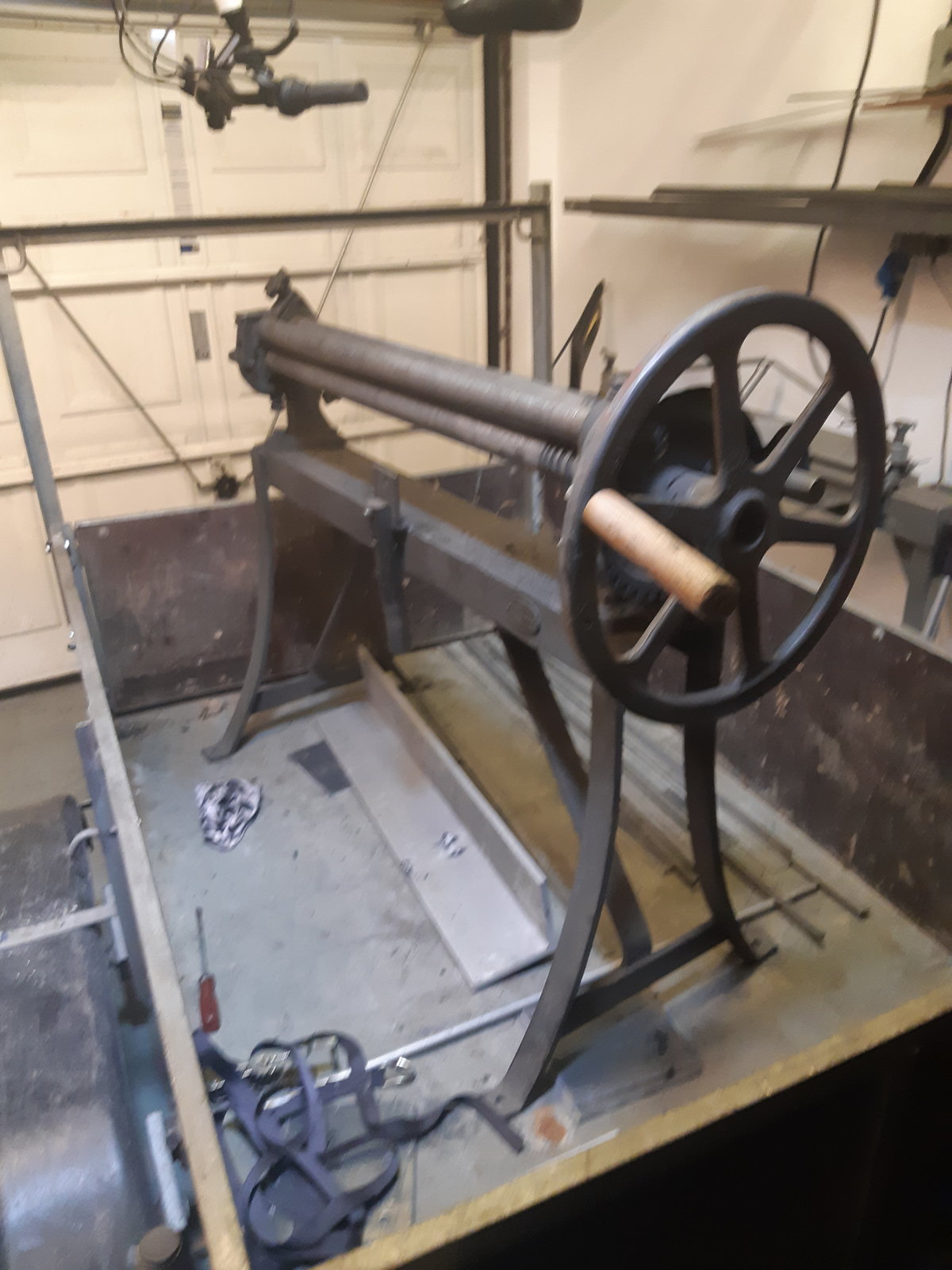

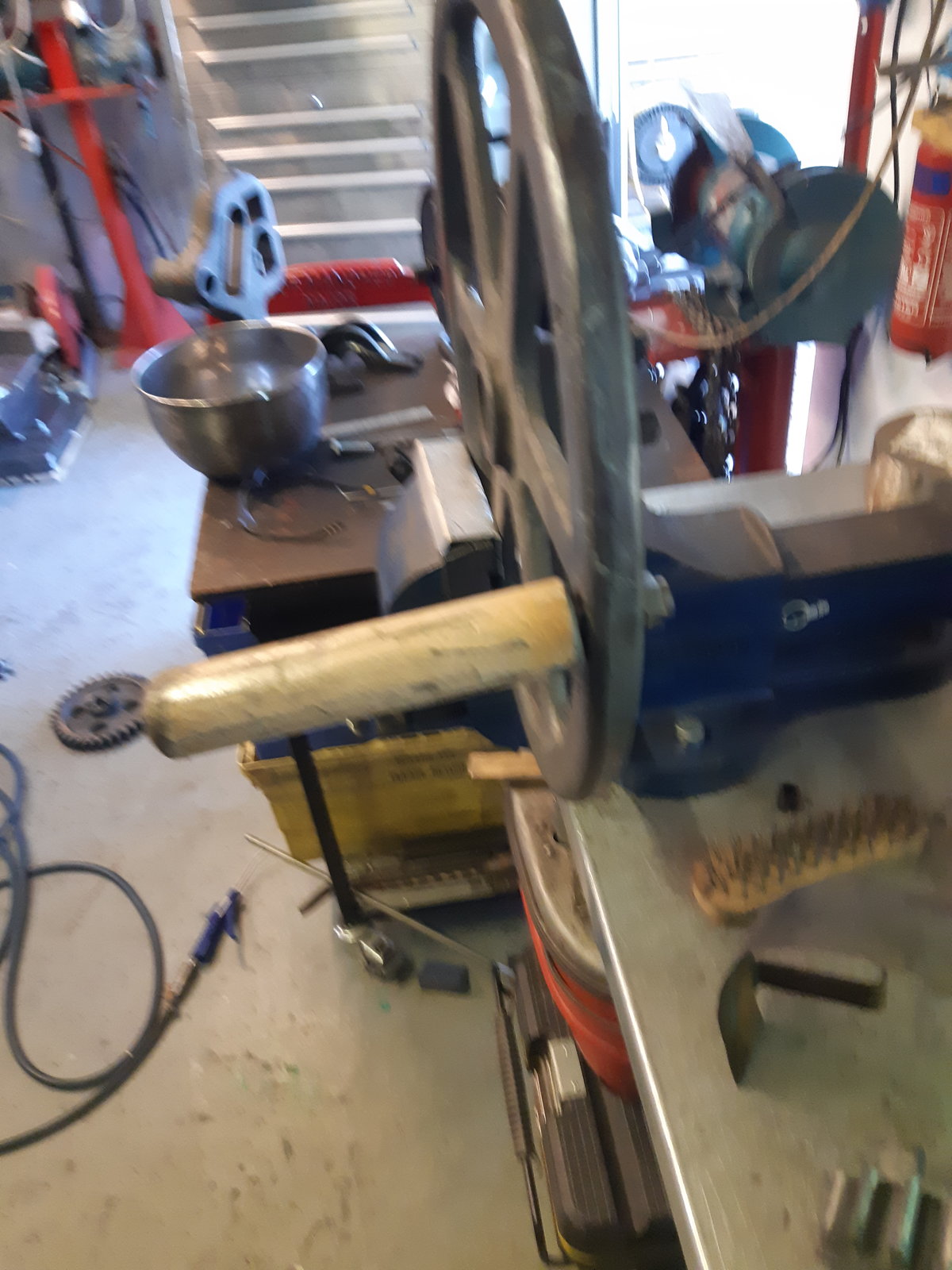

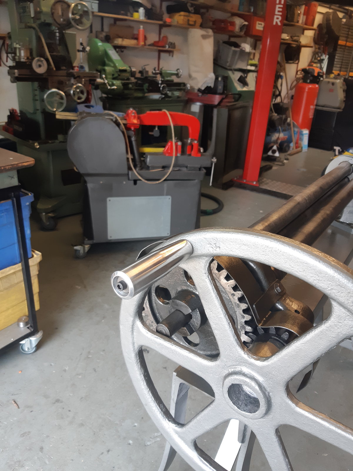

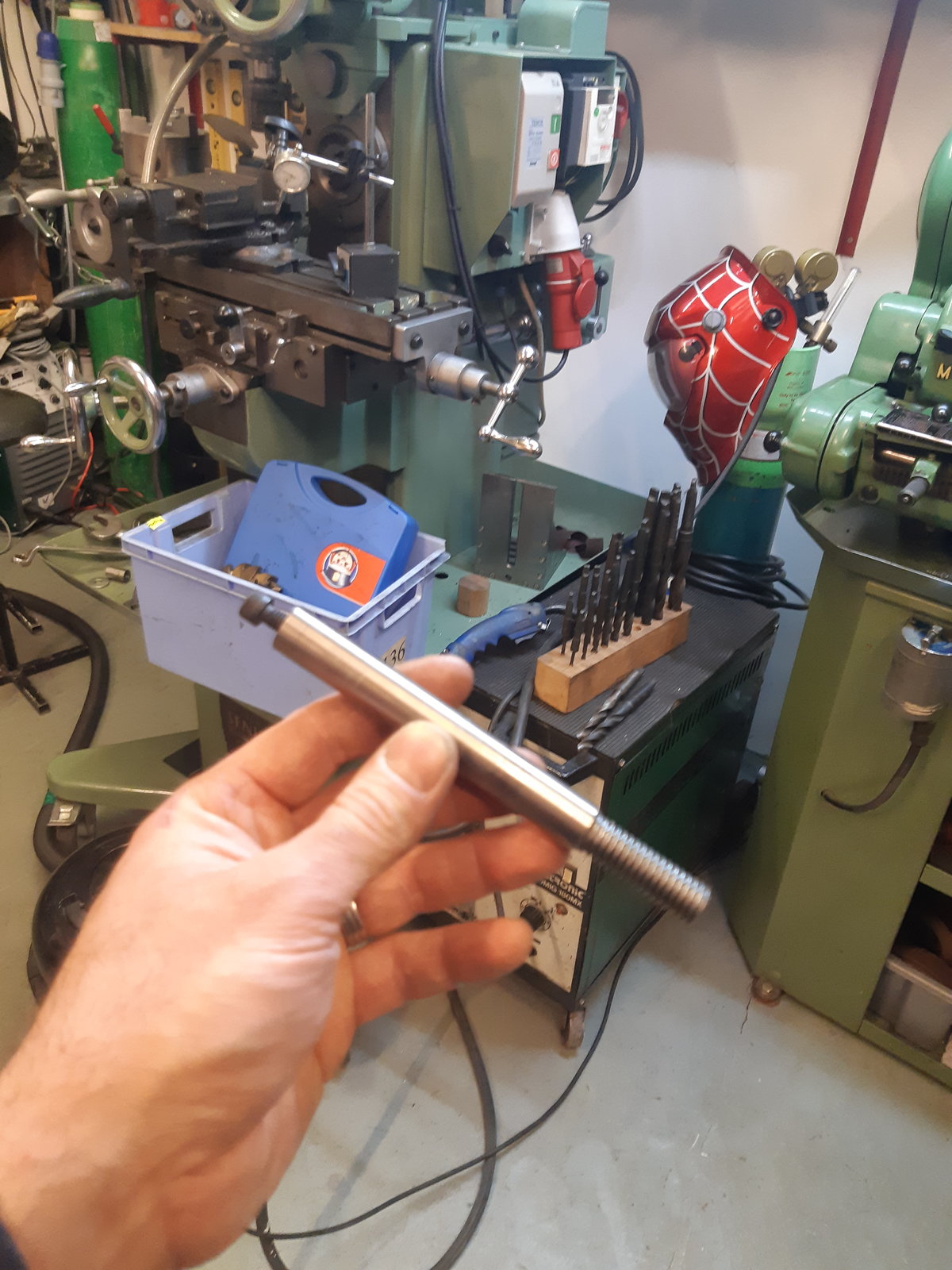

Next job is to sort out the other dogs dinner on the cranking handle.
The original must have broken off and someone has attempted to replace with a wrong size piece of thread bar and a brook handle drilled on the p155
