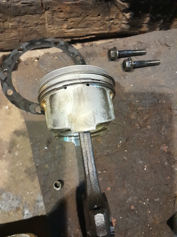

yea been run dry and then filled up with fresh oil after it had siezed
Any requirement for driver to do a daily check , to late for riot act and warnings.
The 15 min spent checking oil water and tires ETC, and signing the log booking is cheap insurance

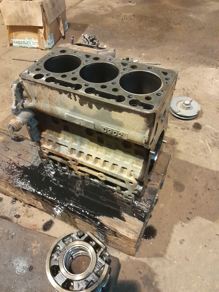

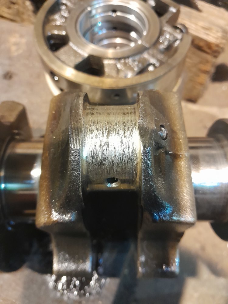

I had a crank re-welded and ground.The crank is scrap 10 thou of wear/damage and 7 thou bend in it. The repair bill is increasing rapidly.
There are some good 3 cylinder Kubota engines in the yard, I will check to see if any of them are D902's
