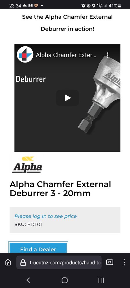

Cheers....I knew it would be extra but that's sure a big brother price...I have a Laser tools one for up to 19mm, you need it's big brother
The way it's looking a collet chuck on the lathe would be cheaper short term..
Thanks anyway.

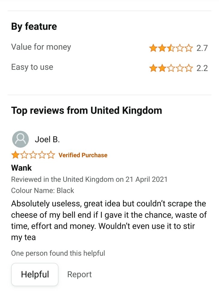

It was a very accurate review thoughquality review

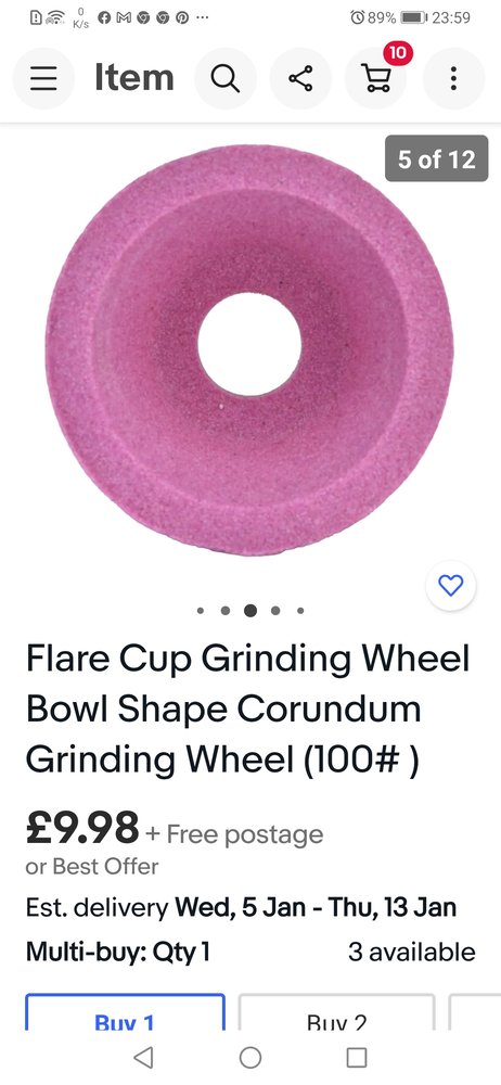

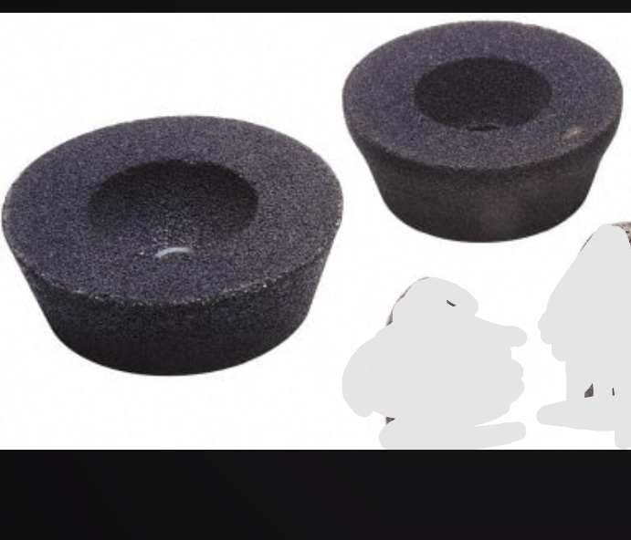

They're for tool and cutter grinders and you grind on the front face of the cup, trying to use the inside would be akin to grinding on the side of a bench grinder wheel.Found something. BUT it's 4 inch and they all seem a similar size.
Called a flaring wheel.View attachment 322968
Can't see any prices or where to buy them.You want one from Marwa

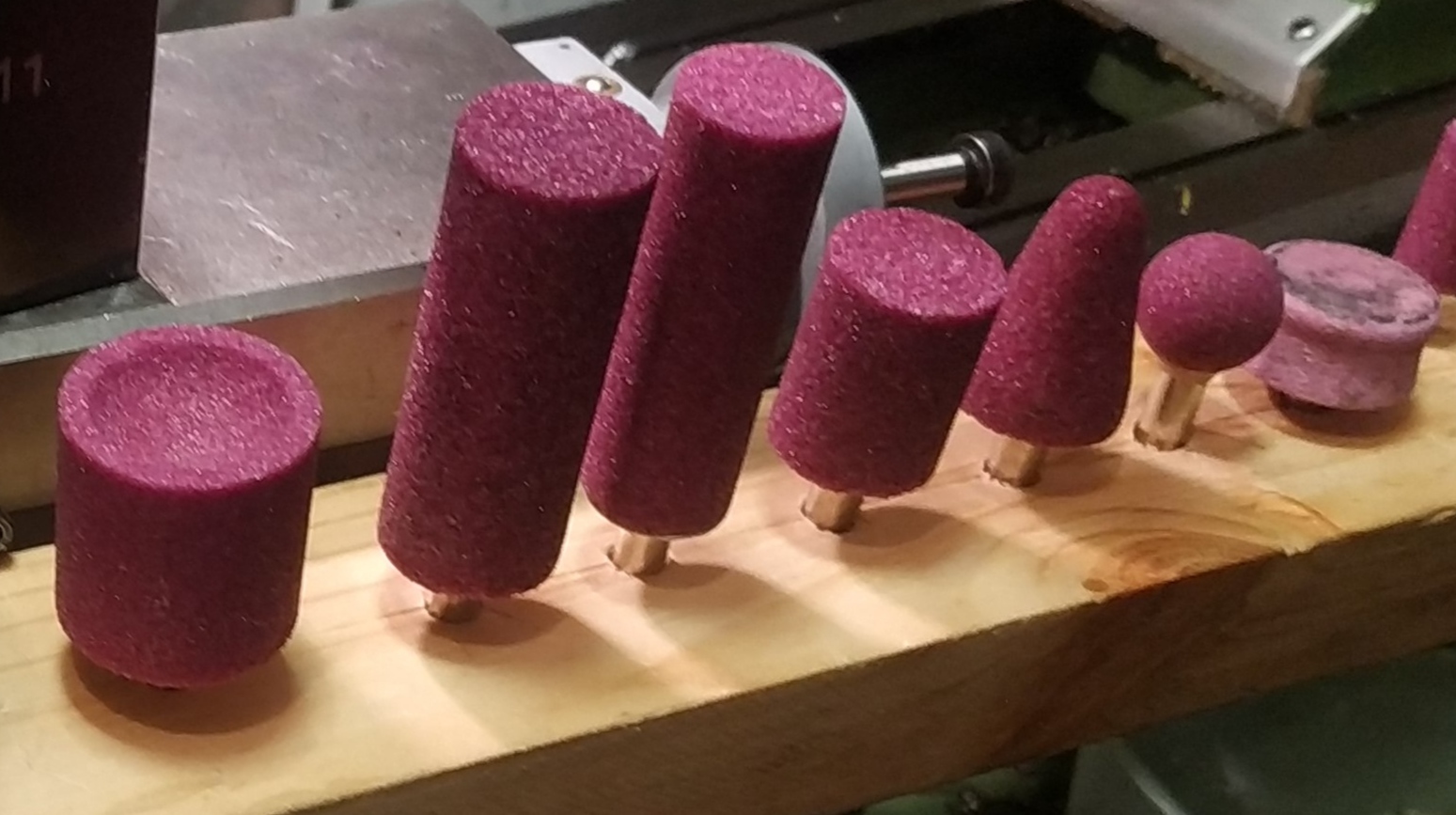

I will grab a few of those if the diameter is well over 20mm.You can buy die grinder stones with a concave ball end. I got a coarse one from zoro a few weeks back, bit too coarse for this. The worn, pink stone on the right is much finer, you could dress any die grinder stone with a diamond point.
Cut type would be a useful thing to have, so Im planning to make a smaller one with a 30 degree chamfer to match the thread angle. I use a SDNCN tool in lathe works well, plus square needle file as the last half turn is always burred - no nice way to prevent that.

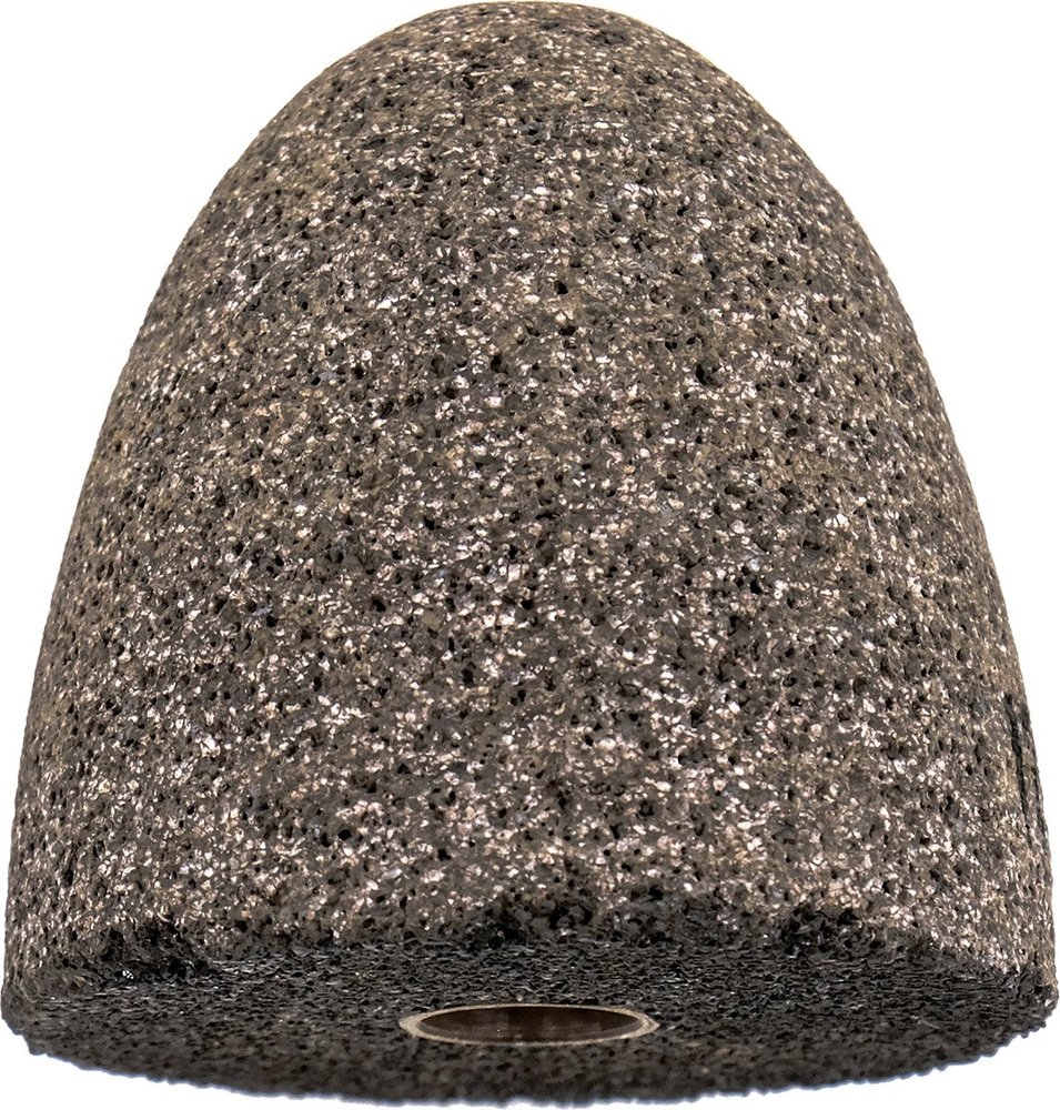

Kennedy A38 Mounted Point A38 | at Zoro
Kennedy - A38 Mounted Point available at Zoro.co.uk - UK's Leading Supplier of DIY Tools and Supplies'www.zoro.co.uk
Kennedy W230 Mounted Point KEN2502300K | at Zoro
Kennedy - W230 Mounted Point available at Zoro.co.uk - UK's Leading Supplier of DIY Tools and Supplies'www.zoro.co.uk
