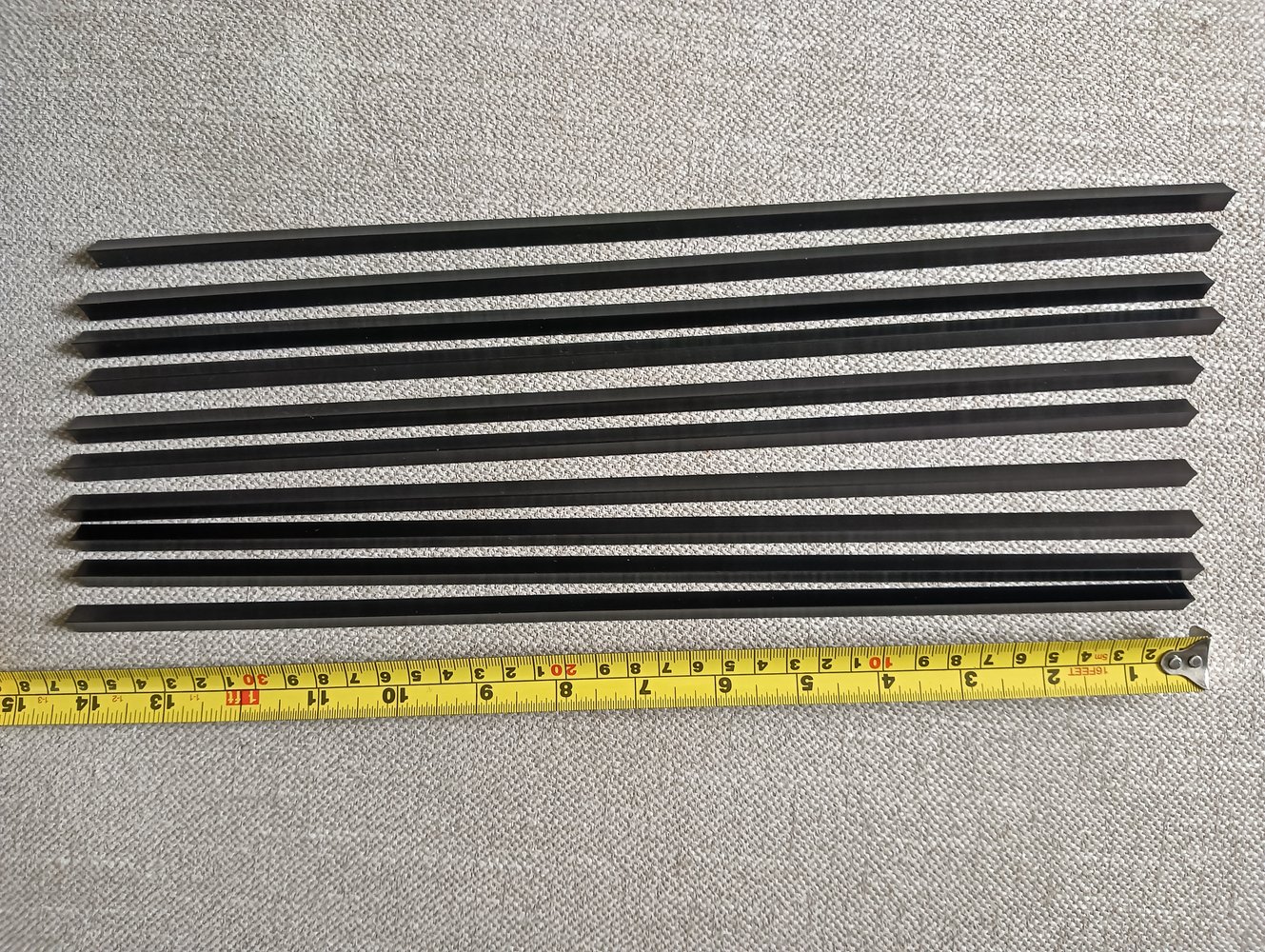

My laser (Co2 used for wood & acrylic etc) is fitted with the standard honey comb aluminium bed, I dont like these as smoke tends to be retained in sections of the cells & is a fire risk.
School i used to work at had a lotus laser systems machine that had a bed consisting of knife edge alloy slats, It was far superior & the removeable slats were dead easy to clean with perfect extraction.
I have approached Lotus & they will not supply the slat bed or parts on its own, Pity as they are just a few miles away & i know it can be made to fit easily!
Slats were an aluminium extrusion approx 15mm high x 3mm thick with both sides being relieved so the top had a 1mm radiused knife edge.
I could mill the angle but doing 25 bed bars 400mm long is going to take me poxy weeks on a manual milling machine.
Anyone know where i can get such a thing or the extrusion?
