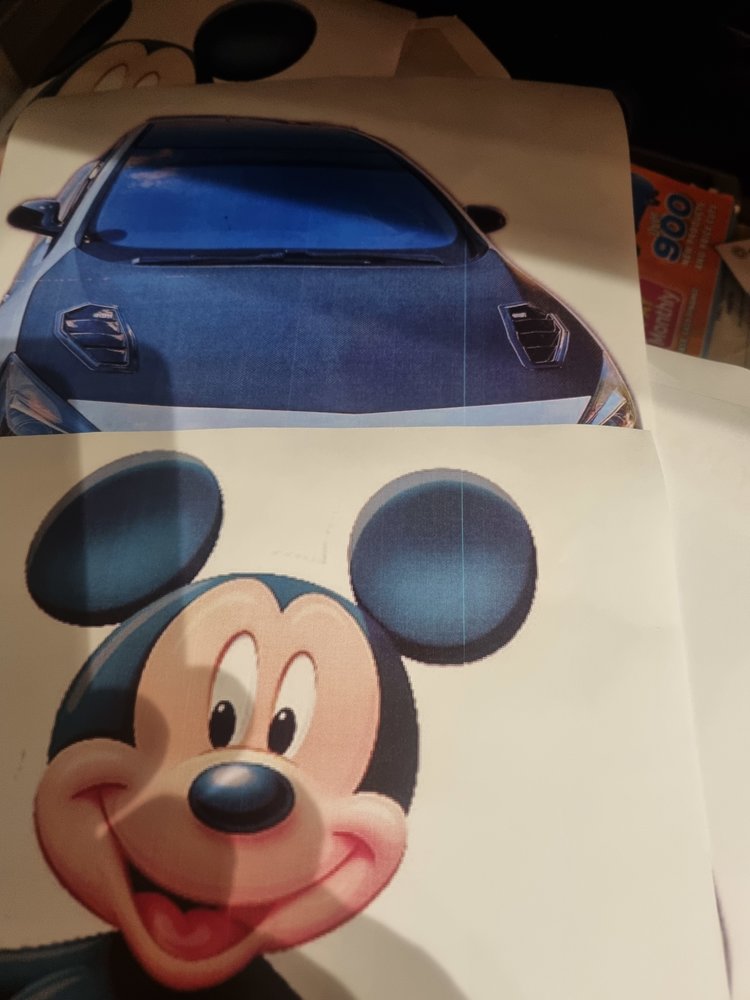

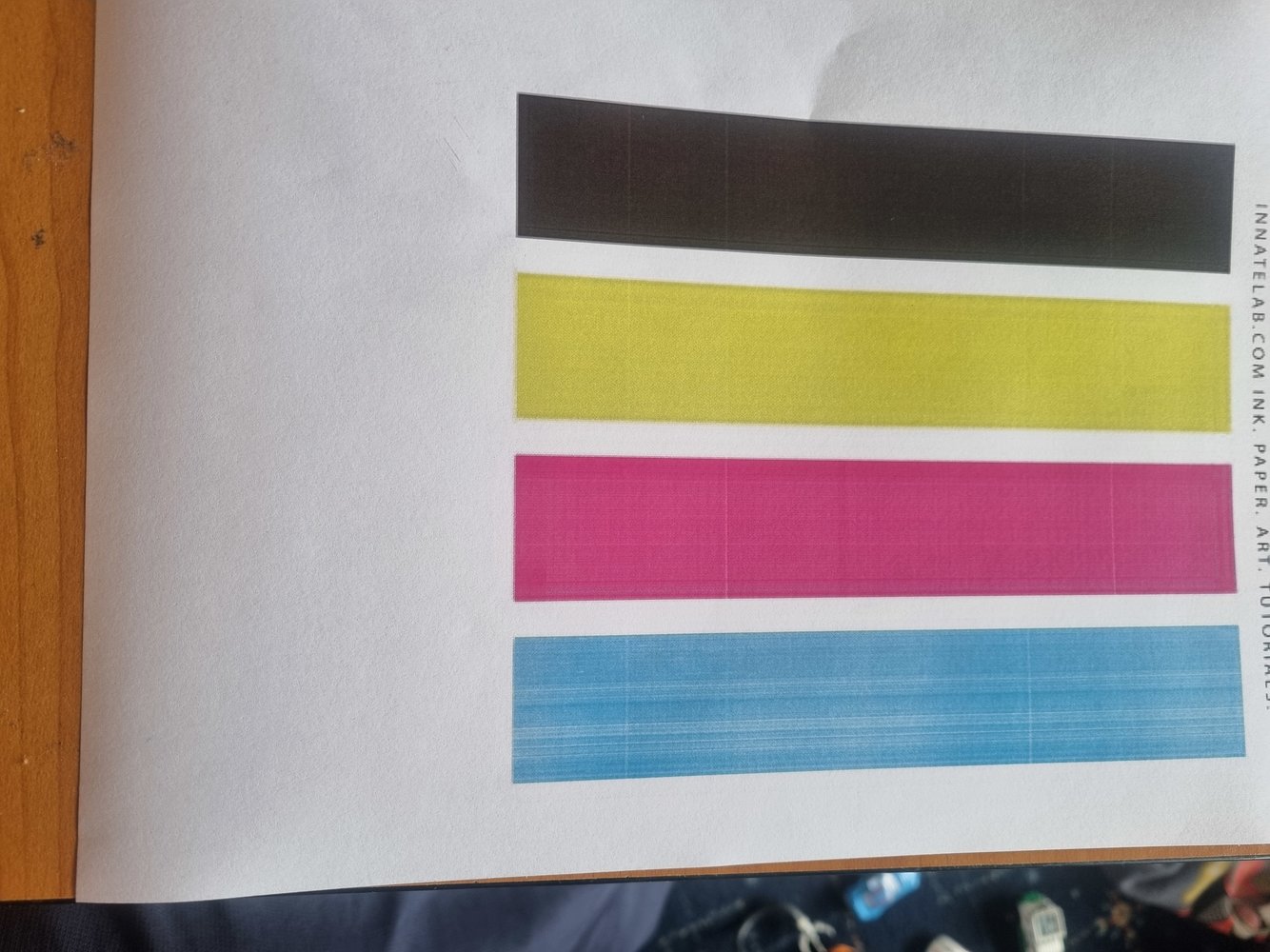

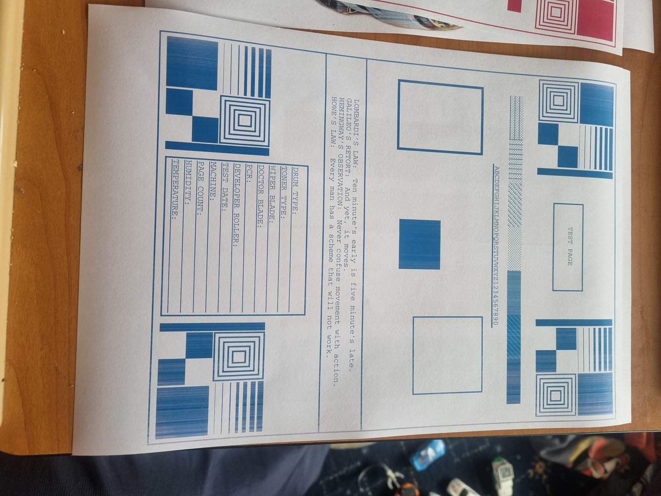

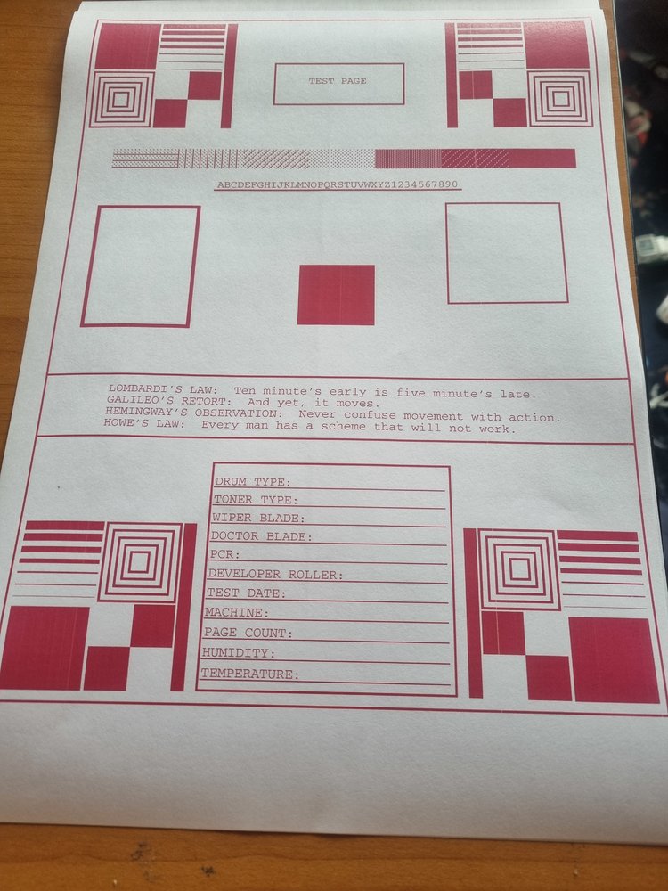

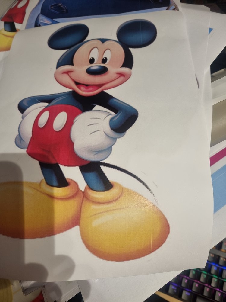

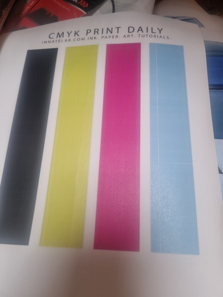

It was about 6 years ago since I left the industry. The feint line in the cyan can be either lack of toner concentration at one end of the developing roller, dirty primary charge roller or the laser optics need cleaning or all of the above.Does many moons mean well over 10 years?

Sadly my supplier no longer in business for toners so I tried a new place. But it's not printed well since I fitted a new magenta toner. Followed by a new cyan drum. Then I was sent another cyan drum but the printer now seems to have a mind of it's own. View attachment 463833View attachment 463834View attachment 463835
This was the first cyan drum they sent me.

Laser optics I have never seen those. LolIt was about 6 years ago since I left the industry. The feint line in the cyan can be either lack of toner concentration at one end of the developing roller, dirty primary charge roller or the laser optics need cleaning or all of the above.
