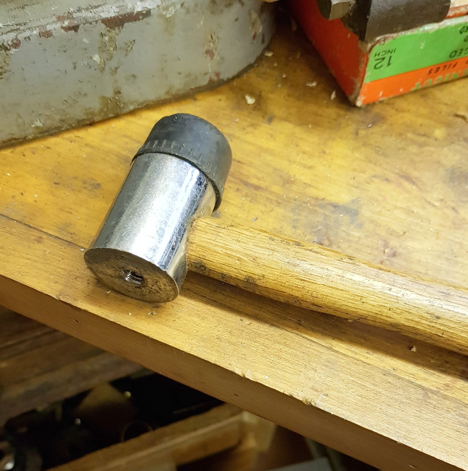

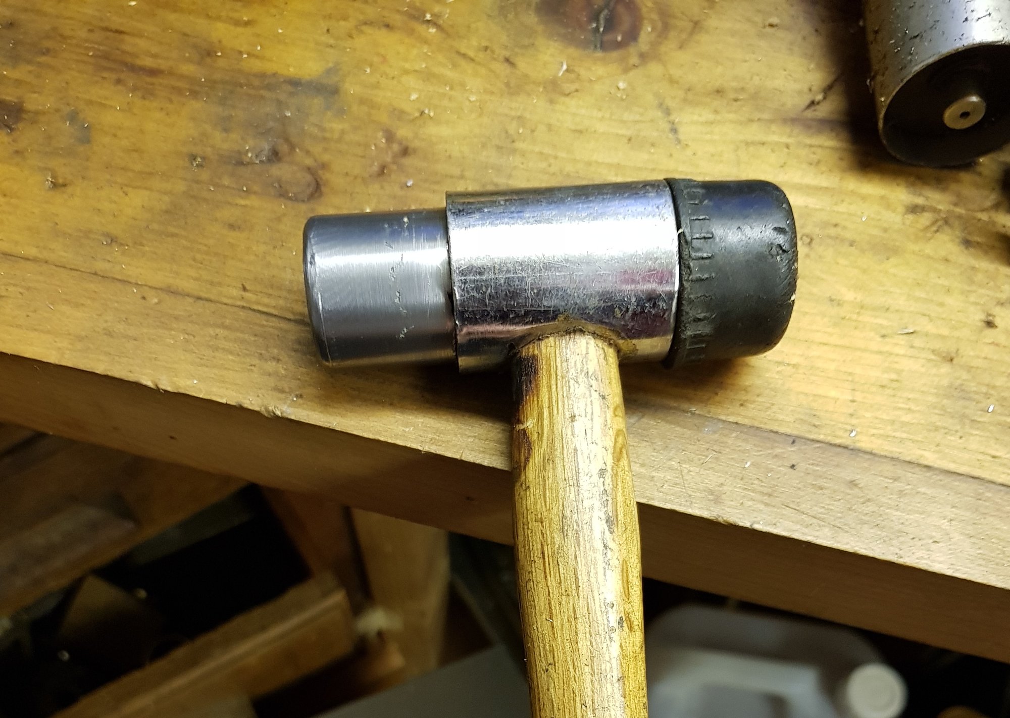

I picked up this little soft-faced knocking-stick sometime in the past, I would expect for peanuts, but then it was missing an insert.
It was an addition to my 'Round Tuit' pile. Well, yesterday I decided to do something about it.
I don't have a lead faced mallet, so it seemed like the perfect opportunity to make one.
The hole is threaded 8mm, so finding a bolt and trimming it to length, was no problem.

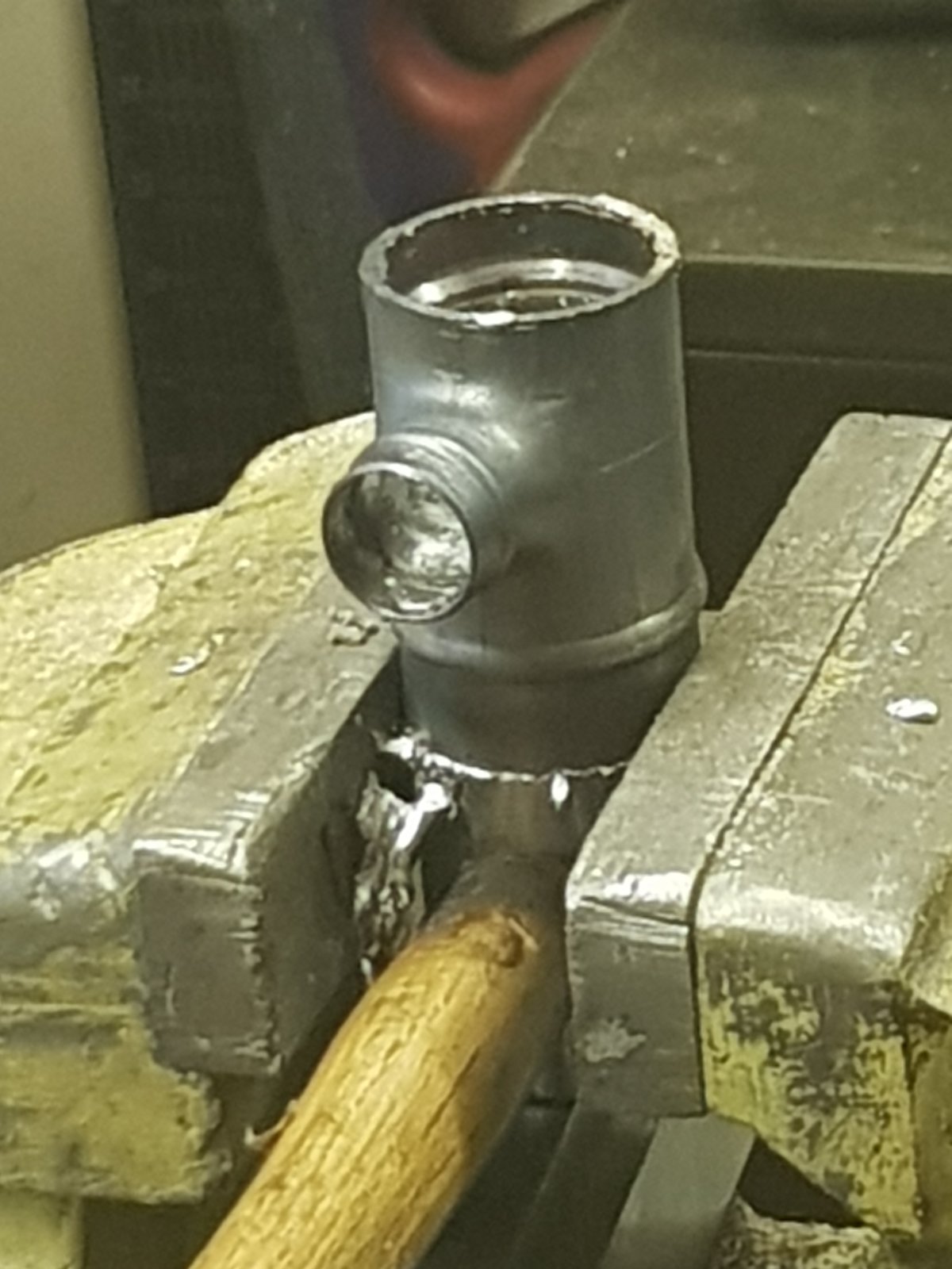

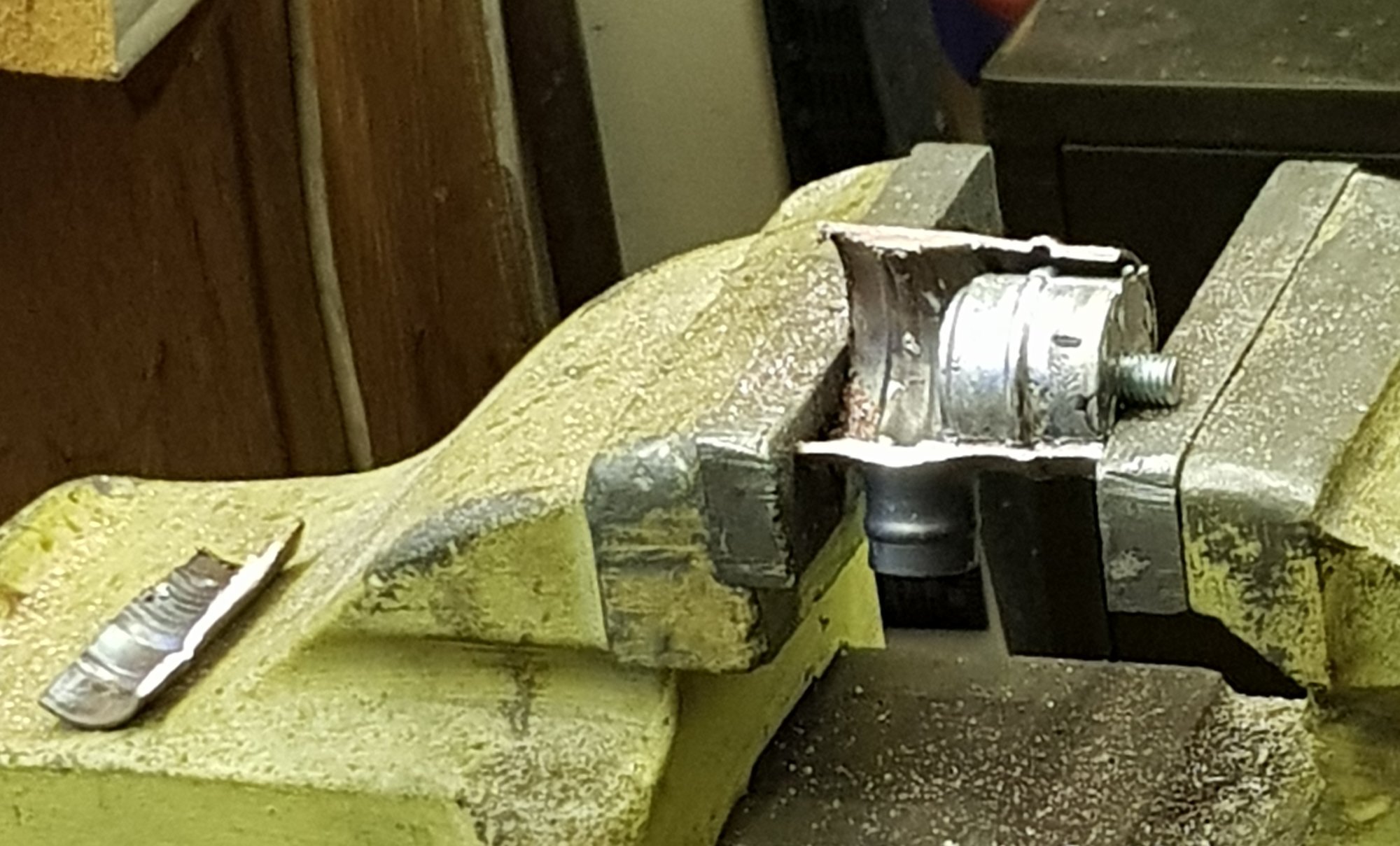

Now how to cast the head?

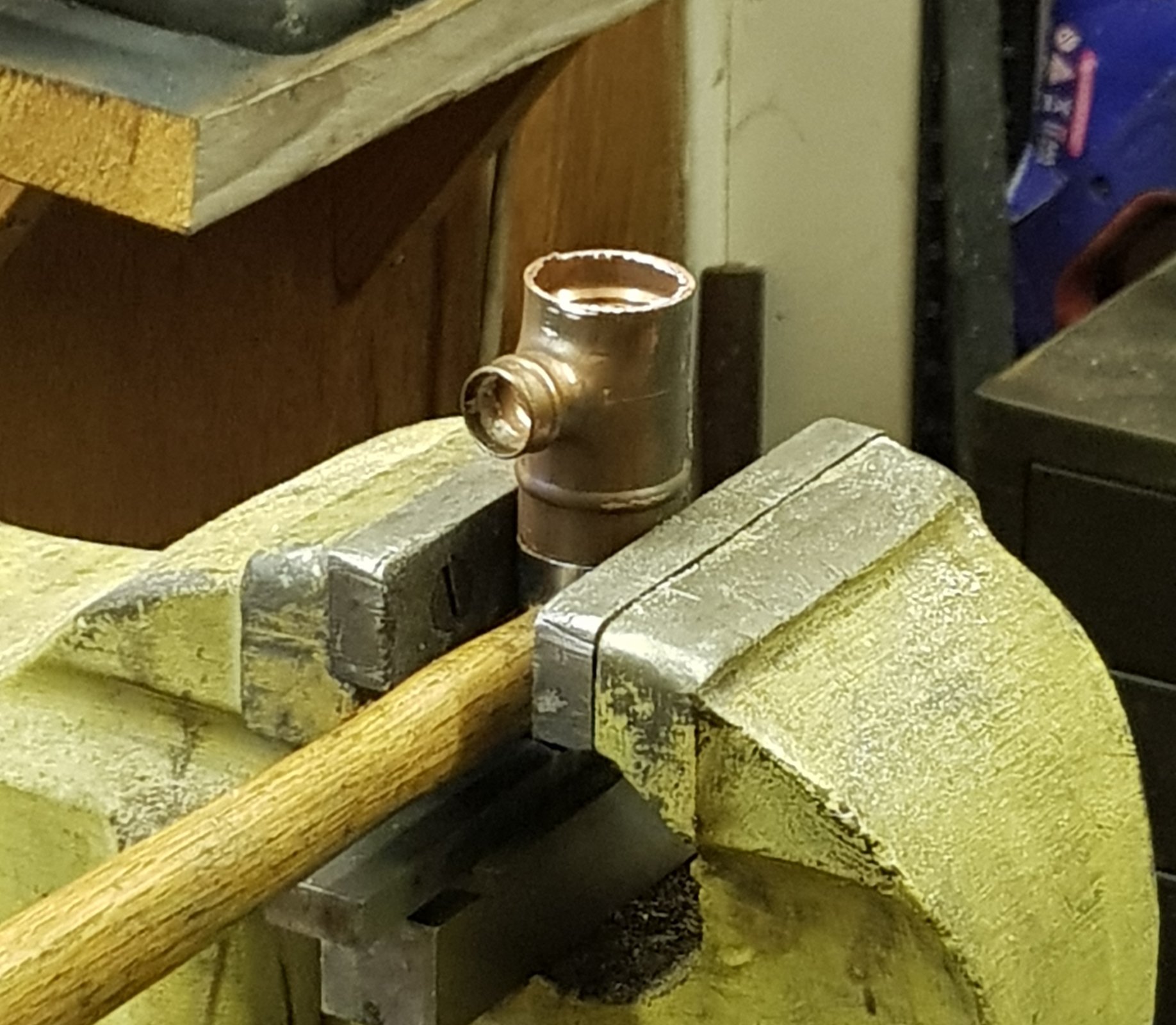

Sitting on my workbench was a 28mm x15mm reducing Tee that I'd cut a piece from for some other purpose, that was about the right diameter. Okay, it was smaller than I'd like but this is just an experiment.
Support everything in the vice on parallels and lightly clamp it up.

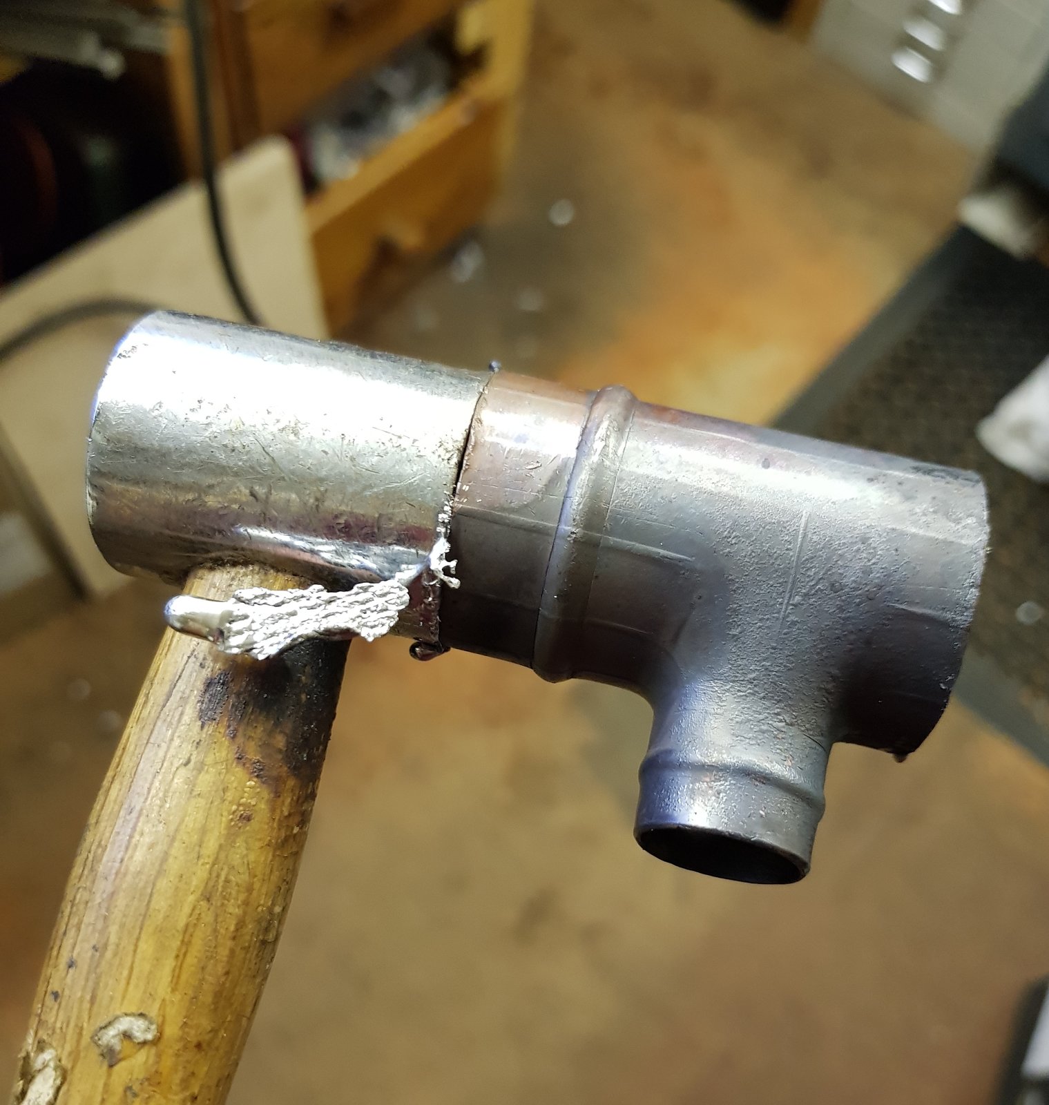

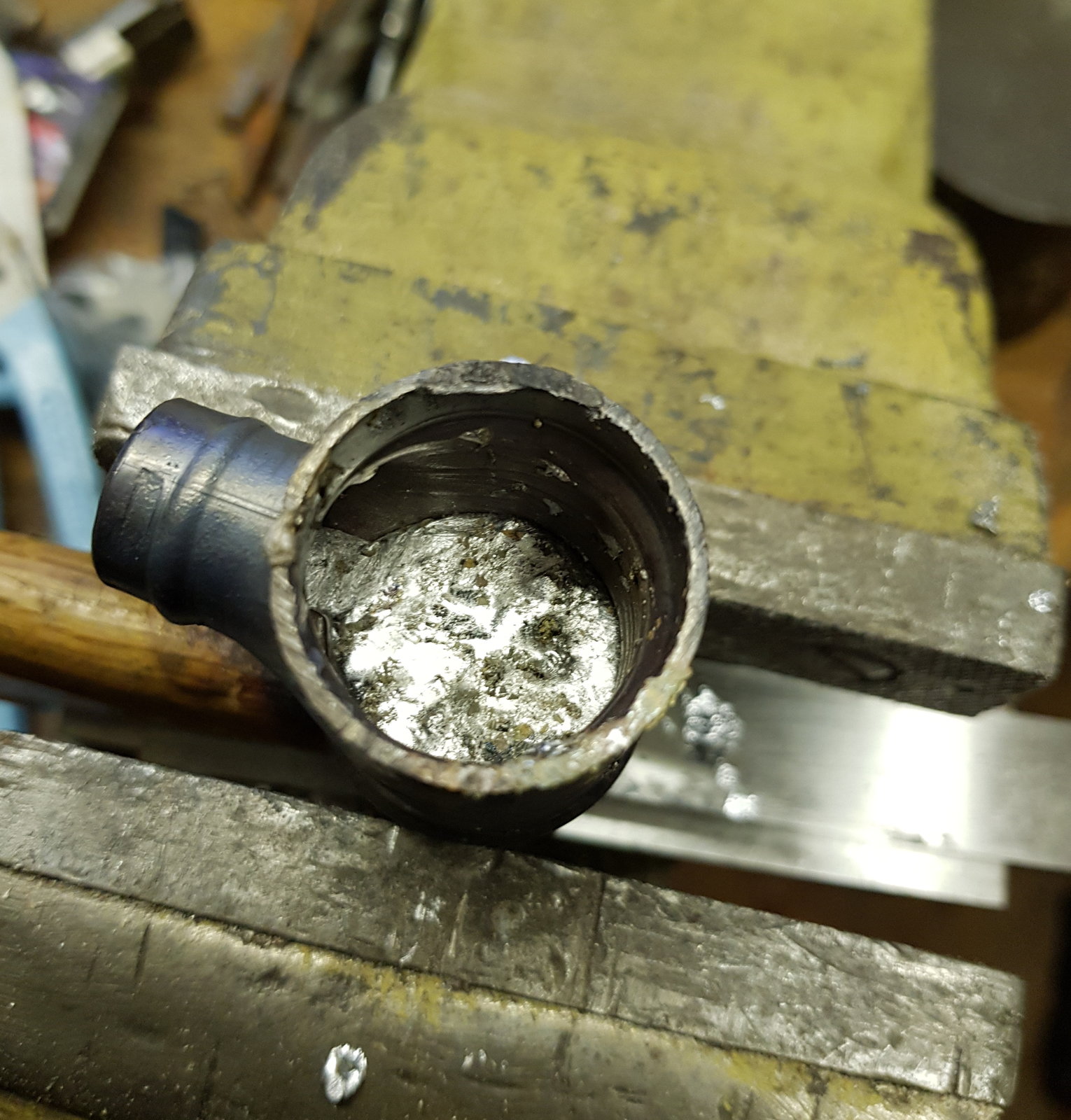

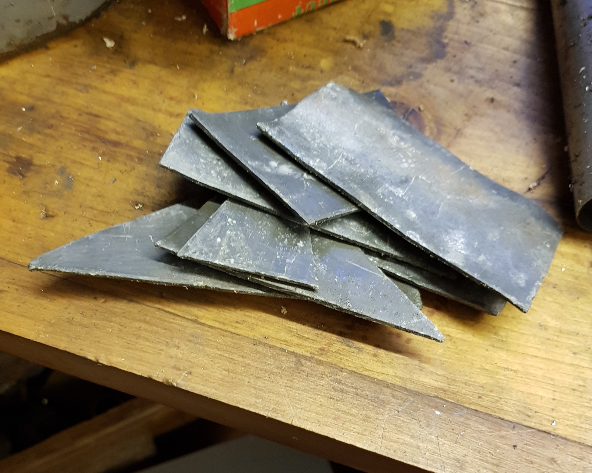

I knew the trimmings from the lead flashing project from 7 or 8 years ago would come in handy, they did!
Now it's just a case of filling and heating until the excess runs out of the Tee.

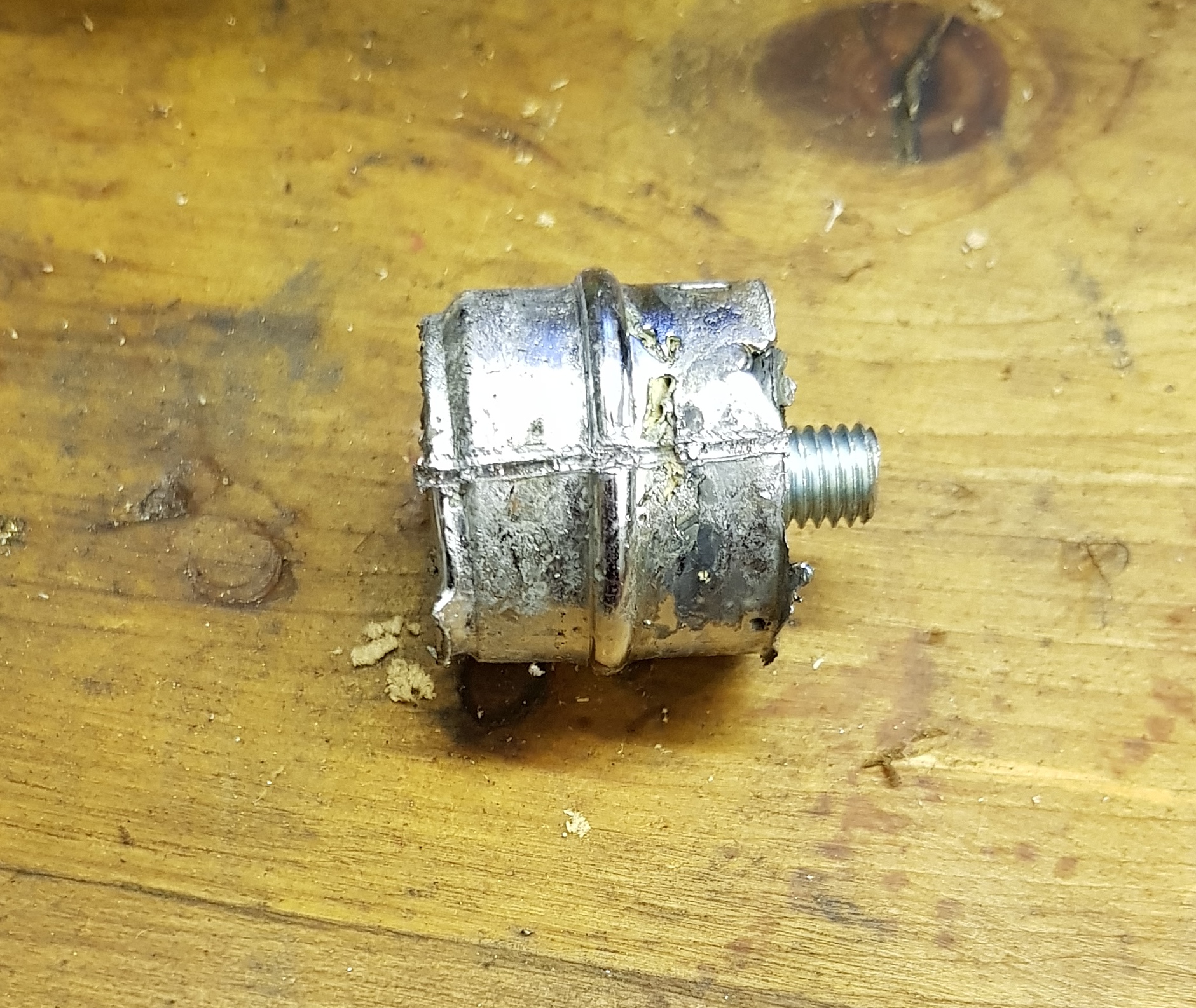

Jobs a good'un. The finished article...
Just kidding
Cut the copper fitting and prise off, which i thought was surprisingly easy for a Yorkshire fitting, but I guess the overheating had oxidised the copper at the copper-solder junction and it came off cleanly.
